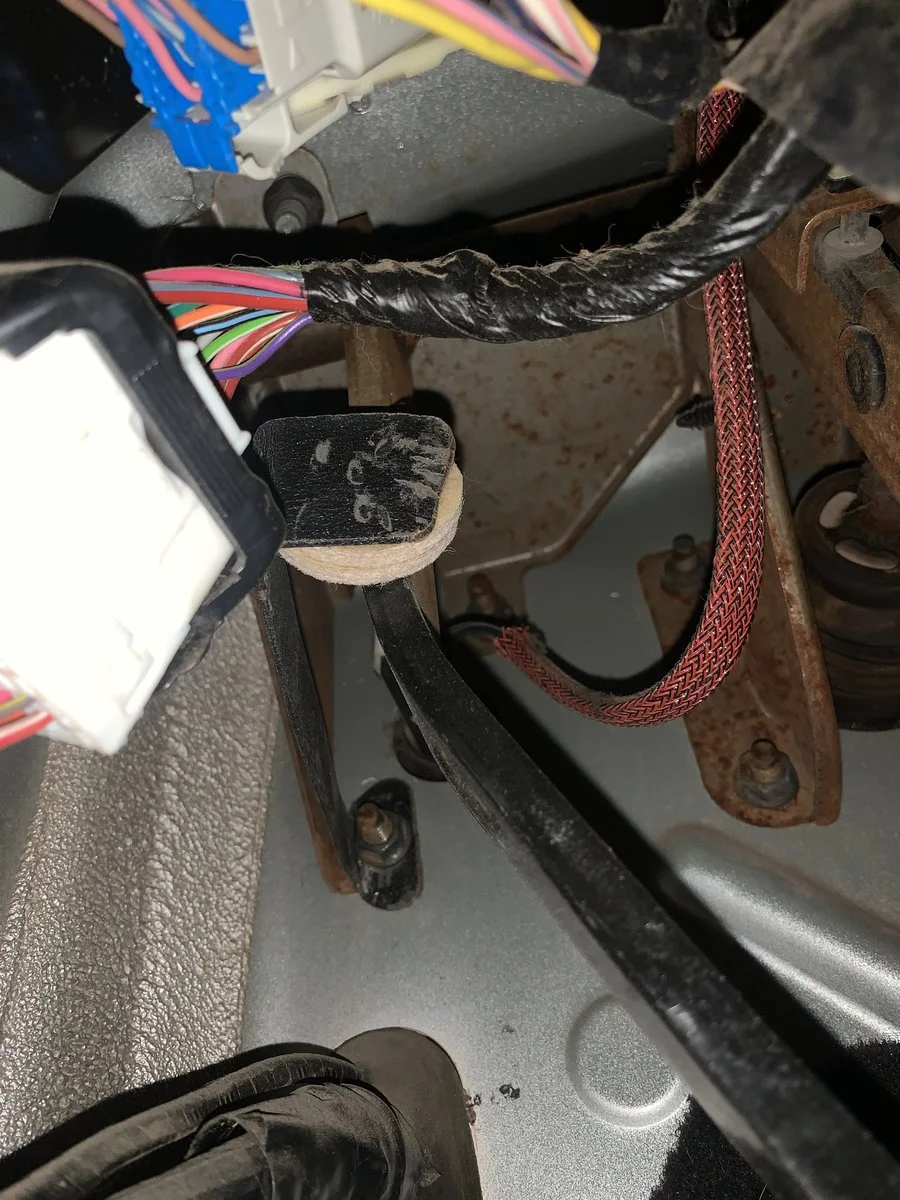

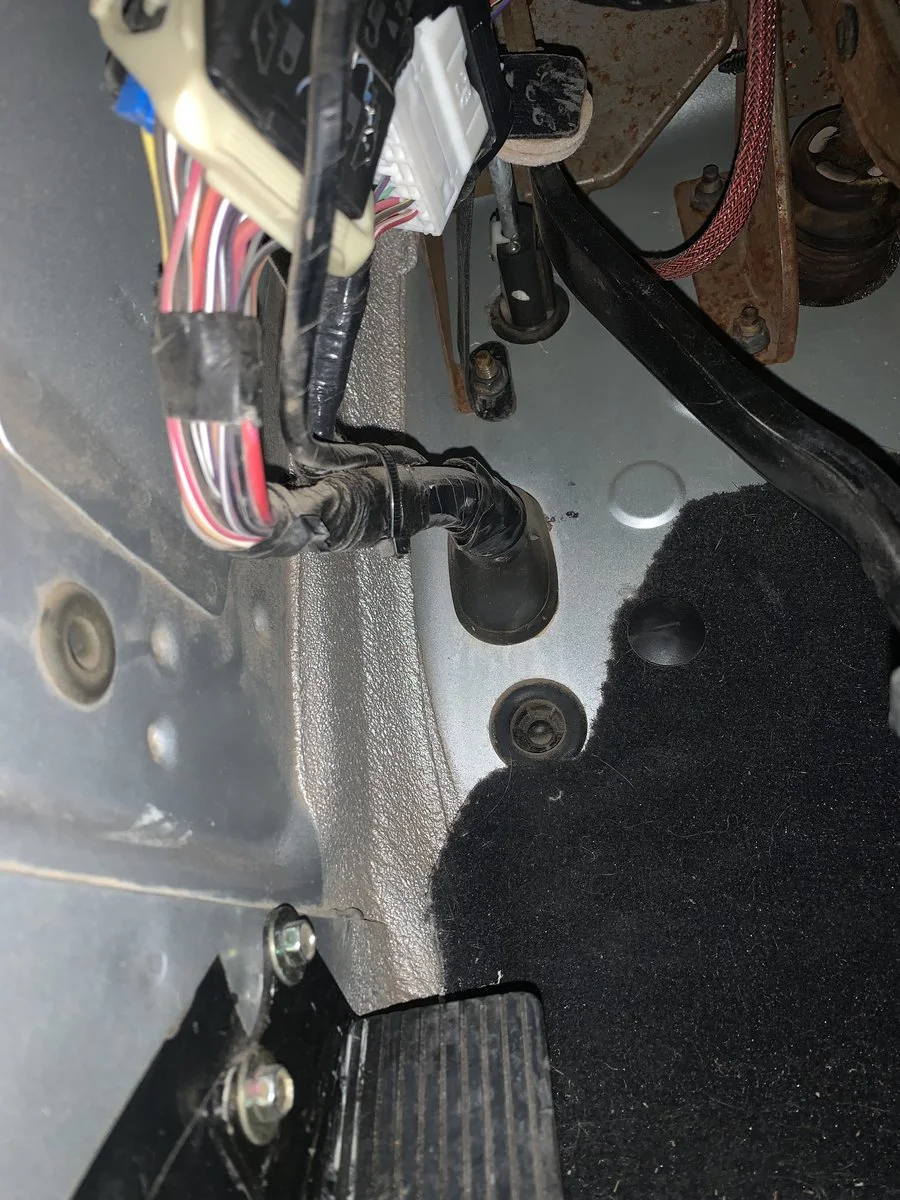

Every manual TJ I've owned has had a rattley clutch pedal. Just the way they're mounted. I always wanted to find a fix but then I forget about it until I'm on a bumpy road again
Here is my “fix”. Fabbed out of the decorative garage door hardware I removed. This is not putting any undue pressure on the pedal, but just keeping it from rattling.

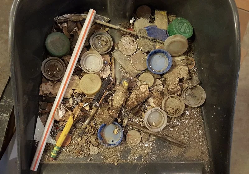

I bought a Jeep from someone once that had all kinds of rattles I couldn't figure out. While doing a restoration on it, which had no carpet or drain plugs installed, I discovered all of this had fallen into the front floor drain holes and was trapped in the channels below. I cleaned it out and the rattle problem was solved!
I see some karma dollars for your troubles right there... 👀
