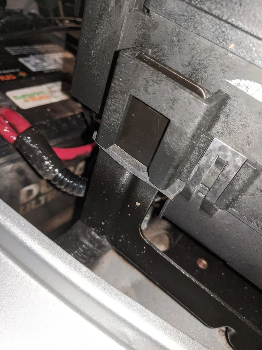

1. underhood fuse box - found lots of play in up and down movement, hitting just the right bump pattern it would rattle around.
my repair - found some 1/8" thick or so rubber sheet laying around, cut 4 rectangular chunks off and slit the center open and slide over the 4 post the fusebox slides down onto clips into place. no longer makes noise.

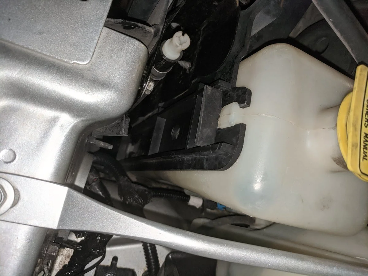

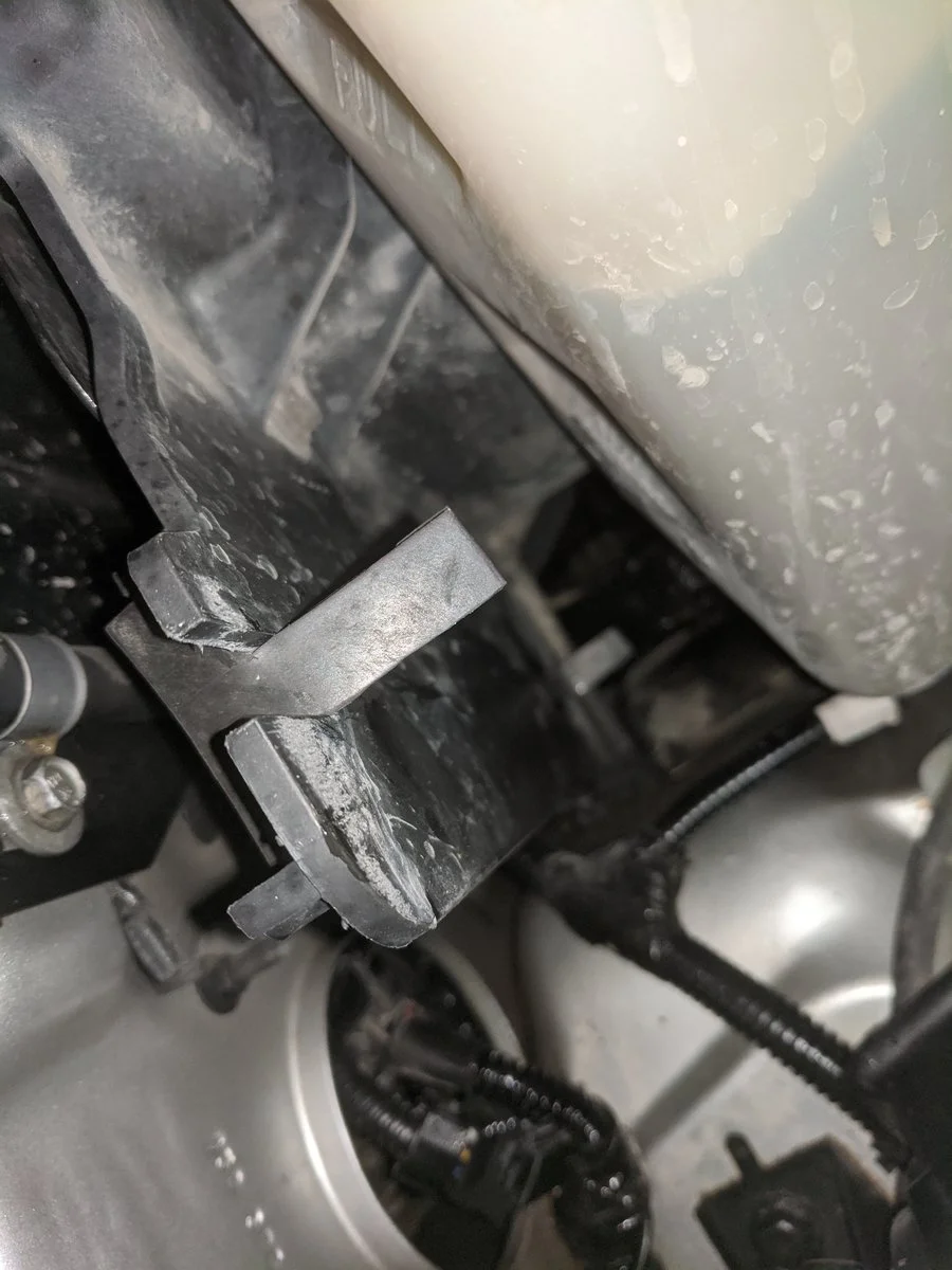

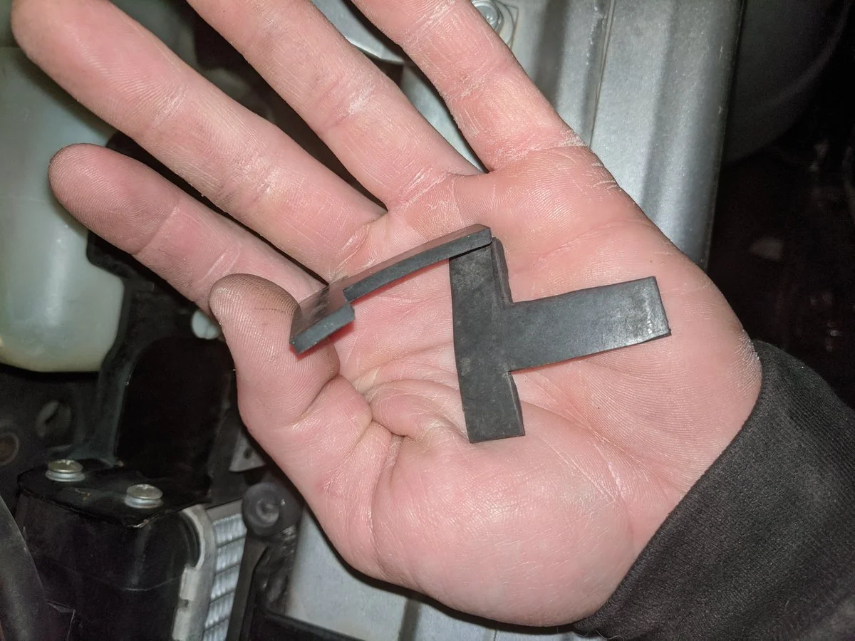

3. radiator reservoir tank - found slop in mounting tabs, made a thud noise when pulling up on and letting go to drop back down in place, moved up and down about a 1/4 inch.
my repair - rubber sheet material again, removed the tank and cut rubber into a T shape to fit down between the mounting bracket and tank. noise and slop is gone.
