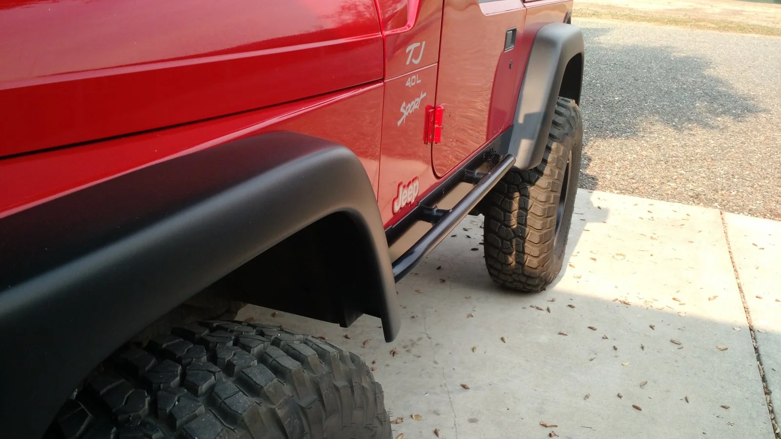

I have a 2" OME HD lift (which is probably closer to 2.5"), and a 1.25" body lift. I got BFG KO2 33 x 10.5. For me, there is plenty of clearance. The 31's wouldn't have looked right for me.

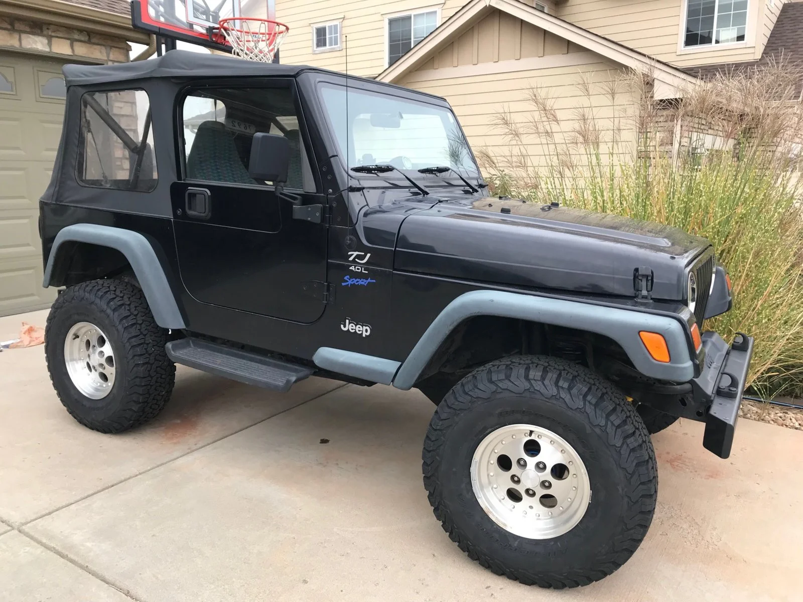

What a nice looking TJ. Best color in my opinion. It doesnt look like anything was ever hard on that Jeep. Im tempted to photoshop my face on your picture standing next to it.
