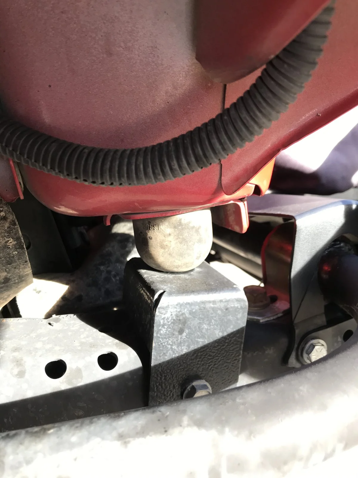

4466B503-43BB-418B-BED3-E744966A3B6D.jpeg Is the bolt-on bracket under the cushion part of the body lift?

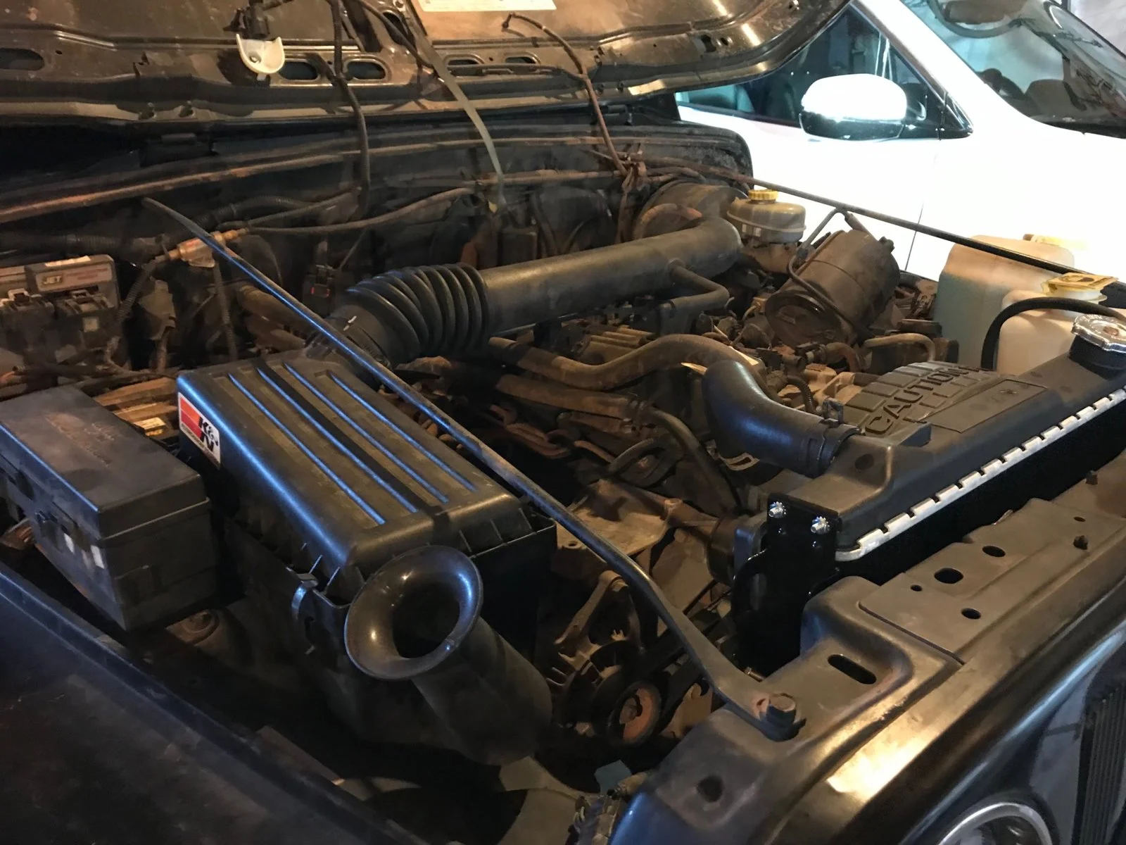

In this case of removing the BL, but keeping the MML, you'd have to move the fan shroud UP, which seems like it would extend above the top of the radiator, which could be a bit weird. From mine (see picture), the top of the shroud is pretty aligned with the top of the radiator. If that was moved up 1", that might get strange.
If that's the case, perhaps removing the MML would be the right thing if removing the body lift. That's my guess, but I'll defer to more experienced folks on that.
