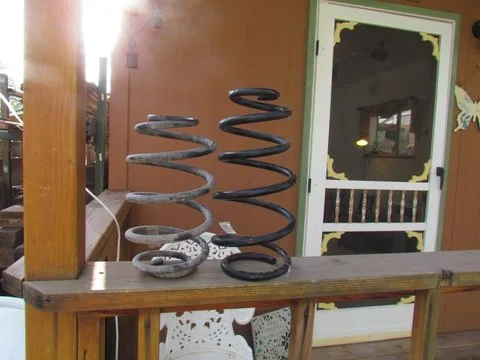

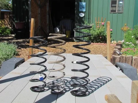

I can speak to that. JK front springs aren't even as tall as TJ front springs. You'll lose height. I tried that with JKU Rubicon front springs. No good. The rear springs, on the other hand...
Front springs from left to right, JKU spring, TJ X spring, OME JK spring:
Rear springs from left to right, TJ X spring, JKU spring

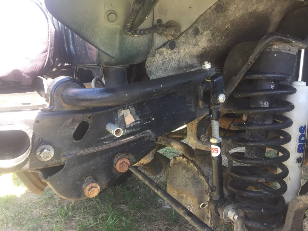

Your sway bar is this:
See if your sway bar links (in my picture it's the things that say JKS on them, however yours are more than likely stock sway bar links) are disconnected from their connection point next to your rotors.
To see if it's your shocks causing this issue, push down on the front of your Jeep and see if your Jeep bounces back up and down.
If your Jeep just slowly rises back to its normal grade, then it's not your shocks and they are working properly.
