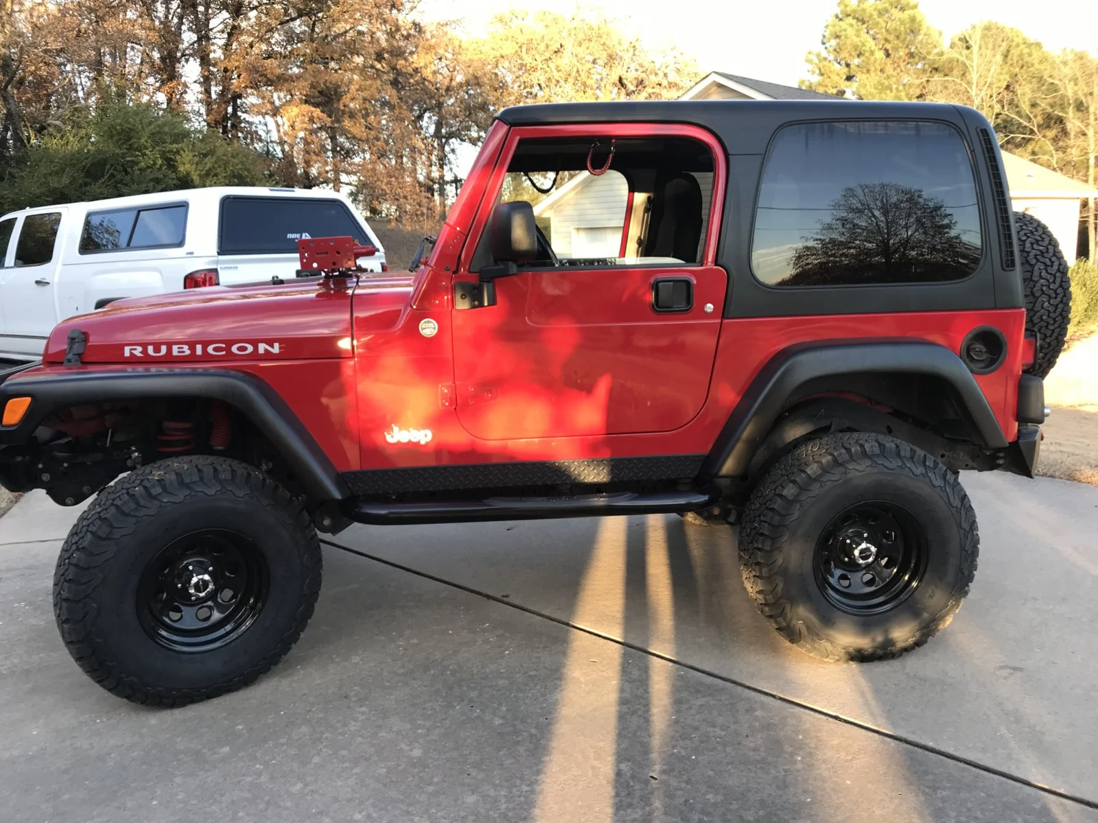

Here is the jeep on 33s. Drives a lot better. I am going to check angles for drive lin. Future plans to reduce spring lift.

Unless you plan on a tummy tuck (raise the tcase skid) I'd pull the body lift. Looks like you could use some new body mounts anyway, so you'd kill two birds with one stone, so to speak. Far cheaper than new springs, too.
Setting the bump stops correctly is needed based on the pics. Some Rancho 5000X shocks will make for a nice ride.

You are sure correct on the body mounts. I will study setting bump stops and get those rc shocks off.
