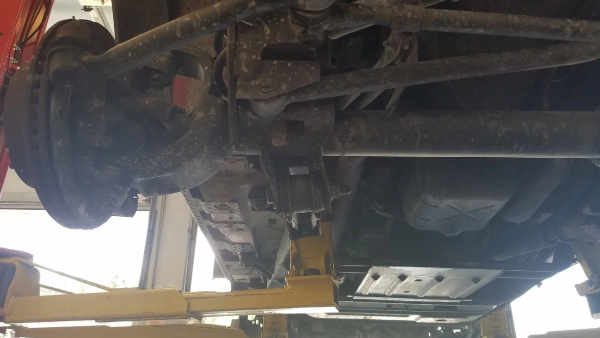

You guys should get a kick out of this. I took her into the hobby shop on base today, threw it on the lift, pulled the tires and started going over the suspension and drivetrain.
First things first. @xxdabroxx should get a kick out of this. Remember how I said my swaybar was connected? Well, with weight on the suspension, it was. As soon as the springs extended and everything lowered though..

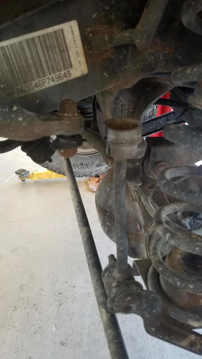

Pay no mind to the shitty focus, it was bright and I couldn't really see my screen clearly. That would be the driver side sway bar endlink... not connected. Not in one piece, actually.

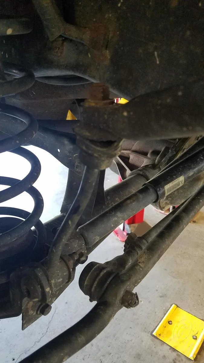

So here's the passenger side, which is not far off from being the same way.

Well, now you know why it feels like a sail boat going down the road!
If you aren't going to lift more than a couple inches replace your bushings with stock ones. If you are going much over that you would benefit from adjustable control arms. I think you can get all of the control arms on amazon for something like $190. I think you are talking about the ball joints, they are in the "C" that is attached to the end of the axle tubes. If they are tight, tires won't rock up and down, etc while on a lift I'd leave them be.
Stiffer bushings aren't good for a TJ suspension, it needs to flex.
x2
Poly bushings on a TJ are asking for disappointment. If you aren't going tall on a suspension lift, aren't in a hurry to mod your TJ, or aren't exactly sure what trails you're going to run, buy a set of stock arms and plug those in. The stock arms work well at low lift heights and are cheap enough to not agonize over.
@LCL-Dead, it looks like you have some serious repair work to do before you can start to think about suspension mods. Now this is just me, but I would repair all of the known defects back to stock (or better) and then see what mods make sense for your use. There's a lot of questions involved in modifying a TJ suspension, and long arms are rarely the correct answer.
