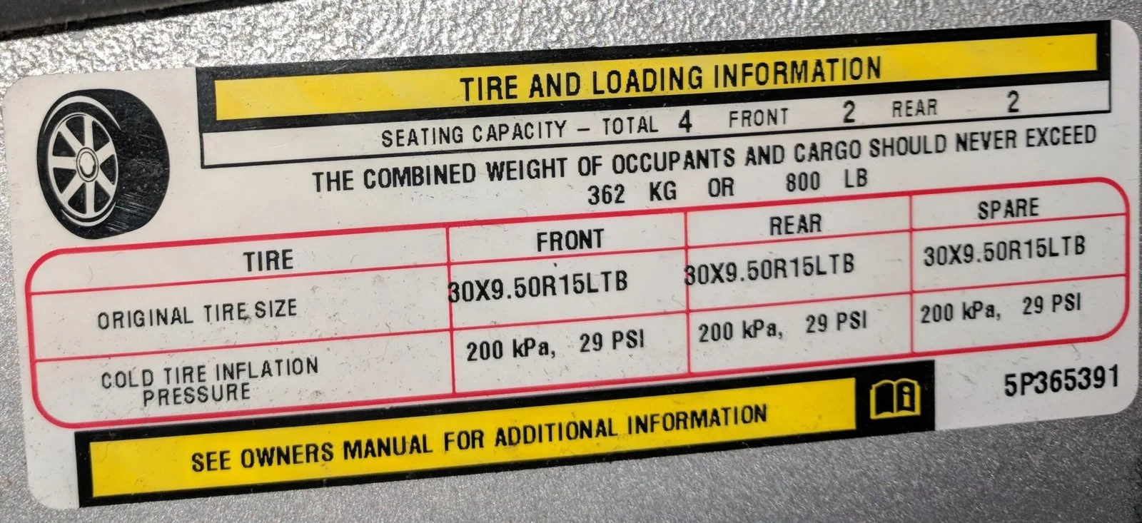

Factory recommended pressure for 30’s is only 29 PSI.
Thanks Mots, I hadn't seen a 30" factory size tire recommended air pressure sticker in years.
You’re welcome! The sticker was upside down (by design) and hard to find when I first bought my 05. So, I took a pic once I found it and then cropped and rotated for safe keeping. I cringe when I hear folks running 35 PSI on stockers, and with 33’s...wow! Can you say “Death Wobble trigger”, LOL.
