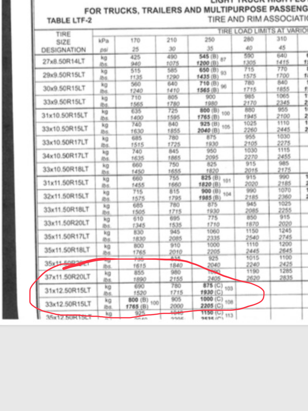

So at 21 what is the wear like?Here is a tire chart from Cooper. My 33 x12.50 SST Pro is still rated for more than my Lj weight at 25 PSI. I have been running 21 in mine for over a year and close to 10K. Just did a toys for tots run where I had to travel 280 miles each way on the expressway to get to it. Set the cruise at 75 and rolled along.
