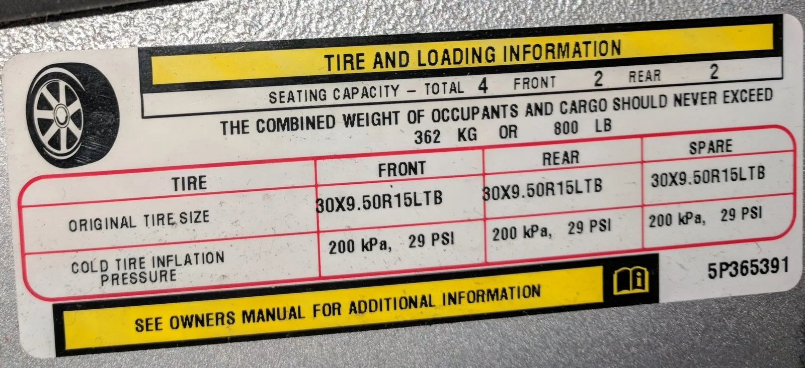

Also, the bigger the tire, the lower the air pressure that is required. For the factory 30" tires the Jeep recommended tire pressure is only 29 psi. So that means your 33" tires will have a lower correct air pressure than the smaller factory size tire requires.
For a 33x12.50R15 tire with a Load Range C rating on a Wrangler TJ, the recommended tire pressure is 26 psi when the Jeep is lightly loaded, and 28 psi when fully loaded with people and/or gear. Experience over the years continually reinforces those two tire pressures as very appropriate for that size tire and load rating.
