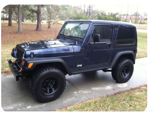

This is the appearance I'm after. Cheers, Rol1964

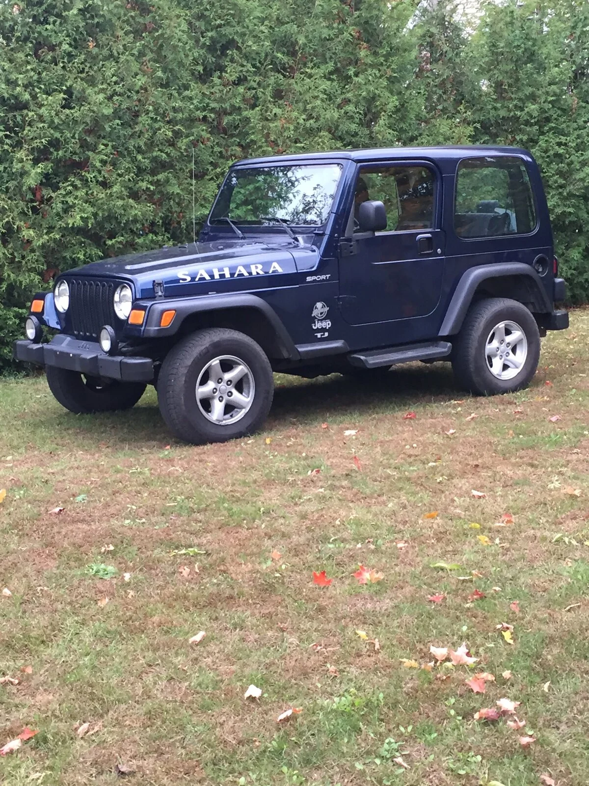

Perhaps post a pic of your TJ as it currently sits, along with a photo of what you consider inspiration, and we can help you come up with an affordable solution?
An excellent idea....
So, from this:
to this:
So that Jeep looks like it has 31" tires on a 15x8 wheel with 3.75" backspacing. That spaces the wheels out almost 2" further than the factory 8" wide wheels like Canyons or Ravines. Aftermarket 15x8 wheels with 3.75 BS and a set of 31" tires would get you that look, but the tradeoff is that the tires stick out past the fender flares and will spray crap all over the Jeep. You could get wheels and tires first, then add a 1" - 2" budget boost, but you may be happy with the wheel and tire change only.
