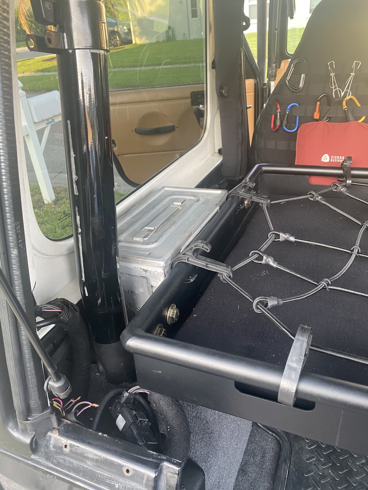

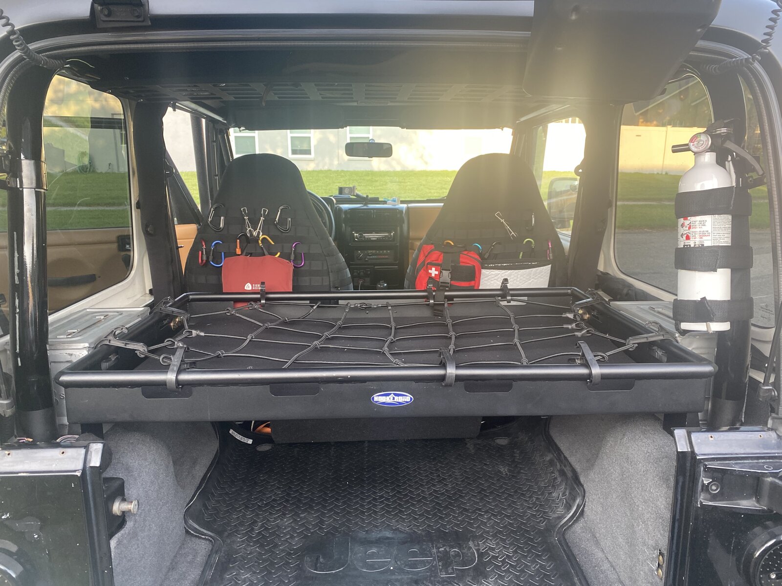

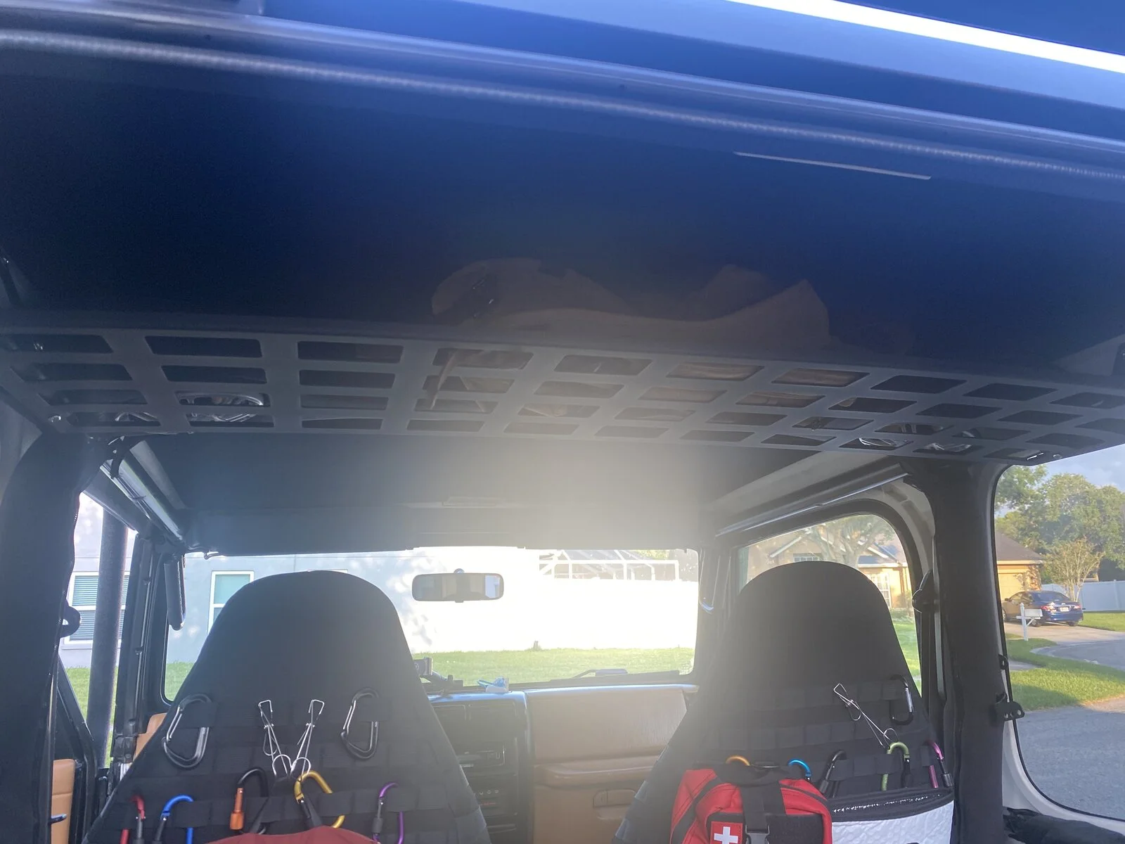

Since I got my Jeep I had been trying to find a way to store everything I need and want to take on trips. I got it tuned in pretty good now so I thought I would share. (Yes I have a lot of colorful carabiners) also don’t mind my exposed hardtop wires. Trying to work on my rear defrost after wiring my Jeep for a hardtop

I was looking into the drawer at first and then I decided to go the shelf route. I just thought the shelf would be more useful day to day. I keep all my camping and recovery stuff in plastic bins so they fit in there perfect and I can move them from car to car easily. Plus now when i go to the grocery store I can fit 2x much groceries haha.

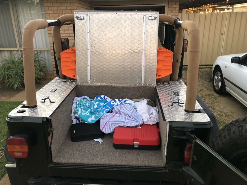

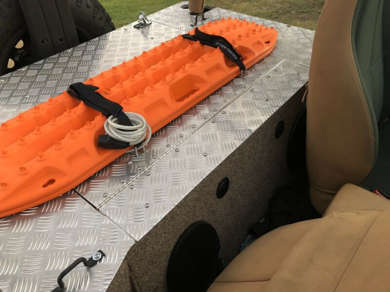

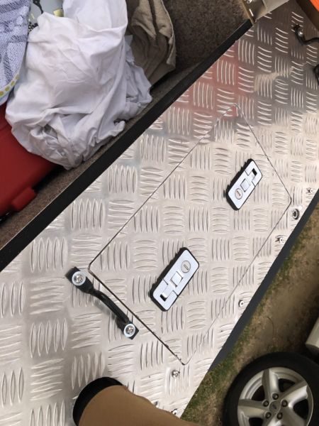

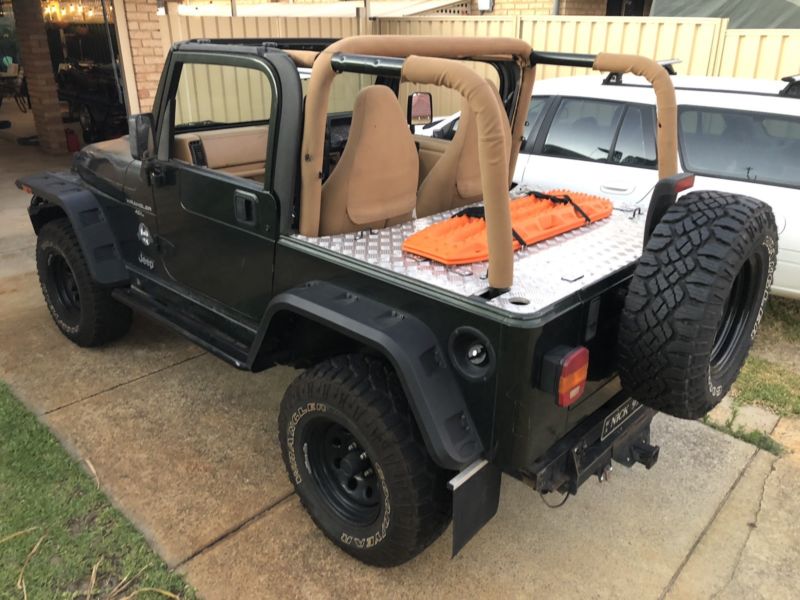

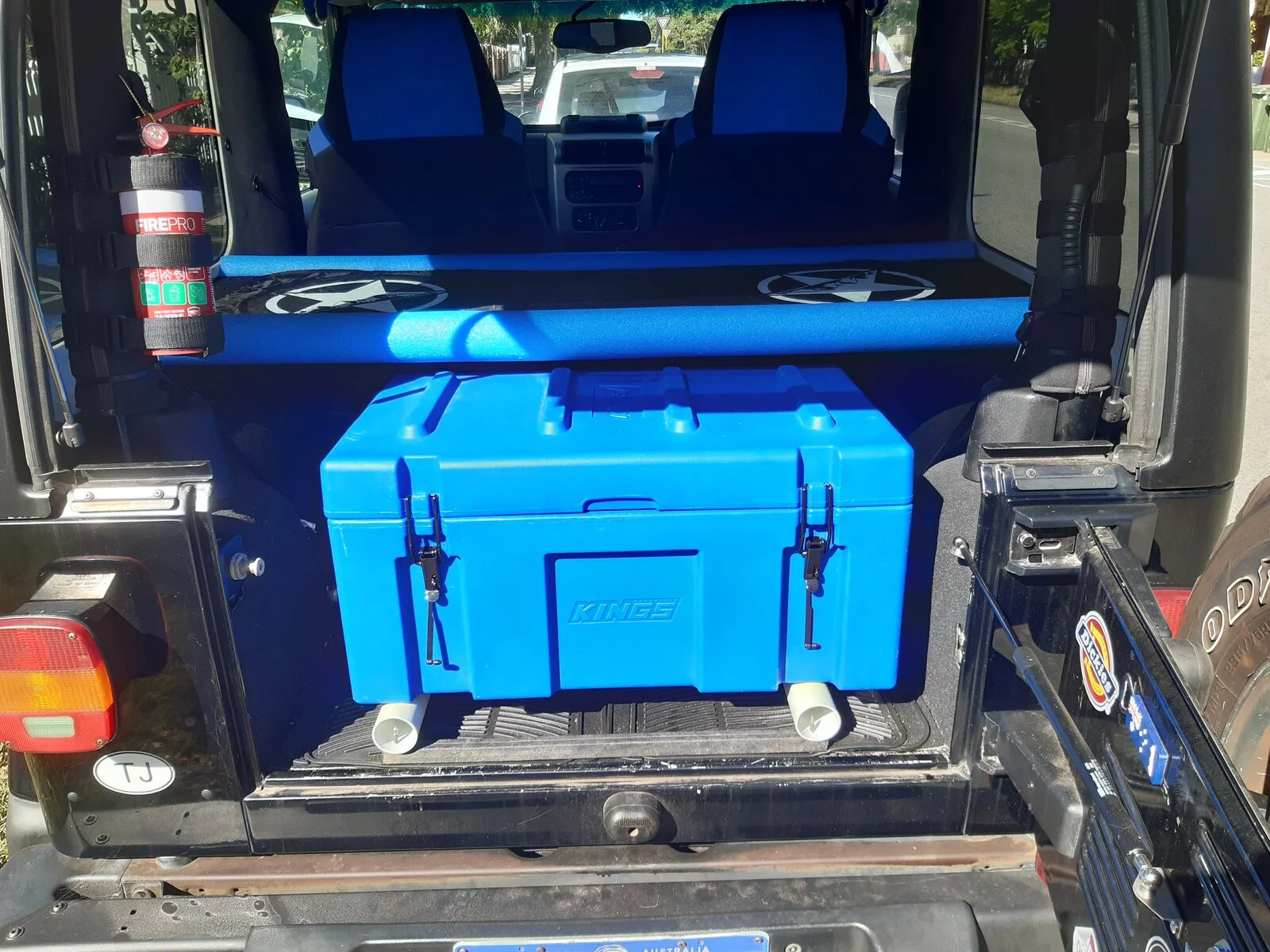

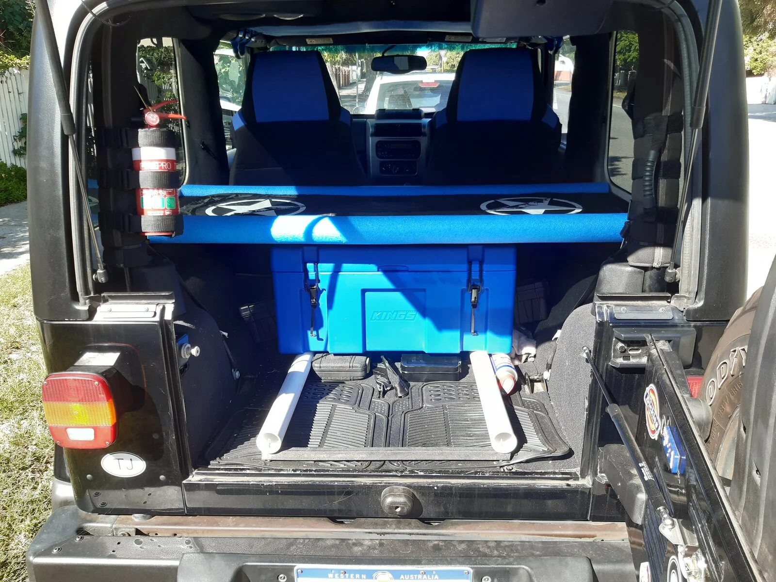

I just have a piece of carpet covered ply spanning the inside of the hard top the shipping to Australia is way too expensive for the rear tray although I would like one like yours, I can fit 2 decent sized pelican type cases under the shelf with ammo boxes each side and my fridge sits on the shelf.
I edged the sides of the shelf with "Pool Noodles" stronger than pipe lagging and it stops it sliding around, I can push it to the back of the front seats and pull it back to the rear bar, the boxes slide out on 2 pieces of inch and a half pvc pipe raised at the rear which gives me room for tools under the boxes, I use soft top cage brackets and rear seat mounts for tie down points. personally the slide out fitted draws are an expensive waste of space in my opinion but mine was just a quick cheap solution when I first bought the TJ
Boxes are stackable so I can fit 3 if I put one on the rear case.

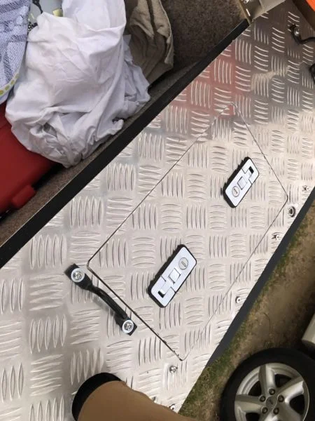

This is my homemade version.
