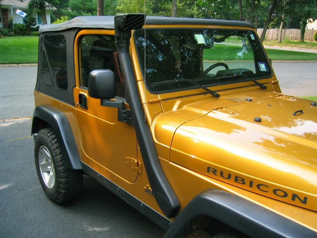

Take a look at almost any well 'set-up' truck, jeep,Toyota, Suzuki, etc in Australia and you'll see a snorkel. The reason has little to do with water and a lot to do with dust. Unless you are the lead truck in a convoy your engine is going to be sucking pure dirt with all the particles in the air that have been kicked up by the tires. The higher the air intake, the less foreign matter Your engine will still stop from water shorting out the electronics on a truck. A snorkel is just going to keep water from being ingested and seizing up the engine with disastrous mechanical results. Snorkels are more needed in the dry and dusty West than in the wetter East.
so I have to ask, what is going to stop that dust/dirt from going into your intake that is pointed forward.

There are a lot fewer dust particles at 6' than at 3' off the ground. Not Zero particles but not as intense and way better for the engine the higher the air intake. Pointing the intake on a snorkel forward is also rather dumb. Suppose they think that there is some benefit from ram air effect but doubt that makes any significant difference. By sucking the air from the rear you get some self cleaning effect as the denser dirt particles will have a tendency to keep going south while less dense air will make the bend north to the snorkel air intake more easily. Might be a negative pressure effect if you drive 70mph on dirt trails/roads but that's its own punishment to all the other components on the Jeep that will fail before the motor.

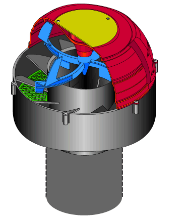

The whole of Australia and every construction crew and heavy machinery manufacturer/operator running active prefilters like a Sy-Klone or Donaldson are just doing it for Instagram clout.
I was just in the outer banks and all the state rigs cleaning dunes off the roads were running Sy-Klones on stacks and I stopped and told them to cut it out and they just flipped me the bird, some people

thats real nice. how many have you seen with that on them. I do like that you could put some LED lights in it and have a street lamp 🤣 @AndyG this would make a nice addition for the duck pond ! 🤣🤣🤣
All the ones that are installed for function.
