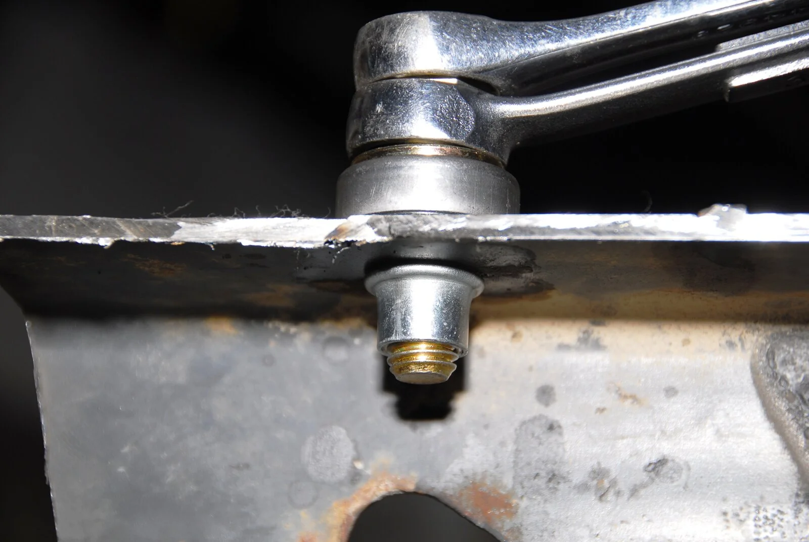

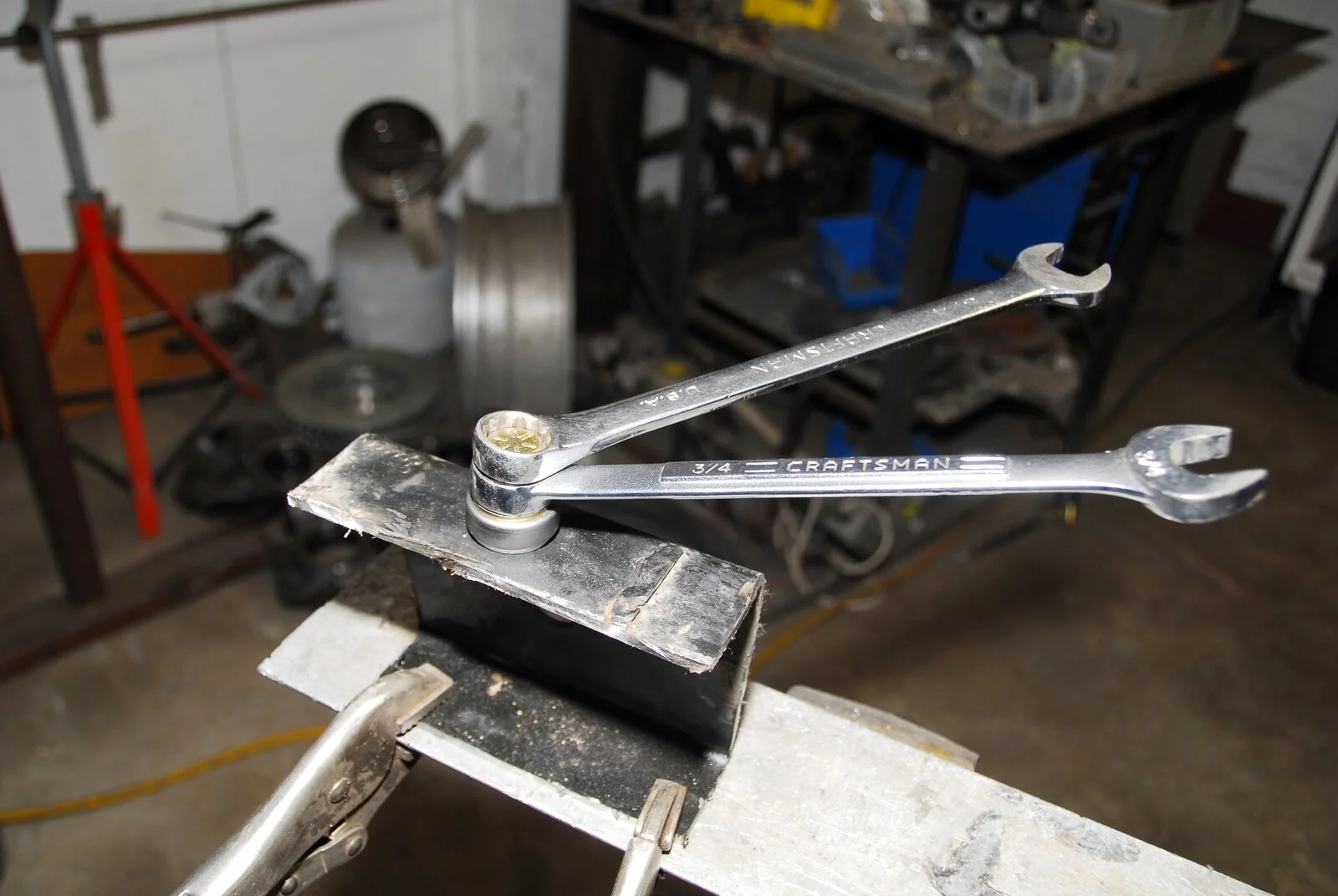

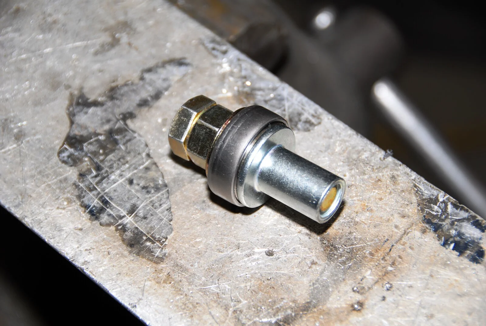

I finally had a few moments to source a thrust bearing to change how frame nutserts are set and stop the thread stripping that happens when the bolt is turned inside the threads to pull up the nutsert and set it.
This tool reverses the setting action by holding the bolt still inside the nutsert and turning a nut down on the bolt against a thrust bearing to pull the nutsert up.
Just drop it in the frame hole and hold the bolt with one wrench, turn the nut. No lube or anti-seize needed, very low turning effort, nutsert doesn't try to spin.
Sets them very tight with almost zero chance of stripping out the threads on the nutsert.

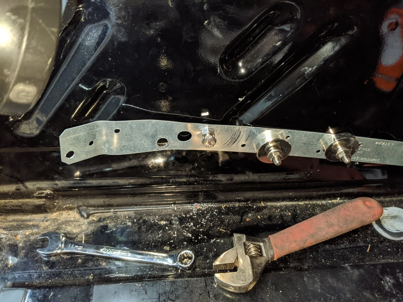

That's a bit classier than what I did recently, but same motivation: I wanted to draw in the nutsert without turning the bolt.
Hold the bolt still, turn the nut down, put something between the nut and nutsert to keep the nutsert from turning.

Stripping the nutsert is my biggest customer issue due to watching YouTube videos where they give a torque spec and then slather the bolt thread with anti-seize which drives the setting torque the threads see much higher.
This way stops all of that shit and the effort to turn the wrench is very low comparatively.
