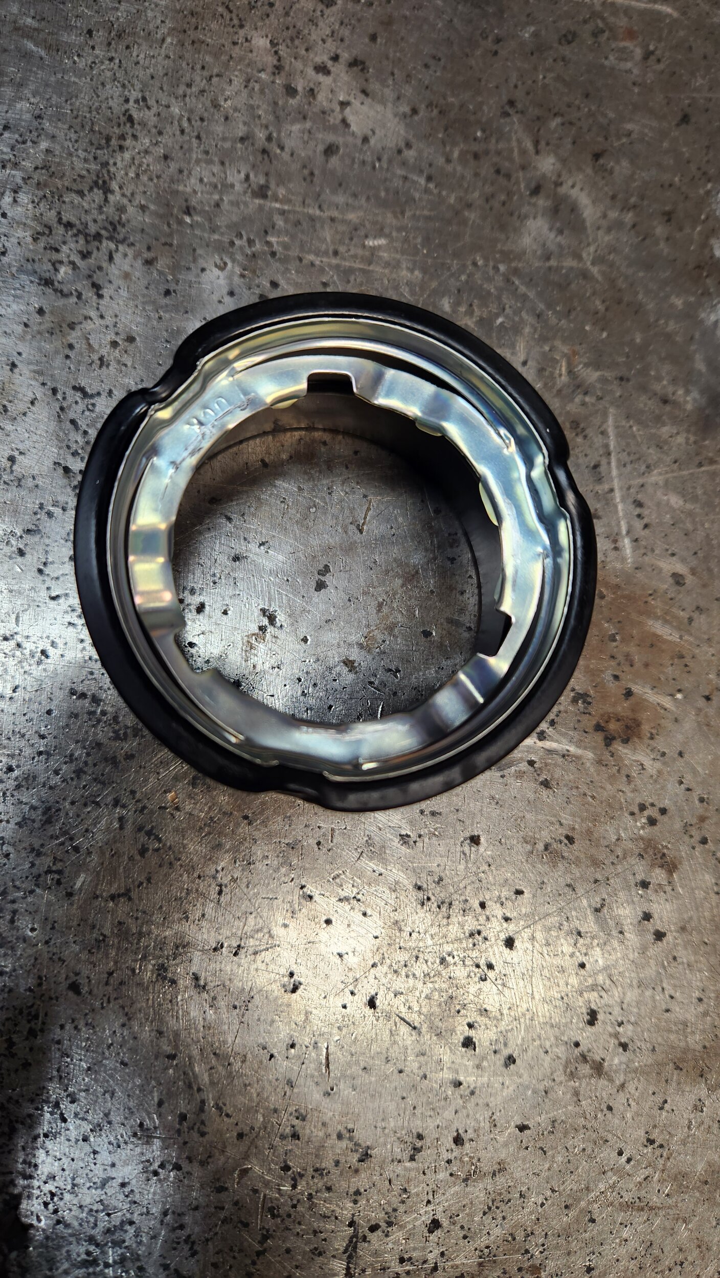

Put in the 80/100s from Quadratech today, I can see now why everyone said they won't be an issue in the city if aimed correctly. On low beam it's pretty hard to tell that they are even brighter at all (I swapped in only one and went for a drive, then walked out a ways and looked back on both high and low) and on high beam they are slightly brighter. Pretty happy with these lights. Impossible to unscrew the bulb retainer though without removing the entire headlight.
I was able to tap the retaining ring loose with a piece of brass rod. Got it back on with a bent needle-nose and some more tapping. Might give the ring a touch of dry lube or silicone lube so it's easier to turn next time. Will probably replace the 55/100s with 80/100s at some point, why not they're cheap.
I was thinking of making a tool. It is a fraction larger than a 2" ABS/PVC coupling and would need 3 dimples in it. I even tried all my old 4WD sockets and my 3/4" drive sockets, nothing would fit perfect. I have a lot of 2" threaded couplings, might try one of those and if it slips over the nut I can weld in 3 tabs.
Reactions: AzJeff

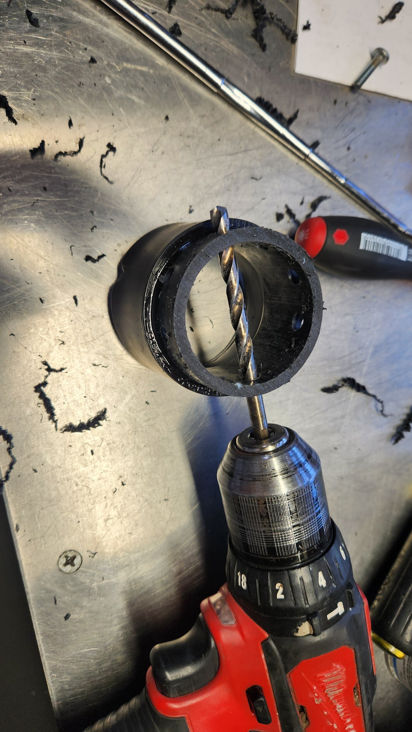

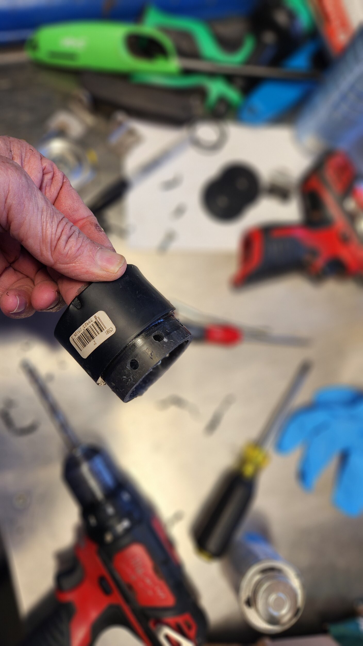

I made a tool and it was super easy. I took a 2" ABS coupling, heated it till soft with a heat gun then pressed it onto the retaining nut which I first laid flat on my steel table. Then I took some right angled needle nose and gently put the 3 dimples in. This alone works on the un-installed headlight, but once the headlight is installed there isn't room to get your hand around the coupling due to the recess in the headlight area, so I added a short piece of 2" ABS and cross drilled it for a Phillips screwdriver. Then just press it on and stick a screwdriver in the holes and pop it off. To install, get the retainer started first, then press the tool on and turn till you feel/hear the click. You still have to move one of the horns out of the way on the driver's side but the tool makes the lamp swap a 2 minute job and no blood.
