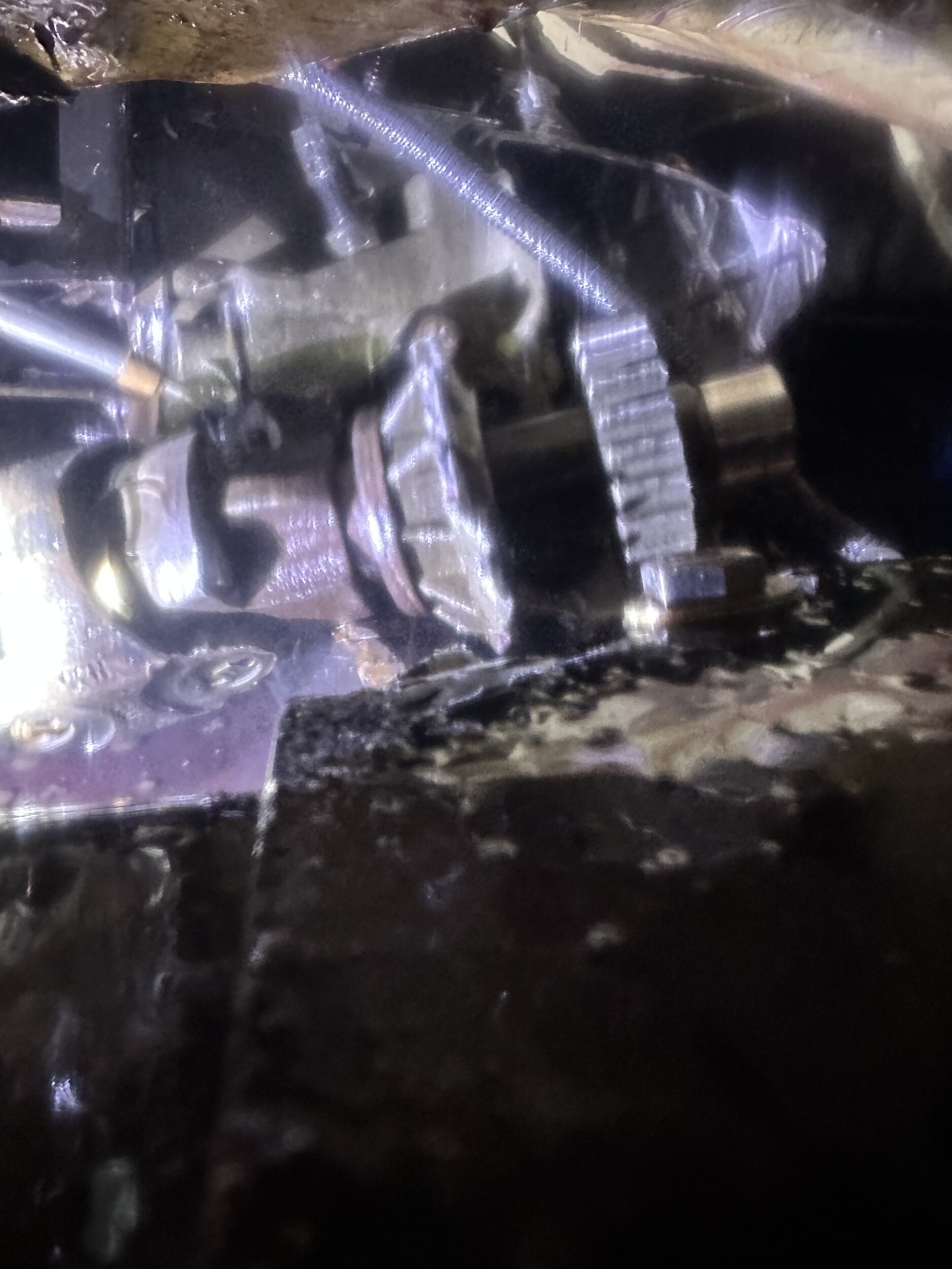

The CV joint (centering ball) on the front driveline began chirping with only 46,000 miles on my 2006 TJ Rubicon (4" lift). Had it rebuilt with the greaseable unit. Yes, greasing it is a major pain and takes a long time due to all the disassembly/assembly required but to me its worth it. Do it once a year when I do all the maintenance.
