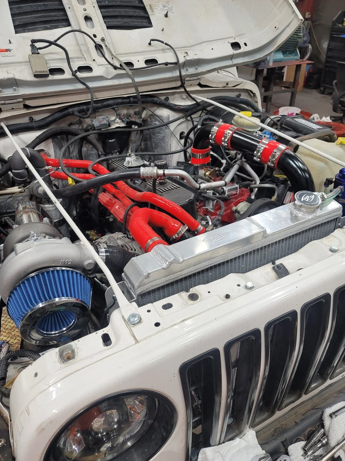

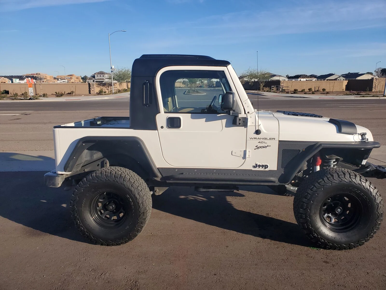

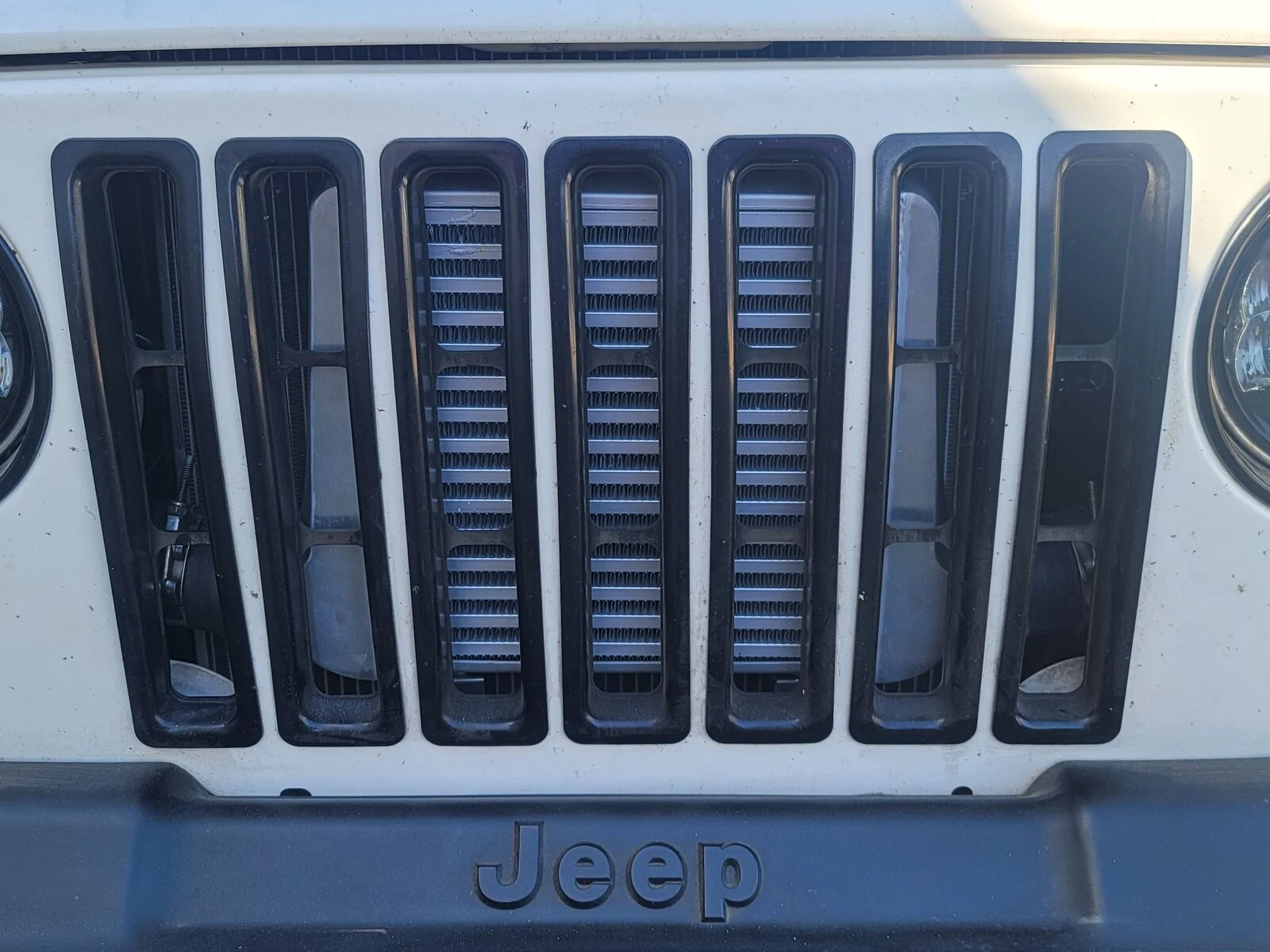

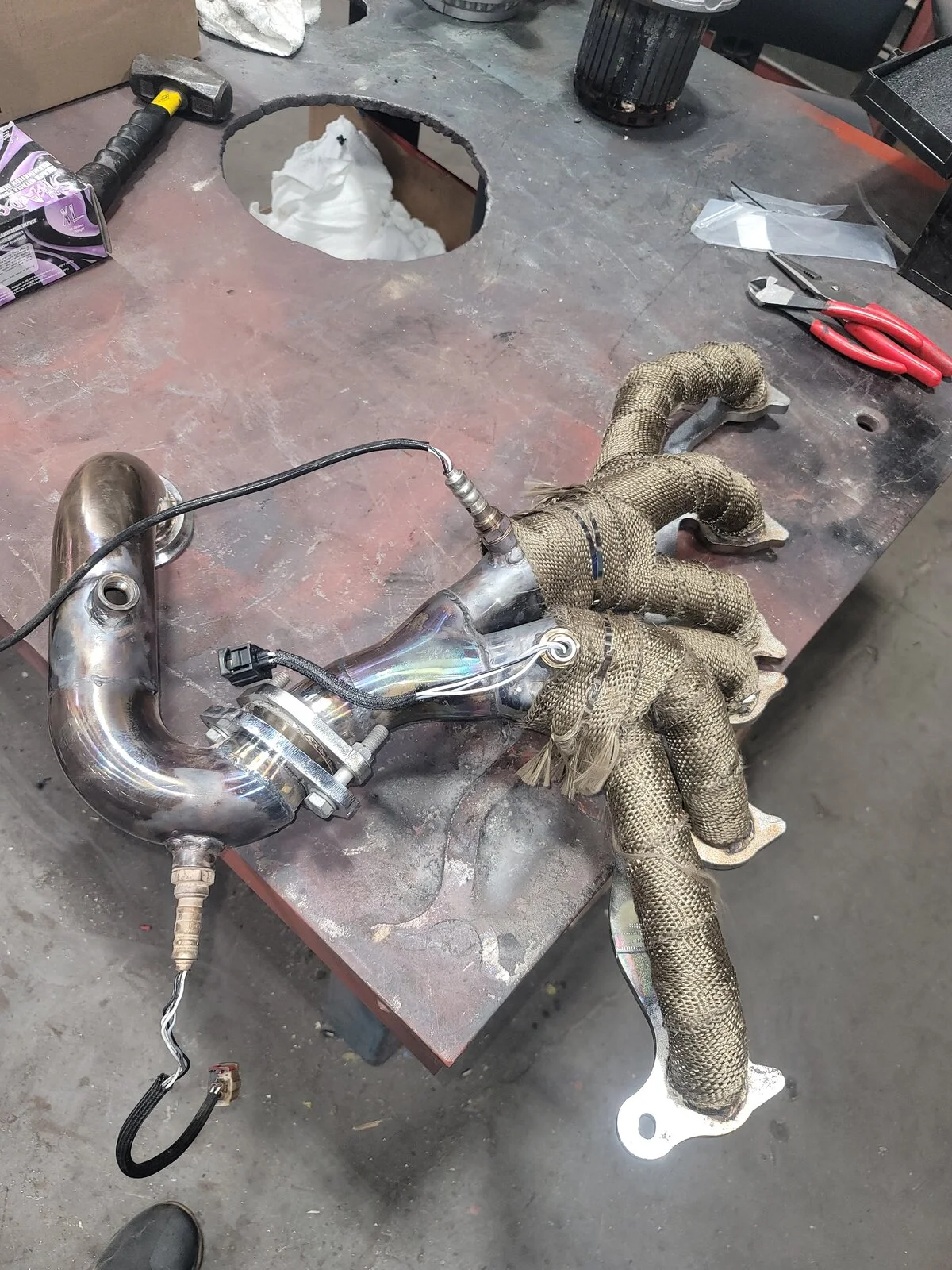

My second TJ and ive been happy with the performance on and off road. Stock 4.0 except headgasket, head studs, throttlebody and custom turbo kit. I also perfer the front mounted intercooler. Other mods include Brute halfcab, 4" lift and ARB air lockers

I'm curious about your setup, mainly plumbing of everything. What kind of engine control are you running?

Hey thanks for the interest in the build. So im running a splitsecond piggyback and it is great. You can go onto their site and simply download the map to match your setup. I bought a piping kit and cheap turbo from ebay and it has worked well so far. I am using an early TJ single outlet exhaust manifold to a custom flexpipe that comes up between the passenger engine mount and the alternator. Other engine mods include roller rockers, comp cam springs, custom downpipe, HKS boost controller and HKS turbo timer.I would like to go wheeling with you in September. Its fun getting out there. You about to boost your TJ?

So I can't remember if I told you about my setup or not. Anyway I'm running a Chinese 57mm turbo with custom piping, store bought intercooler piping and coupler kit. I have a HKS external 38mm wastegate, Tial BOV, HKS boost controller and HKS turbo timer. Splitsecond piggyback set for 36# injectiors and 12psi boost pressure. Everything works well together and ive had no real issues except my valve springs. I had to upgrade to comp cam spring (very important)

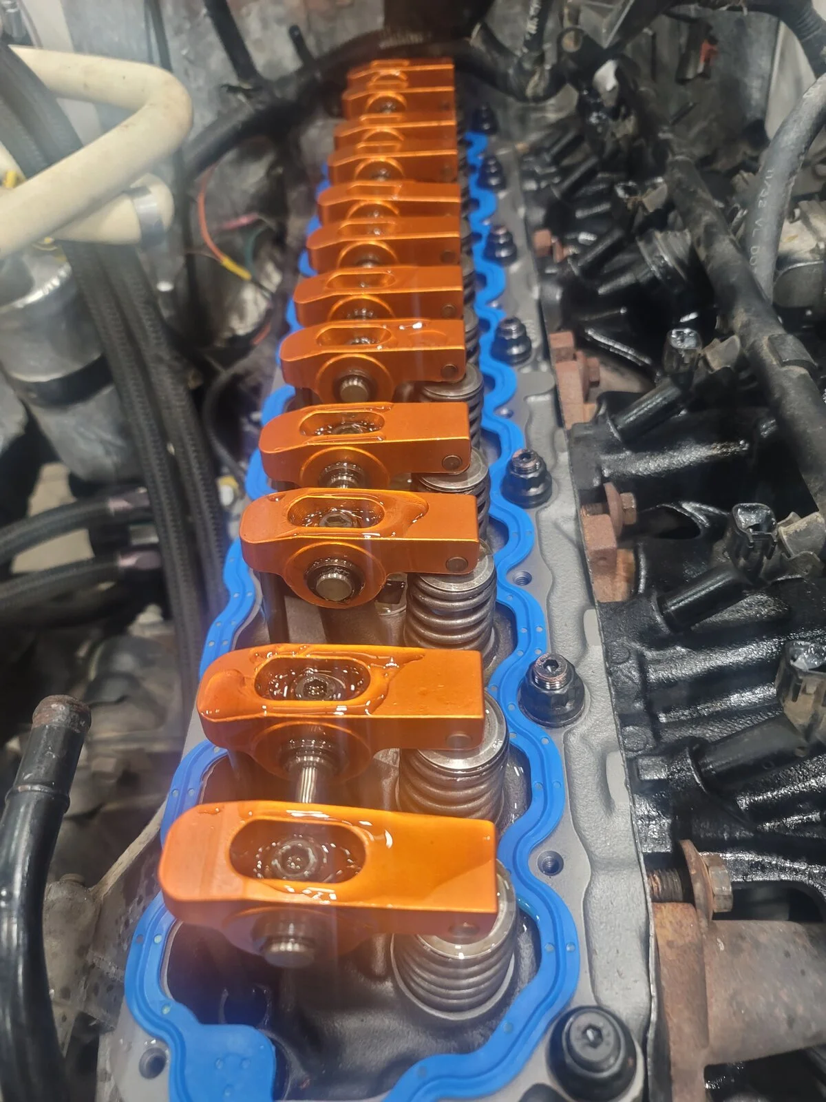

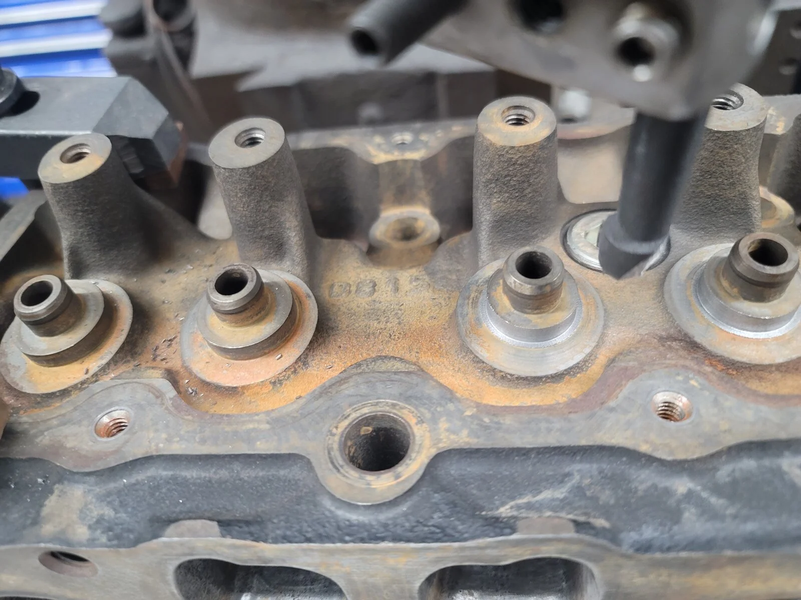

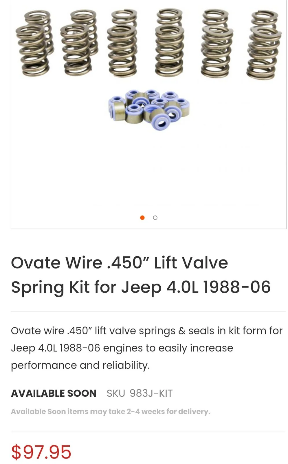

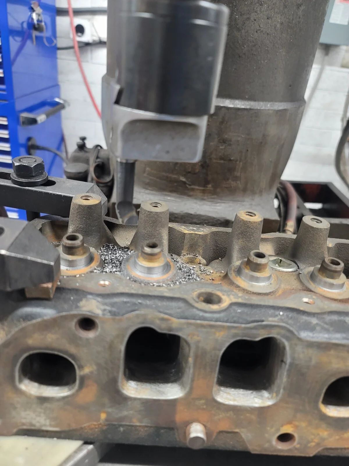

12 psi is safe if you have a multiple layer head gasket and head studs. The tune is the most critical. Ive been running at 12psi for over a year without an issue. I did have some serious valve float issues at 10psi and I had to switch to comp cam springs to resolve it. But just know that those springs do not just bolt up. You need to machine the head where the valves sit. Luckily I have all the equipment to do it at work. After getting the springs replaced its been a pleasure to drive. On the freeway it seems like any modern car now.

So my stock valves were floating at 3400rpm and 10psi in first gear and at 4300rpm and 10psi in any other gear. The jeep would pull hard then fall on its face, kinda like if you let off and jumped on the brakes. With the comp cam springs my issues were resolved completely and it pulls from when I start boosting all the way till the rev limit. But like I said earlier these springs do require machine work to the heads. In the last pic you can see how much I had to cut compared to one that I didn't do yet. They need to be .0830" in diameter or less to clear the comp cam springs.
