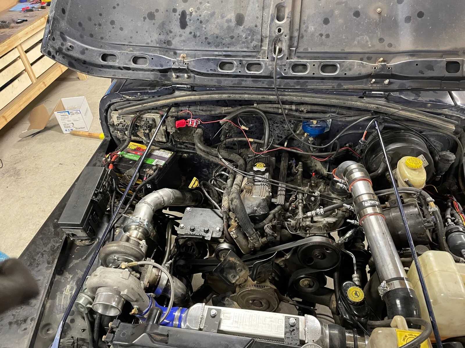

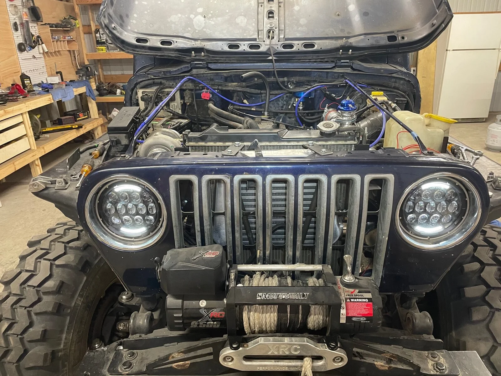

Update. Still running strong these past few months on 8 psi. Haven’t touched the tune since my last update. Took it out to Moab. It ran slightly richer but not too much to worry about. I’ll attach a few videos.

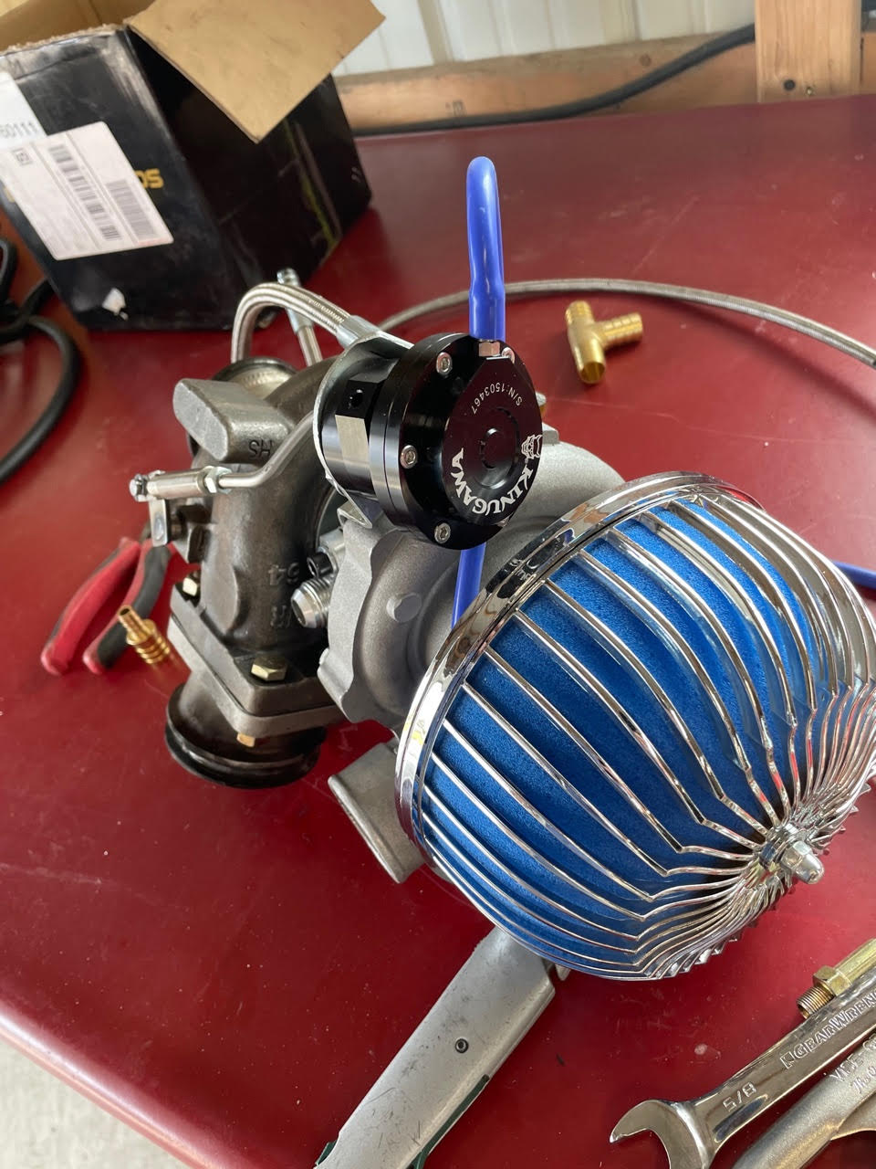

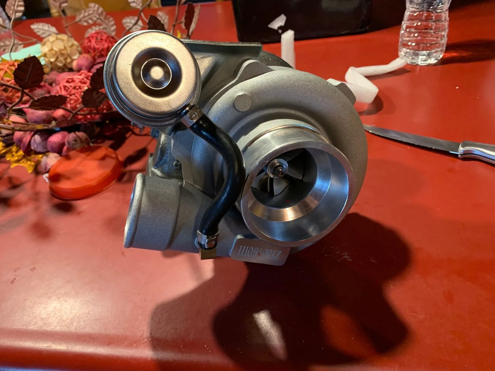

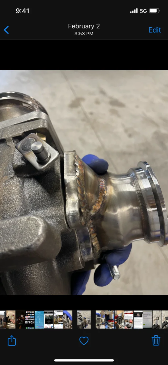

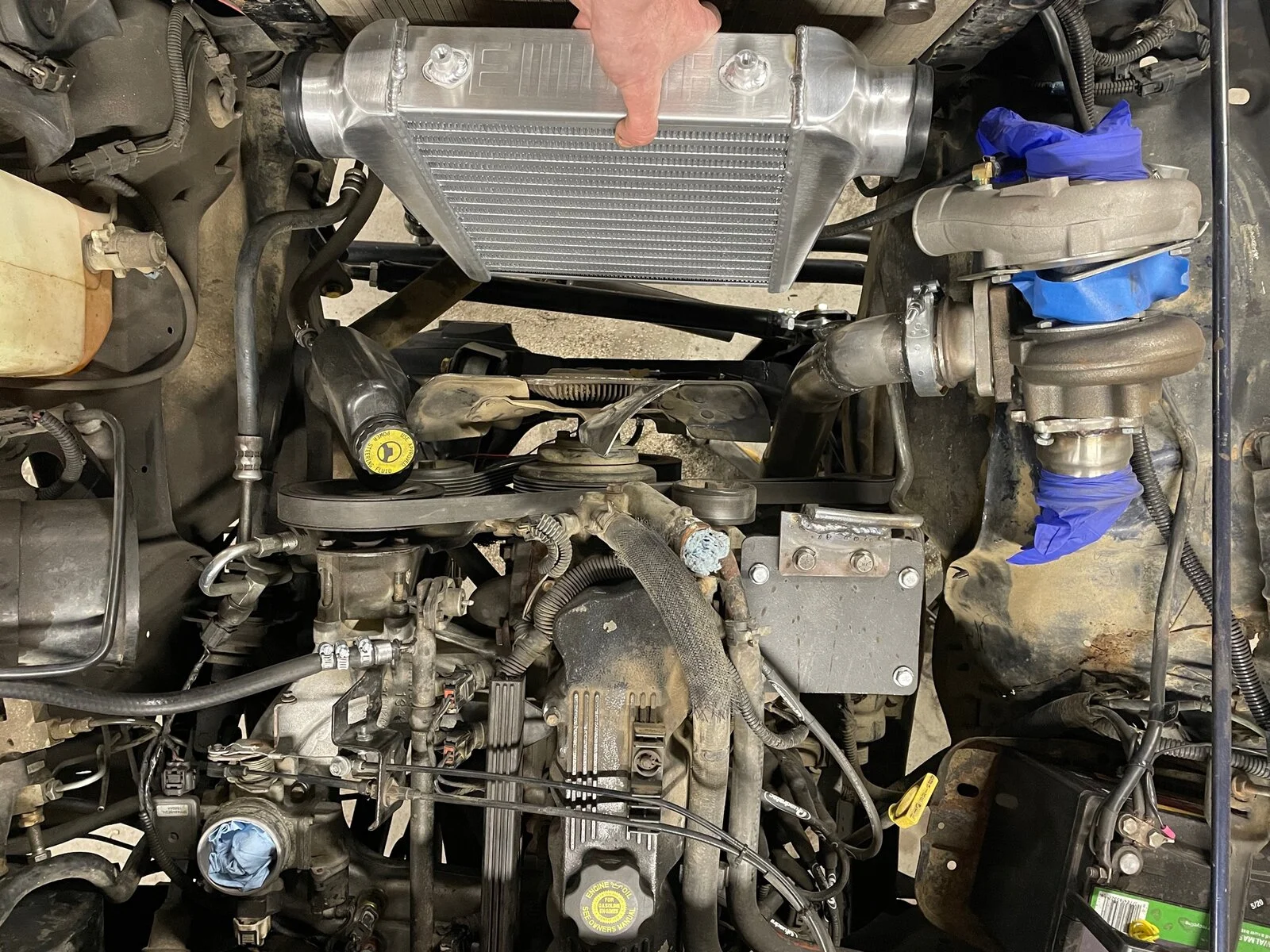

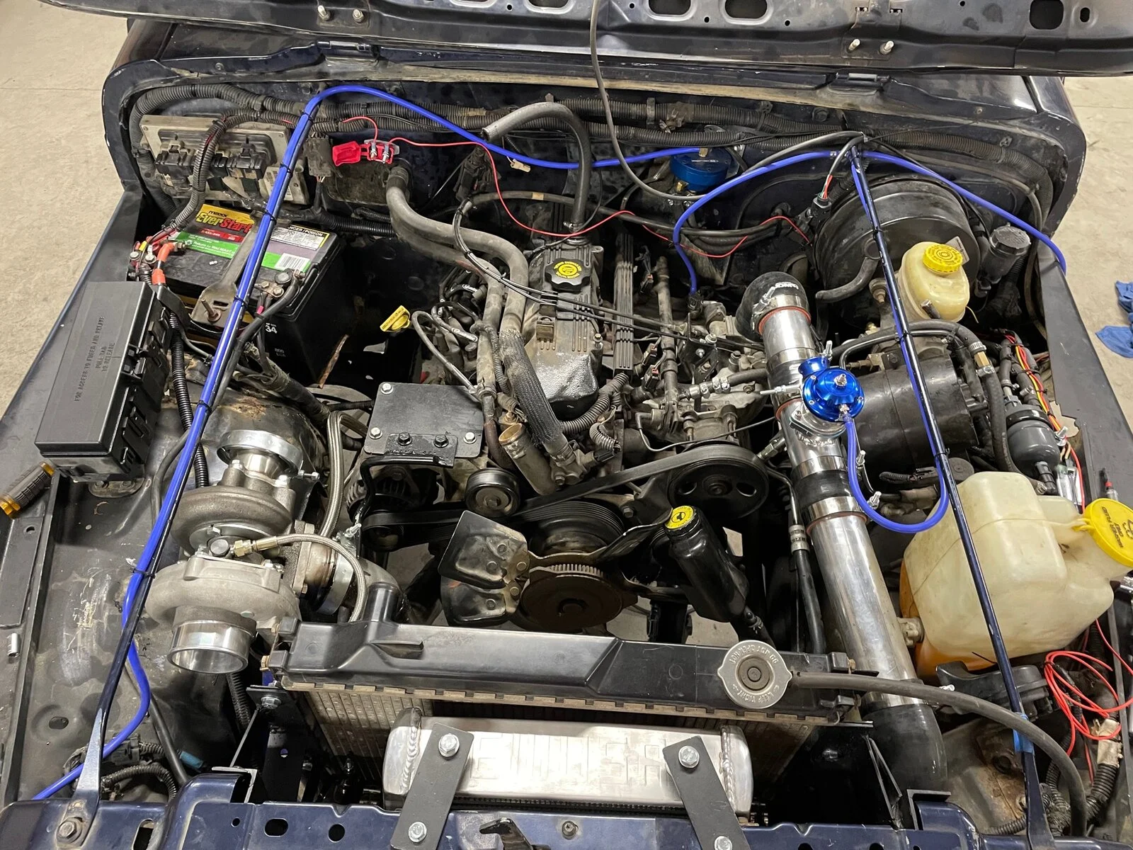

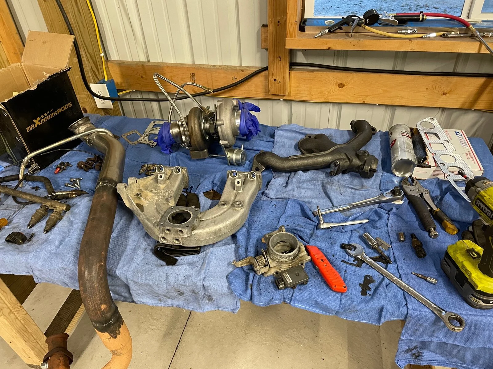

One problem I did have with the this Ebay turbo is the external wastegate is kinda random. I did some testing and it would not open until like 25lbs. I did try to rig up a few springs to help relief/rig it up, but I was unsuccessful. (seen previous post). So I did end up having to buy another external waste gate with changeable springs. Another note is these Ebay turbos have very bad air flow through their wastegate, so I did spend a significant amount of time porting it.

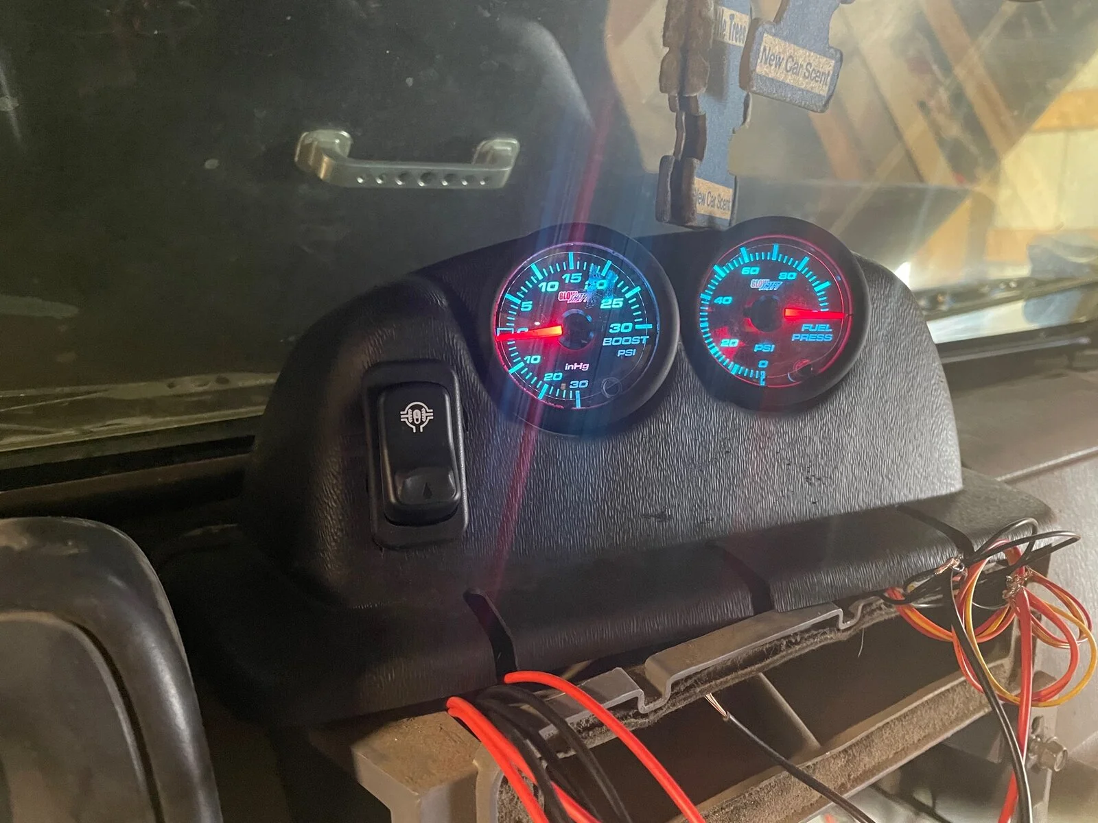

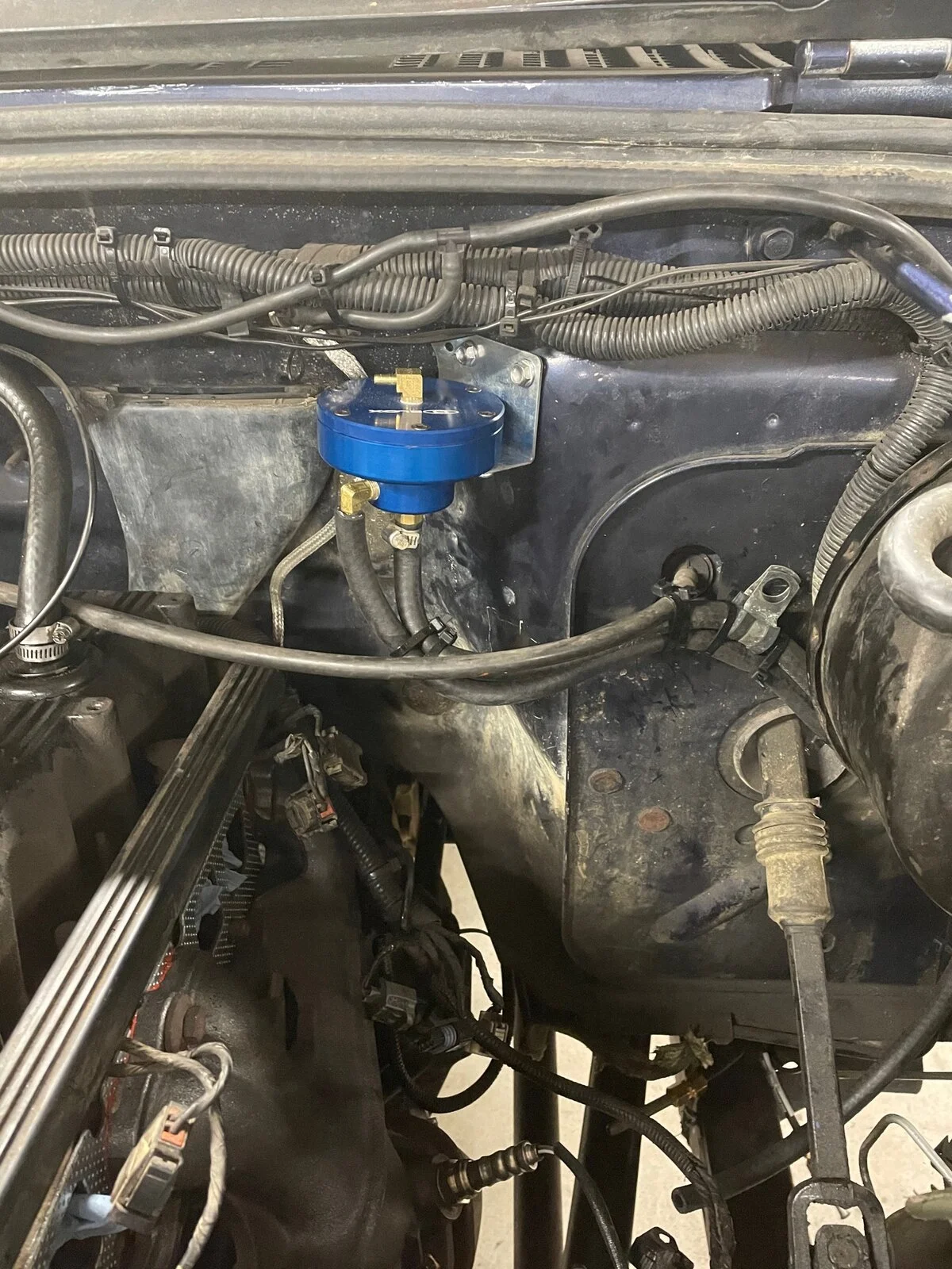

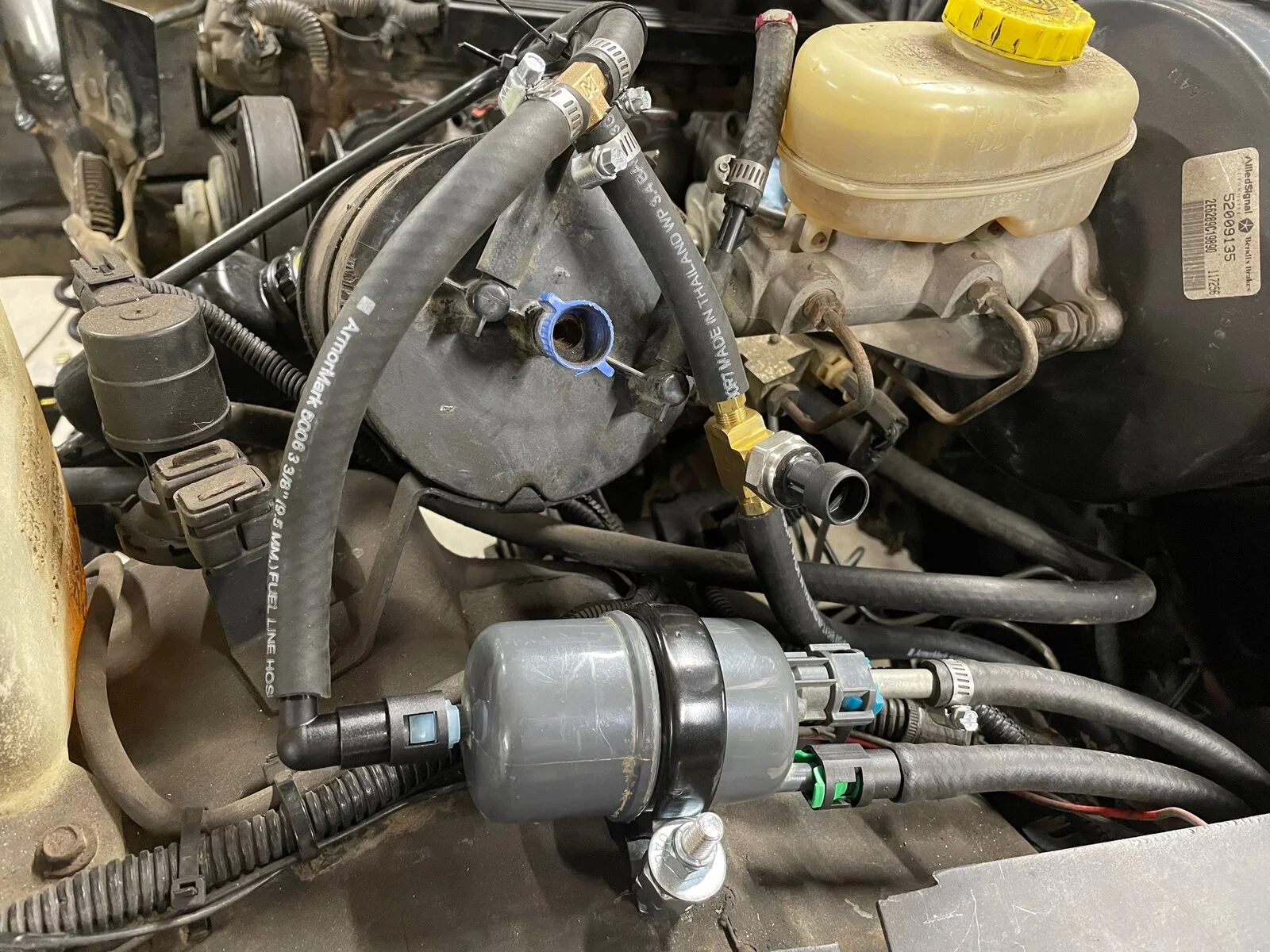

Lastly I installed a boot gauge and electronic inline fuel pressure gauge.
SOOOOO... CURRENT STATUS: waiting on a few fuel line adapters to have it running again.
I installed some 30lb fuel injectors a few days ago

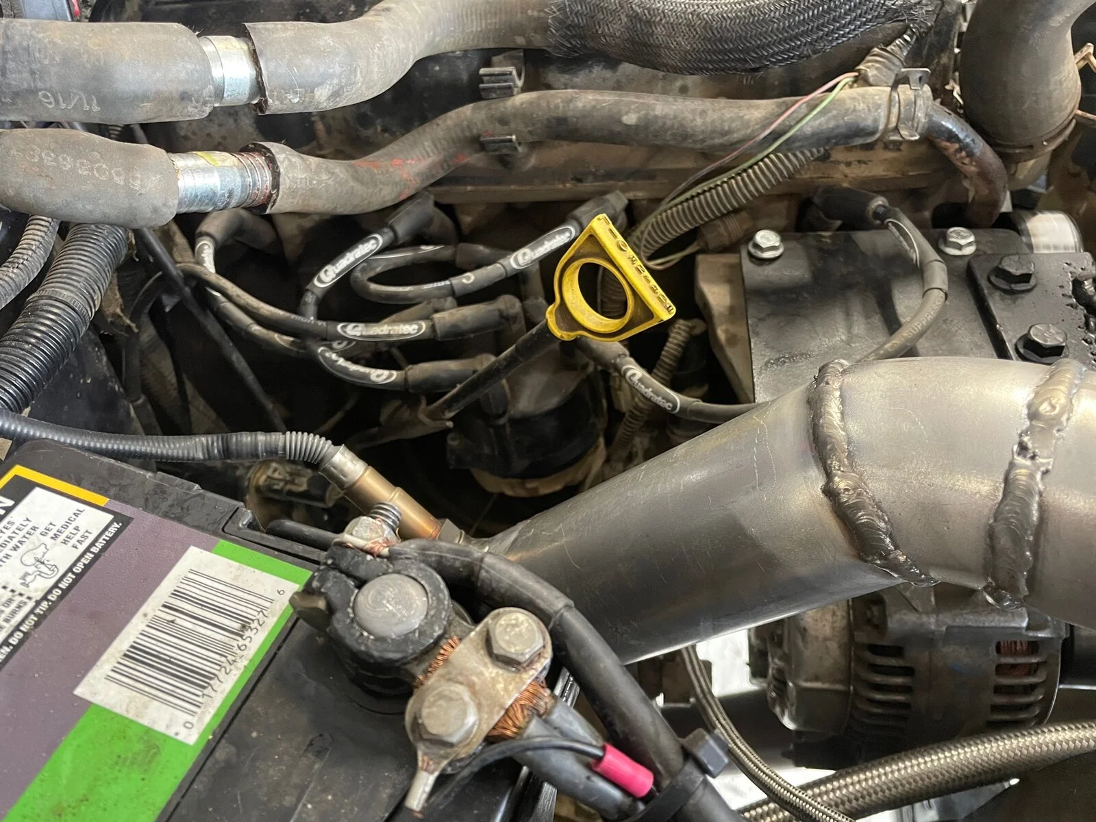

I am working on the same project. I Installed a 4.7 diode from the ground wire to the signal wire on the factory map sensor. Blocks the reading of the extra air making it to the ecu. The ecu only gets the max allowable reading of 5.0v which prevents the jeep from going into limp mode.
