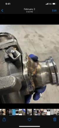

So... I bought some 2.5 pre bent exhaust, some 2.5'' V band adapters, grabbed a buddy and slapped a few nasty welds to just hold it in place and BOOM its kinda in place. I used some 1/2 round stock and a plate mounted where my AC would be if the original owner wasn't cheap and skipped that option, to hold the turbo/exhuast in placed...but still able to flex/move with the engine.
I did have to buy multiple flanges/mounts simply because I did not under stand turbo lingo. Several "ebay special" parts were VERY cheap, and I get why. I had a couple wrapped flanges, that I had to have sanded down, and a few V bands that did not match up, so I had a buddy of a buddy tig weld the correct one on for me.
