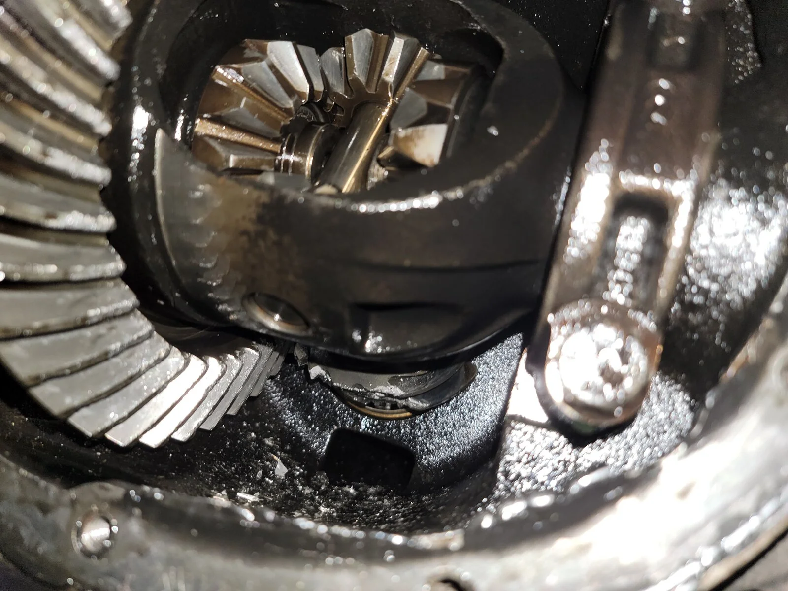

Right now I'm waiting on parts to arrive. I have the rear end repaired and have driven it some to check out the engine and such before I turbo it. I also need to do some baseline dyno runs here soon before I begin.
