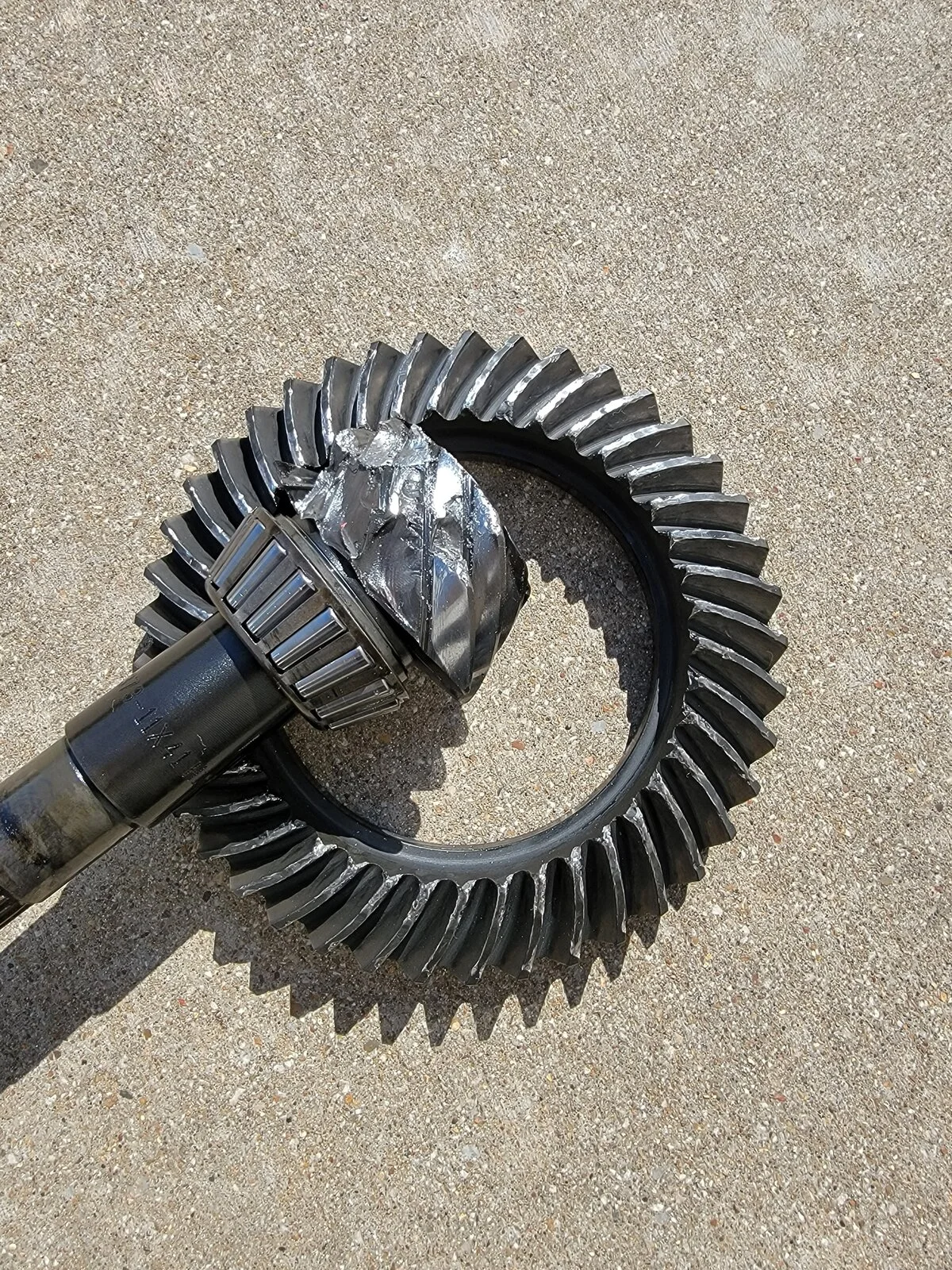

Just noticed this, that's No Bueno!![]()
That's just the "coast" side of the pinion. It's government mandated for fuel mileage
Ahh...less rolling resistance!That's just the "coast" side of the pinion. It's government mandated for fuel mileage![]()

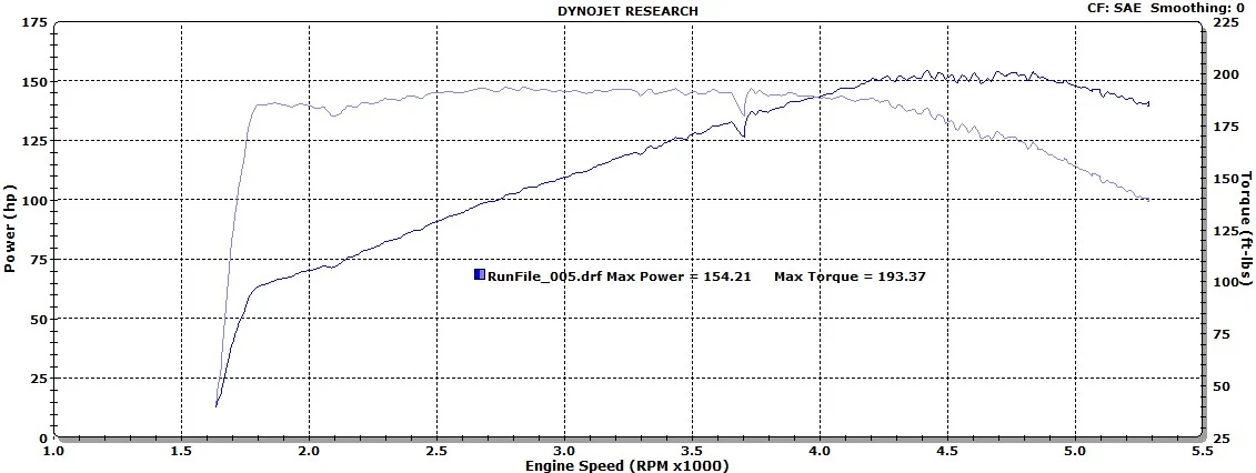

I believe in this kit happening.It was such a nice day today I put it on the dyno and did some baseline pulls. It actually made some pretty good power for the age and the miles.
Stock PCM no HP tuners yet.Did you make the dyno pulls with stock ecm and a hp tuner?
Wow so it makes max torque right off the bat. This is interesting because I always though I needed more torque to make the 42rle work in OD, but that graph makes it look like HP is the key. No wonder driving around town is so bad I'm making less than 100hp under 2700rpm!!It was such a nice day today I put it on the dyno and did some baseline pulls. It actually made some pretty good power for the age and the miles.

It would be interesting to see the bump with NA and a tune before the forced induction.Stock PCM no HP tuners yet.

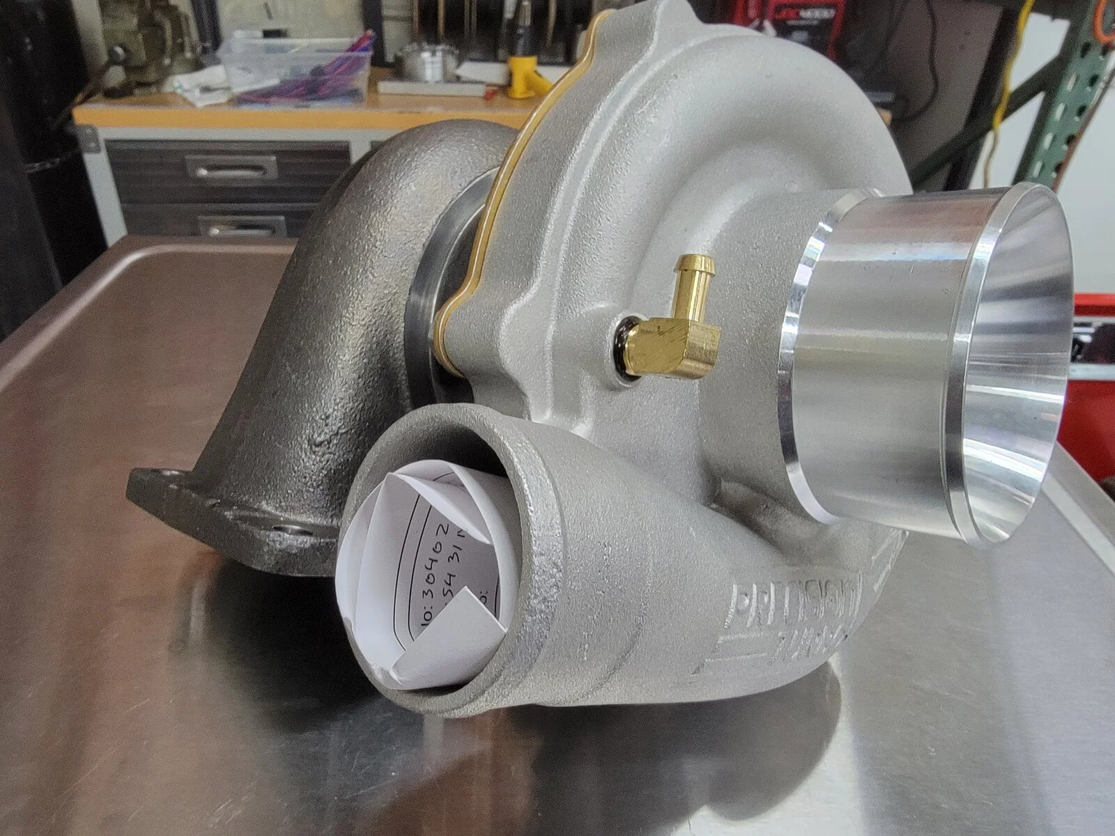

Let us know what comes of this. I’m also very interested.Turbo showed up today. I'm still waiting on the wastegate and a few other little parts before I start assembly.
Mmmm precision turboTurbo showed up today. I'm still waiting on the wastegate and a few other little parts before I start assembly.
