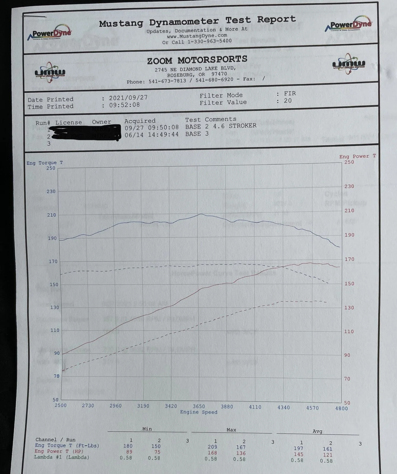

I've seen a few references to the stroker power band being displaced to higher RPM vs a stock 4.0. Here's my '97 stock 4.0 vs a Golen Stroker in the same TJ w/ an AX-15, 4.10 gears on 33s. The data is from a Mustang dyno. Per Golen's recs the stroker is using the stock '97 tune. To me, they seem fairly parallel on paper and in real life.
Indeed…and the ability to place peak power in a more appropriate range (from what I’ve seen/read about the strokers).
That should primarily be dictated by the cam profile. Apples-to-apples, a stroker version of a given engine should produce more power while gravitating toward a lower RPM range. If 4.7 strokers have a reputation for putting the powerband in the upper RPM range, then I would assume that's the builders looking for a hp number for advertisement reasons.

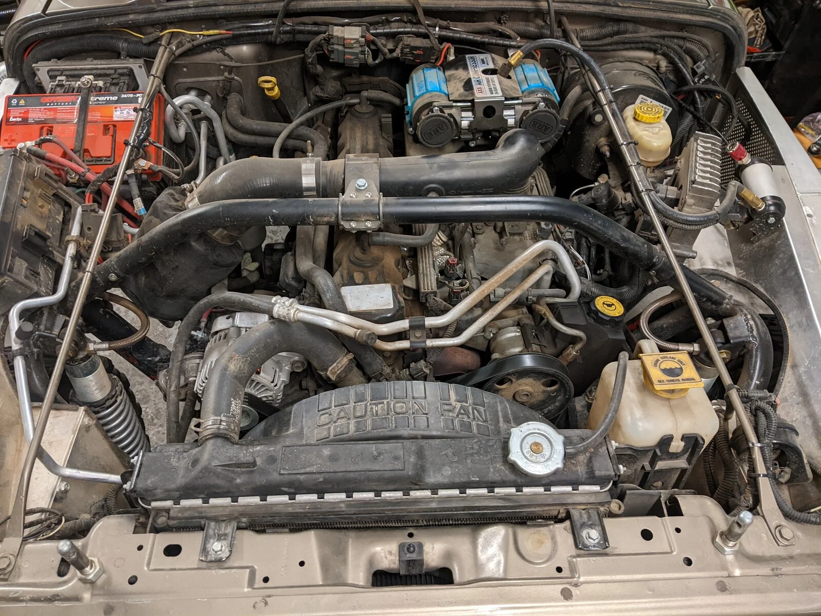

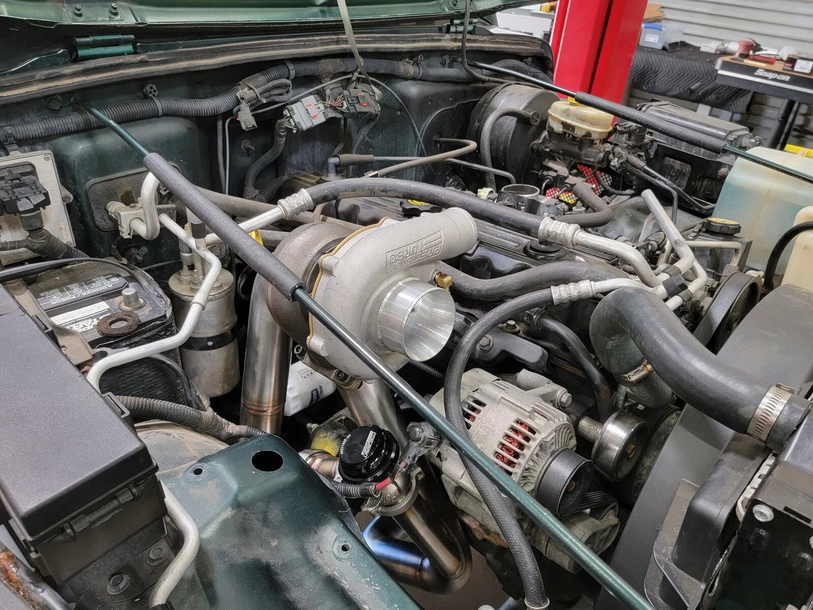

Can you move it back a bit I have a coilovers brace occupying that real estate 😬
I pushed the turbo back as far as possible, but the AC accumulator is preventing the downpipe from moving back further. The turbo is rolled in towards the valve cover a bit as well. How do the coil over tubes run?
It's typical for the coilover setup to run a crossbar in this general vaccinity. Mine is basically inline with front valve cover breather. For me in western wa I'd probably sacrifice AC for turbo powah. Or I could probably make a brace that fits like exactly over the turbo intake.
@mrblaine I know you have re routed AC stuff could the accumulator be moved to near the grill with new lines?
Looks like lots of room available for a turbo.
would it be easier to modify your brace to bring it more forward?
I wonder if you couldn't go closer to the front fender and up towards the hood, kinda next to the alternator where the OEM air-box was, but all that heat...... probably cook the spark maker.
Maybe towards the valve cover and up close to the hood? piping would get curvy though.
