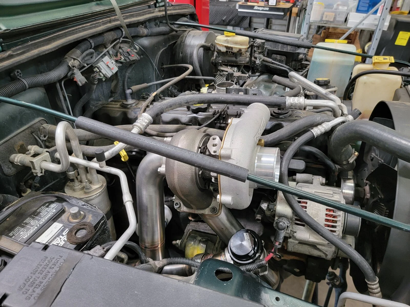

Turbo Kit Test TJ
It's typical for the coilover setup to run a crossbar in this general vaccinity. Mine is basically inline with front valve cover breather. For me in western wa I'd probably sacrifice AC for turbo powah. Or I could probably make a brace that fits like exactly over the turbo intake.
@mrblaine I know you have re routed AC stuff could the accumulator be moved to near the grill with new lines?
Ah, I see. It might be close. The turbo inlet is pretty much inline with the front valve cover breather.
Reactions: B00mb00m
I wonder if you couldn't go closer to the front fender and up towards the hood, kinda next to the alternator where the OEM air-box was, but all that heat...... probably cook the spark maker.
Maybe towards the valve cover and up close to the hood? piping would get curvy though.
The factory airbox is going back in to feed the turbo. It looks like a lot of space right now, until everything gets put back.

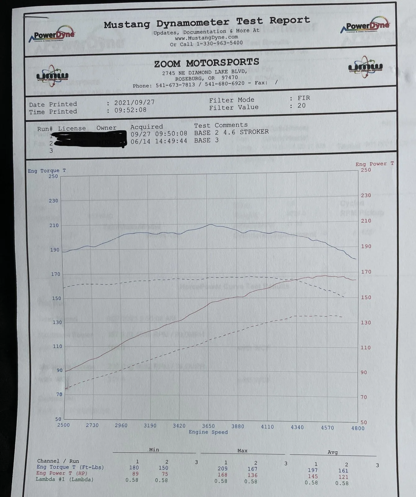

I've seen a few references to the stroker power band being displaced to higher RPM vs a stock 4.0. Here's my '97 stock 4.0 vs a Golen Stroker in the same TJ w/ an AX-15, 4.10 gears on 33s. The data is from a Mustang dyno. Per Golen's recs the stroker is using the stock '97 tune. To me, they seem fairly parallel on paper and in real life.
I haven't heard this said but if anybody did they have zero clue what they are talking about.
Reactions: Rickyd and Woodrow
I’ll be interested to see if there is enough space for steering/tranny coolers that always seems to be the problem with turbos.
I am enjoying watching your thread.
Me too, this thread is very interesting. I'm looking forward to the upcoming discussions reg. packaging everything.
Are you going to do the ECM tuning yourself @Jezza ?
@Grover728 are you watching this thread?
I’ve seen videos of guys building strokers and their dyno tests provided peak numbers way above my usable rpm range.
I don’t know about comparing it to the stock 4.0 I just know when I see those peak numbers I don’t care bc I want something more aligned for my uses and I don’t run above 3k very often.
Someone mentioned the cam which makes sense to my little brain, but I forgot more than I ever knew when it comes to that part of the engine.

Forget peak, look at the average area under the curve. For the stroker that @Woodrow posted earlier, you can see the whole curve moved up. That will be a difference you can feel across the whole RPM range... Which is what you're looking for.
I hate to talk about the butt dyno much because it’s totally subjective. However, I do enjoy driving my TJ with the stroker a lot more than the objective but underwhelming peak dyno numbers might lead you to believe.
I understand it’s moving up but wouldn't I want to maximize the power in my usable range? As in, move the peak curve into mid range or even to 3,600 to 4k rather than around 5k?
Disclaimer: I’m a dumb dumb trying to understand this better so I appreciate you going over this.
This makes sense considering the curve appears to be similar to the stock 4.0L but with more power.
The only thing that scares me from being all in on a stroker is the potential for reliability issues. I’ve read that there are ways to mitigate that concern but I need more education on the subject to know what is good info.
You need to compare the two dyno charts (stroker vs stock) and the stroker will make gobs more power at lower rpm compared to a 4.0. Doesn't matter where peak power is. More down low is more down low. Strokers in general shift the entire power band to the left without changing peak power figures all that much unless you do stuff like headwork, bigger cam, etc.
That ties in with another misconception I hear all the time about turbos being bad for low end power. Yes they don't give you off idle power like some kinds of superchargers, but they don't HURT power there either. If you need more power at 1200rpm on the trail, gearing is your issue and a turbo/supercharger won't fix that. Most people need more umph 2200rpm+ i.e. street driving or trying to keep wheel speed up in mud.

Ahh I didn’t know that head work could effect where the power is made.
Very much so. Small ports, within reason, lead to better velocity and volumetric efficiency down low while sacrificing breathing capabilities when more air flow is necessary, i.e. larger displacement and/or higher RPM. The reverse of that is also true.
