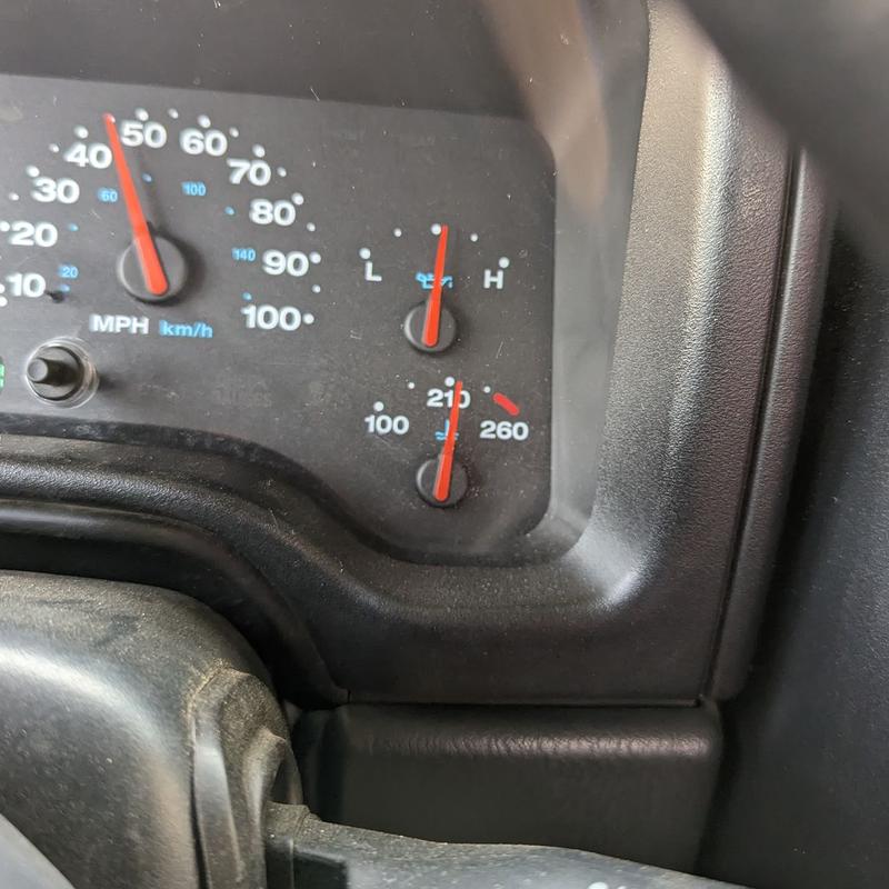

AC at max doing freeway speed, I'm right about the middle of the 2 on the OEM temp gauge. At a long stop light, it may creep up to the 12 o'clock position, but eases back down as soon as I'm moving again. That's at our current temps here in the Phoenix area.
Only time it goes past 12 o'clock is if I'm trying to maintain highway speeds pulling a long, significant grade.

229 is not normal, but what does the dash gauge read in comparison?
Do you have an OBDII reader to read the actual temp from the PCM?
