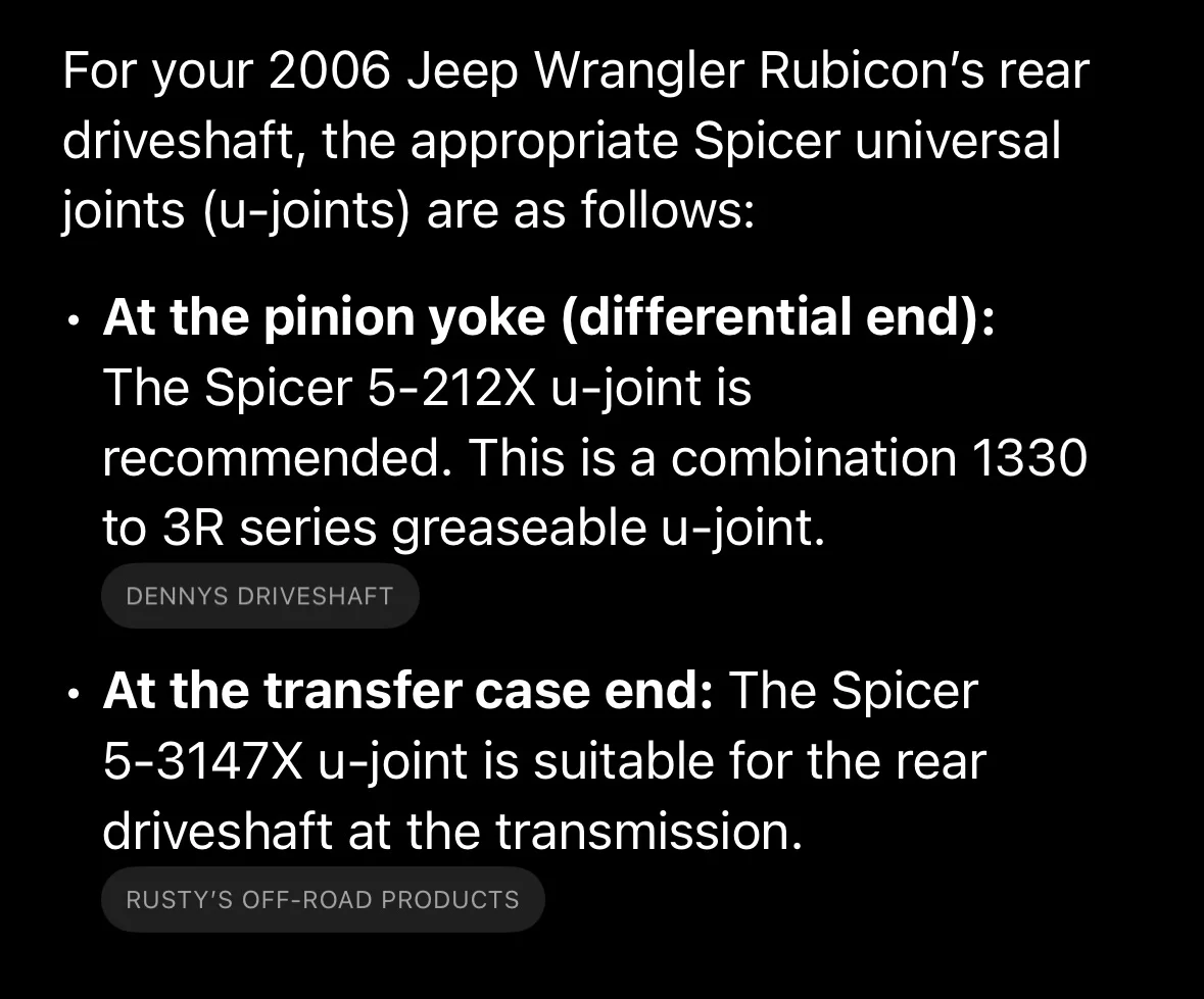

Stretch97 (Formerly Duner) Supporting Member Joined May 6, 2020 Messages 618 Location Buffalo, New York Mar 29, 2025 #43 Weasellee said: A little help? Click to expand... Not spicer but this is what’s on my dads, maybe you can equate this to spicer. I asked chatgpt, try those numbers
