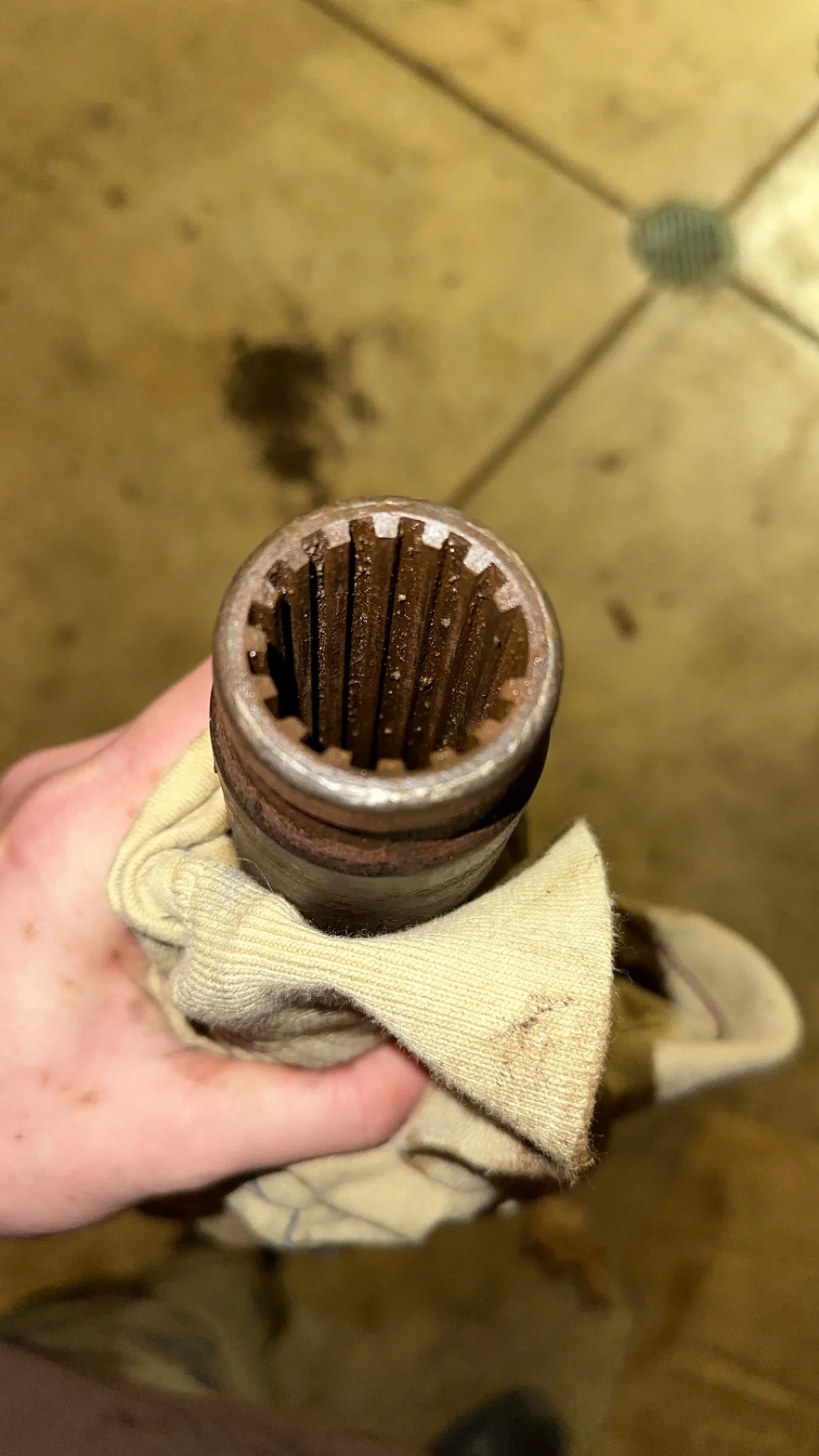

Took off the splined end of my front drive shaft to replace the boot. Any idea why there’s a missing spline?

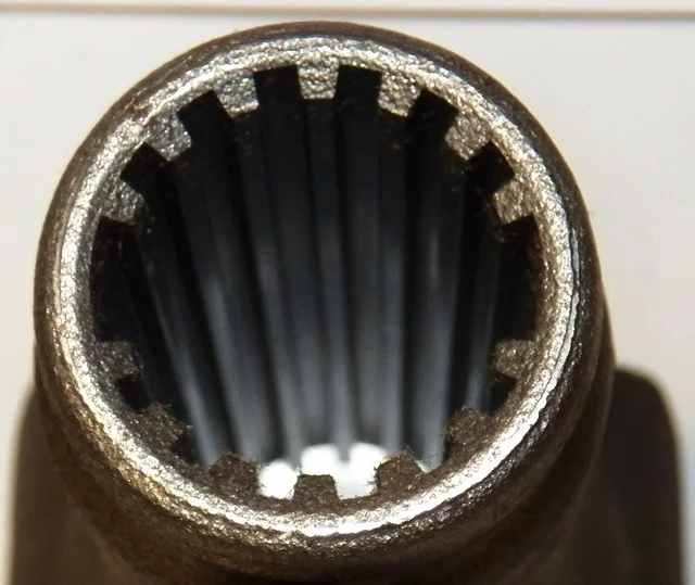

That is what some call keyed or double spline. It is commonly used for mid ship (carrier bearing) applications so that the installer does not install one half of the driveshaft 180 degrees out. No big deal using them on regular shafts.

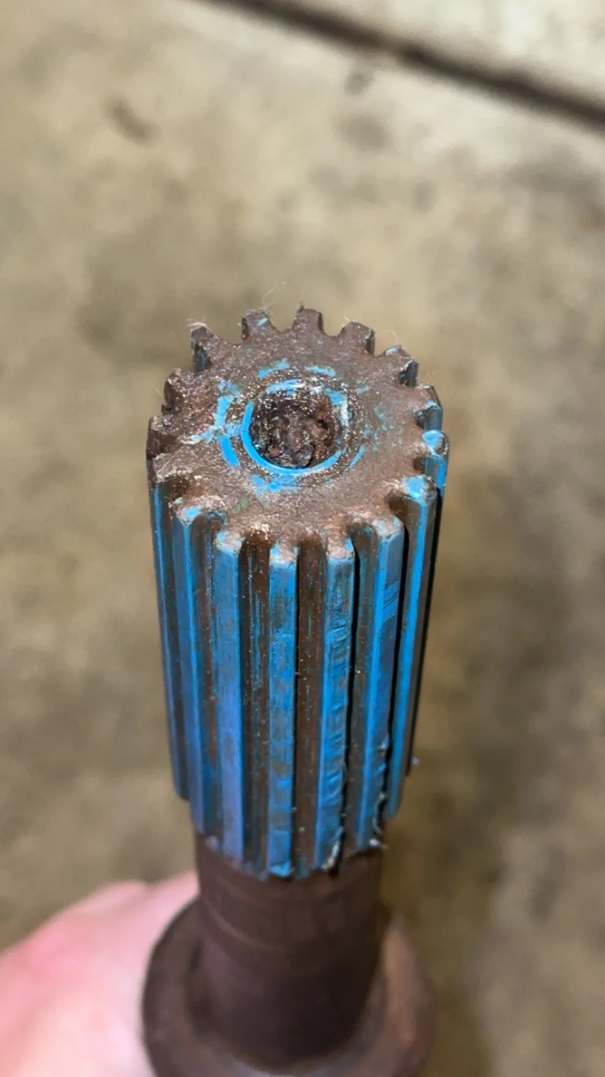

Can you get it get recoated? My double cardan on another thread I posted is bad. Should I just get a new shaft lmao
No on recoating. Yes get a new shaft. Not cost effective at this point to try and repair.
