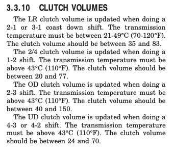

Looking at the FSM, looks like I made one mistake on the clutch apply section:

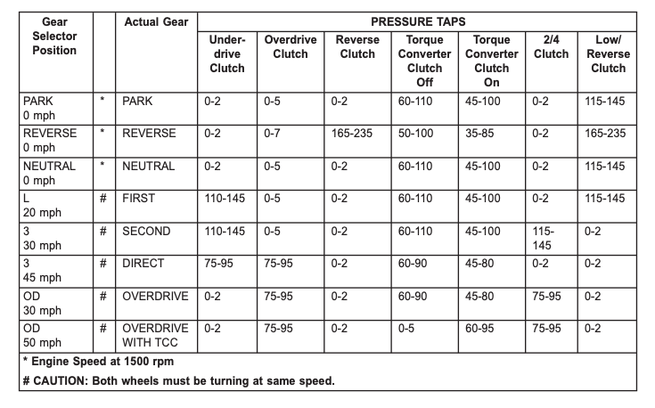

Regarding the pressure tests, I don't really know where they're getting 50, but also 100 could also be out of spec, they didn't really say what pressure they were testing.

They are saying it’s the 2-4 clutch. It’s supposed to be around 54 and it keeps dropping between 6&9
Their write up is helpful, it corresponds to the troubleshooting steps in the FSM. If it's really just the 2/4 clutch or the seals in and around that subsystem, then a rebuild would fix it. I've never actually rebuilt one of these, but I did a quick scroll through the overhaul section of the FSM. It looks like you need a few special tools, which is unfortunate.

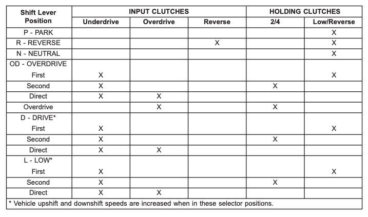

For it to be the issue, it would have to be responsible for the 2-3 shift as well as the 3-4 shift. In the former, the 2/4 is unapplying. In the latter, the 2/4 is applying. So it would have to be slow to do its thing in both directions. It's hard to identify a flare in a downshift since the RPMs are increasing anyway, but it would be nice to know if it was also flaring on the 4-3 downshift and/or 3-2 downshift.

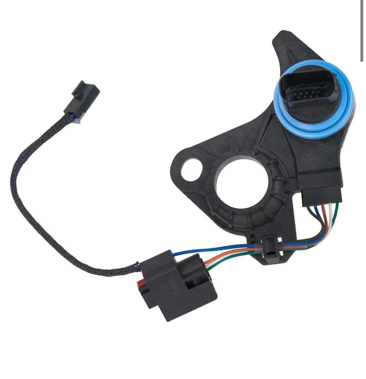

Are you aware of a Variable Line Pressure Solenoid? Does the 42rle have one?
The guy at the shop said that a certain part of the harness sits on top of the tranny and from what I read it’s called the variable line pressure solenoid.
