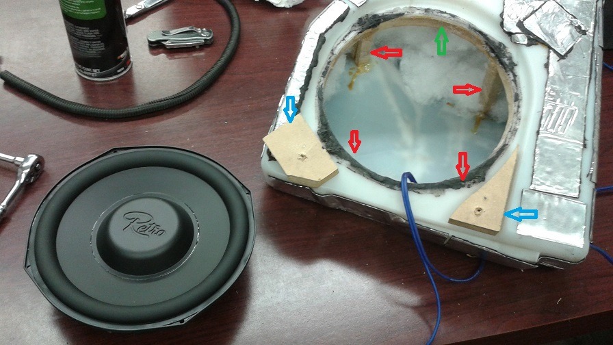

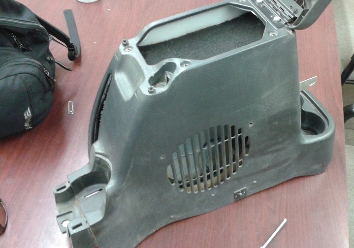

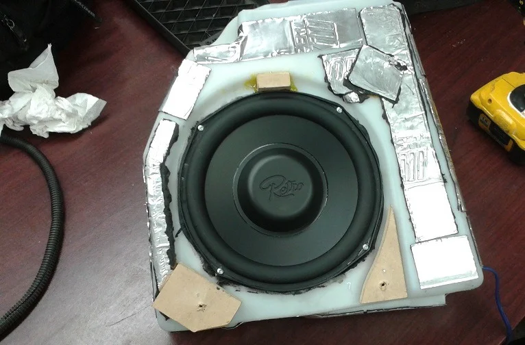

@JMT mounted a slimline powered sub in his back seat. I put a 8" slimeline sub in my center console. Had to do a little fab work to the console enclosure, but it worked out pretty good for me.

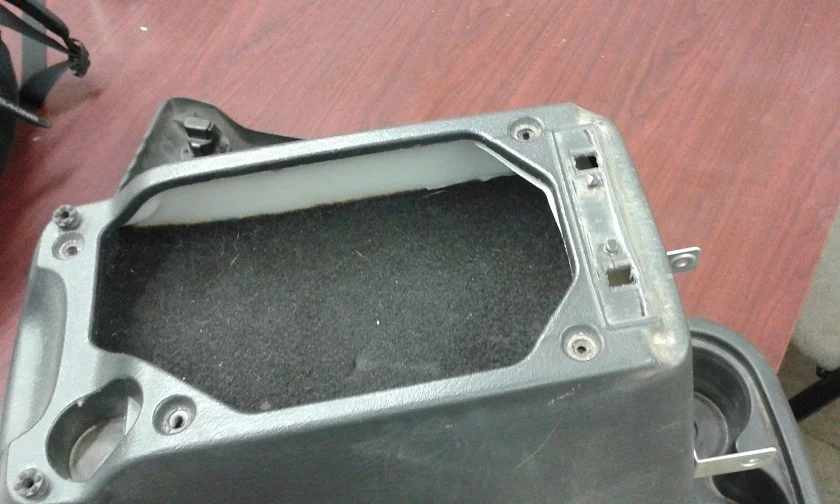

Ahhh, I was thinking of @JMT then. I did exactly what you did with mine.
Well, sort of. You have the factory sub console, yes? I didn't have the factory sub option, just an empty pocket for storage. I had to seal the top of pocket and reinforce the speaker mounting area for a 8" sub. End result was the same as you though. I powered it with a small amp similar to what you got, and mounted it under the steering column.
Yeah my TJ doesnt have the factory sub console and like you @bobthetj03 i have have an empty space for my center console. I think doing some fab work on the one i have might be the route i need to take because i have the beige interior and it would be a pain trying to find one with the same color scheme. Every audio shop i have taken to seem to scratch their heads anytime i make suggestions to them or any idea's on how to get better bass outside of the sound bar and stock front mount speakers. I do appreciate it though gentleman. Maybe @JMT will have some insight.
