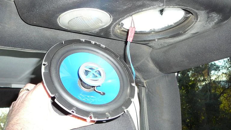

I have read conflicting answers on a 2005, I have read a "little" dremel work or they will fit but get drilled to the bar and need to use the polk grills as the oem wont fit?
Not sure. My 522s fit just fine with the stock speaker grills, so I'll stick with them! I can't imagine you'd notice much of a difference.

6.5" require either some trimming of the sound pods or just drilling new holes in the plastic and using the new grill covers. the factory 5.25's are recessed in the pods.
Here you can see the recess where the factory speakers would mount. I mounted these 6.5's in place, but wasn't happy about how well they were secured to the pods. I went back to the DB522's and factory grills. Sounds great!

A 6.5 will fit, some need some trimming, others do not. I had to get creative with screw placement with the Kenwoods I run. Honestly, a 6.5 isn't going to give you much more over the stock 5.25. The pod is just to hollow and thin, even when stuffed with polyfil. You want bass, get a sub.

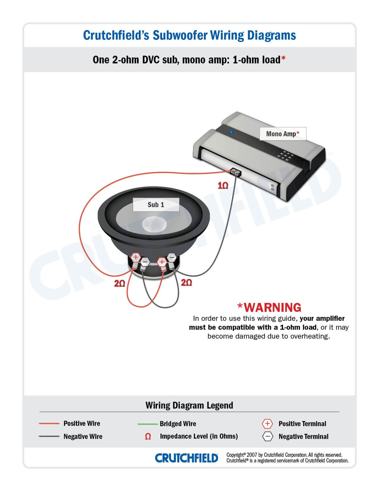

Chris, I finally broke down and got the goods, but didn't realize I would need to modify the console/housing for the Kicker sub. While looking it over and trying to figure out what I need to Dremel, I was also a bit mystified by their wiring instructions.
https://www.kicker.com/wiring-diagrams
Do you recall how you wired up the amp and the sub? I have both items exactly as you listed them and am ready to do this but want to make sure I get it right. Any help you can provide is much appreciated.
If you bought the exact subwoofer I did, this is the way I wired it:

Thank you. Yes, the exact items you listed are what I got. I'm just puzzled by the 4 wires that went to the factory sub, where do I land them on the amp inputs?
You disregard those wires altogether, they aren't used.
Your aftermarket head unit should have a subwoofer outputs (RCA) where you run new RCA cables from your new head unit to the new amp. That factory wiring that goes to the factory amp isn't used at all anymore.
