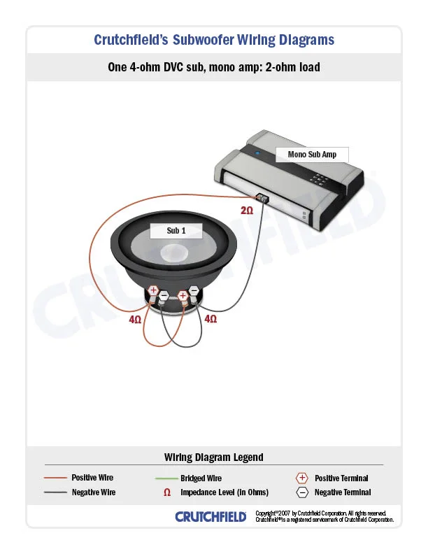

I got the dual 4 0hm.
I appreciate all the feedback. I’m pretty much illiterate when it comes to this stuff.
Perfect, so with the dual 4 ohm you want to wire in parallel (pull 2 ohms) with one of those recommended amps, the Soundstream or Cerwin Vega B55 Bomber. This is a picture of how it should be wired to an amplifier channel, whether or not it is a 1 channel amplifier or a 5 channel amplifier.

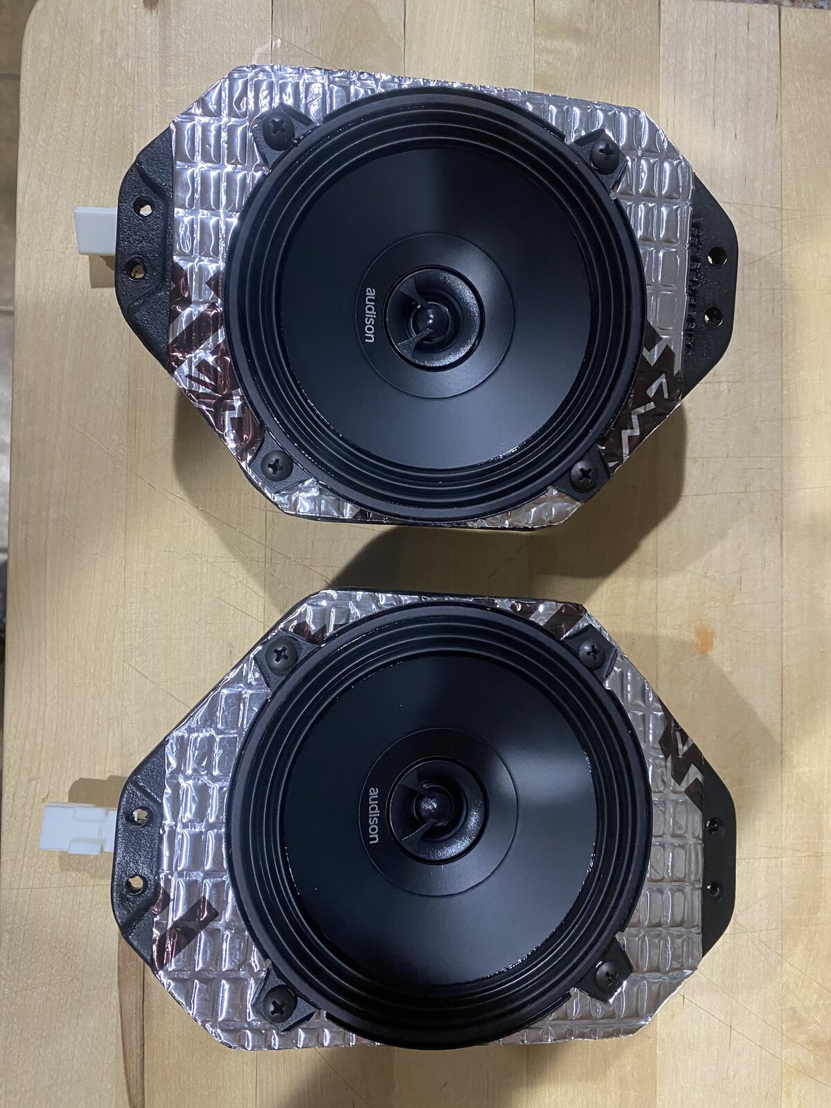

I installed the Audison Prima speakers today.
Because the surround is low profile there is enough clearance between the speaker and the support piece. When I turned up the volume I didn’t even see the surround move. That was my biggest concern. I’m happy I didn’t have to modify the dash at all!

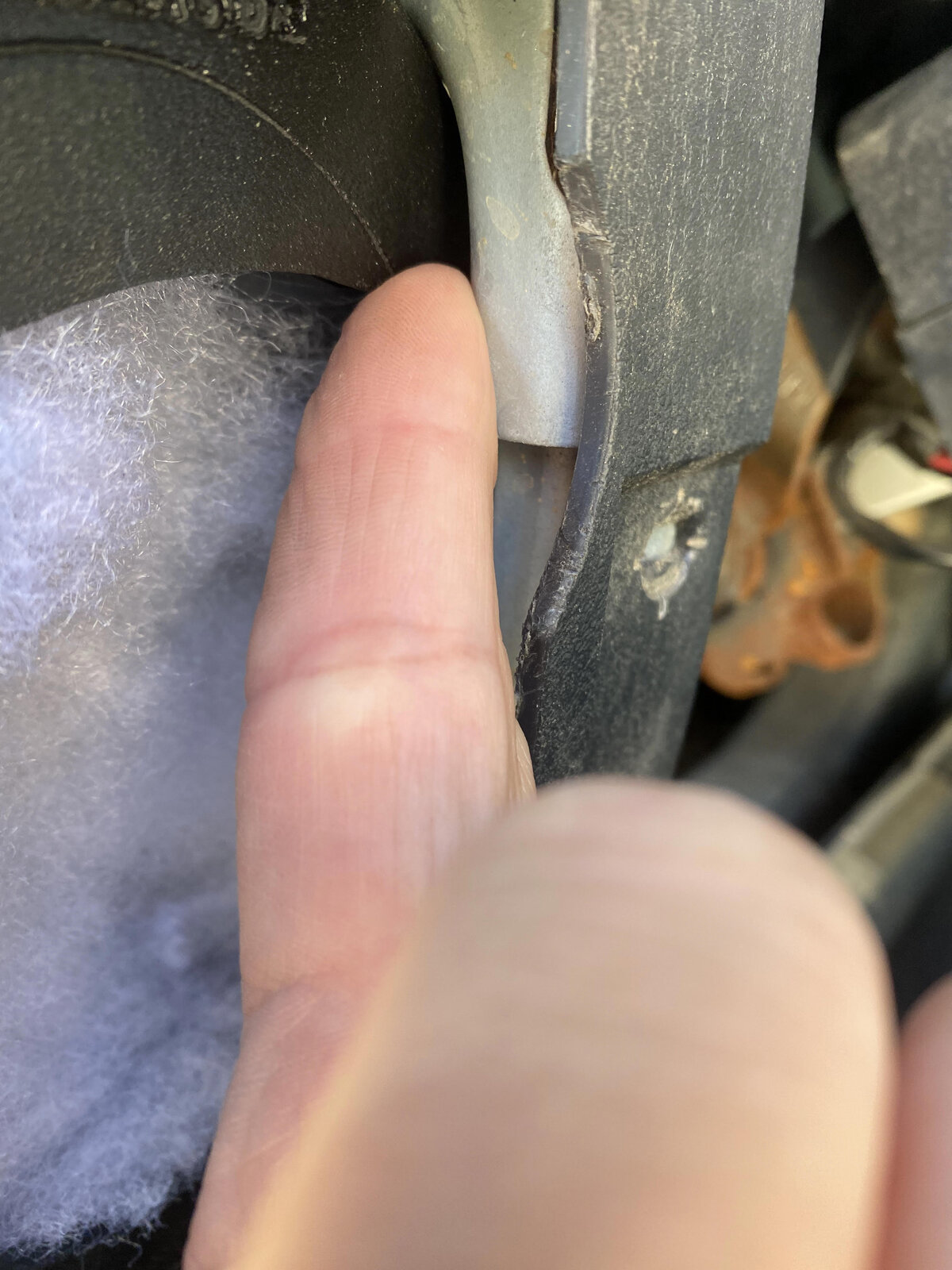

It’s hard to tell from this picture but there’s still about 1/4 inch of space between the surround and the support. I wasn’t really able to take Jeep for a ride to listen to them due to icey road conditions but they sounded pretty good in the garage!

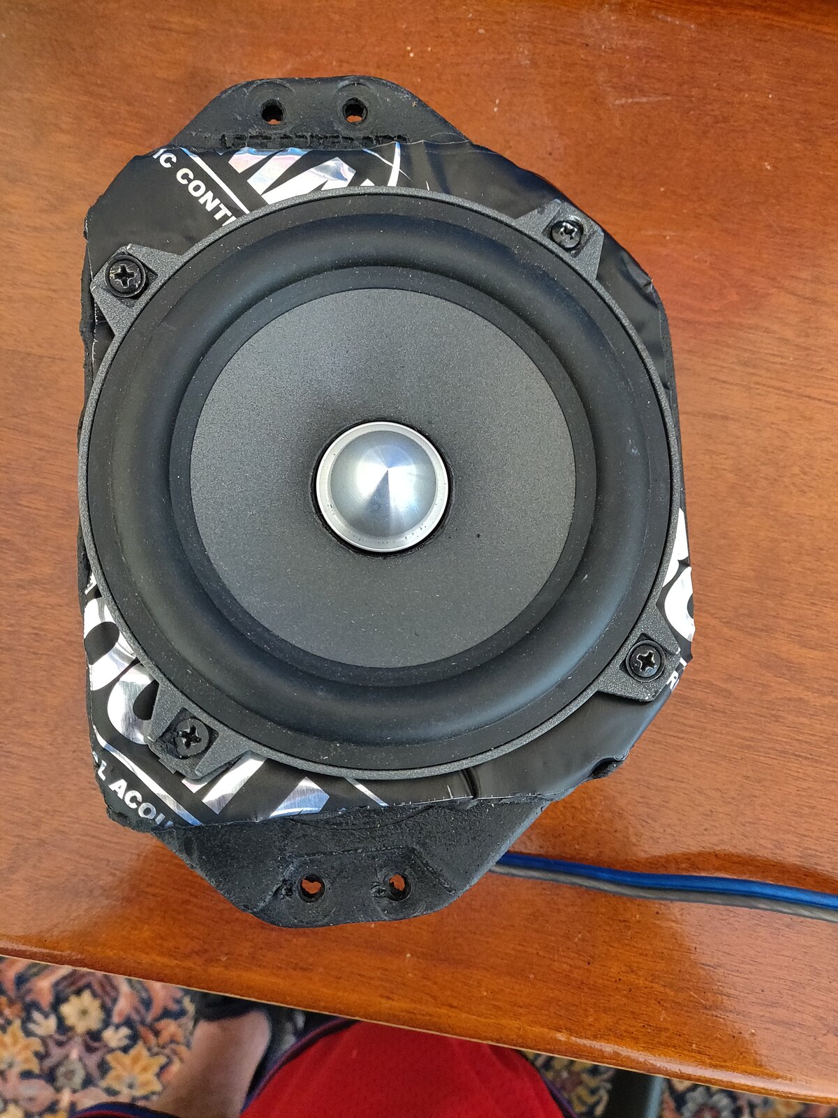

Hi, what speaker is that and how does it sound?
Thanks
That is an older Focal Polyglass woofer, not a coaxial speaker. I like it, but not as much as the Micro Precision 5.28 tweeters that play along with them.
