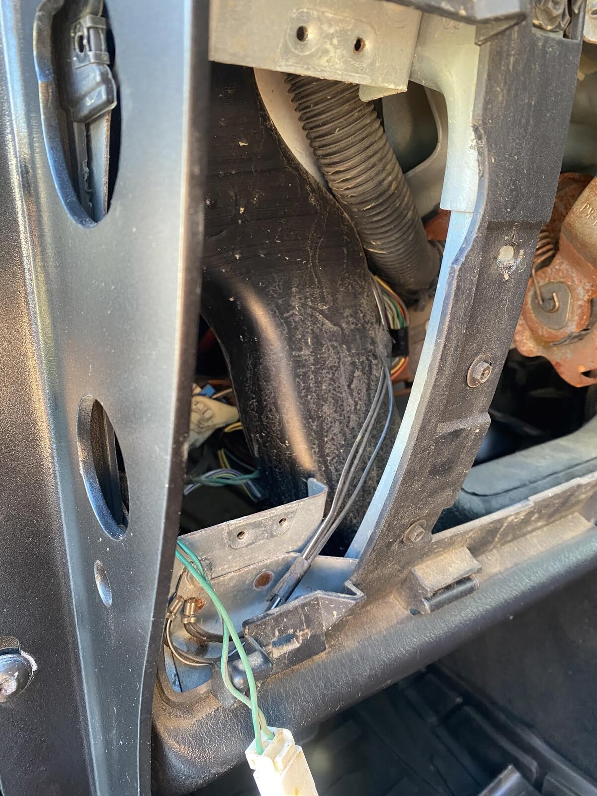

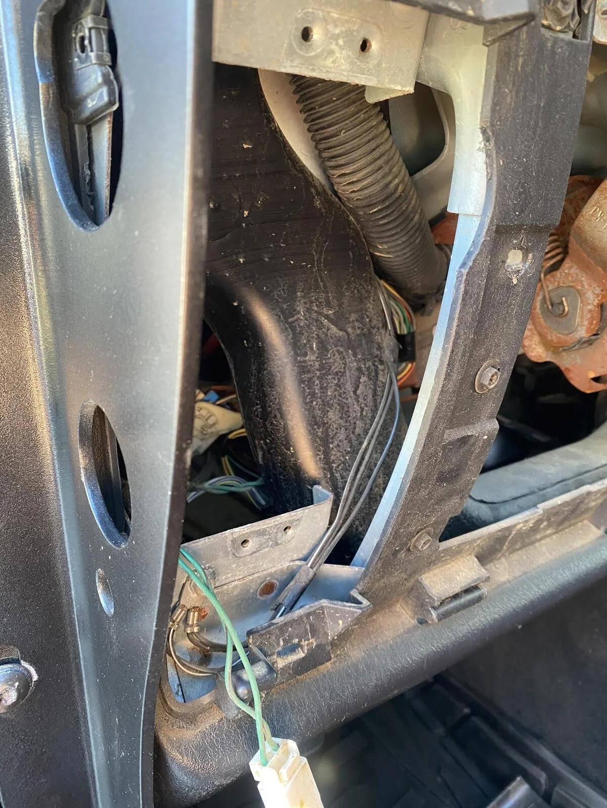

I was able to wiggle the existing speaker& pod out of the speaker bay. It was tight. There is no metal dash support piece in therer so I don’t have to worry about that. It looks like there *might* be enough room to slide a 5.25 speaker pod in there with the panel under the steering column removed. There’s a lot more room on the passenger side with the glove box out.
View attachment 222853I’m gonna give it a shot. I’ll buy the Select Increments dash pods first and make sure I can slide those in before I buy the speakers. That way it will be less to sell if it doesn’t work!:LOL:

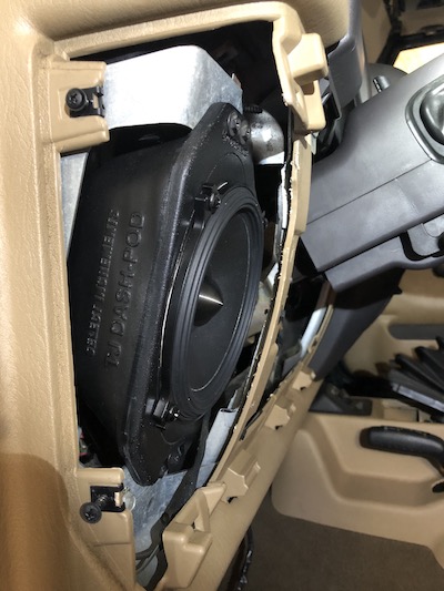

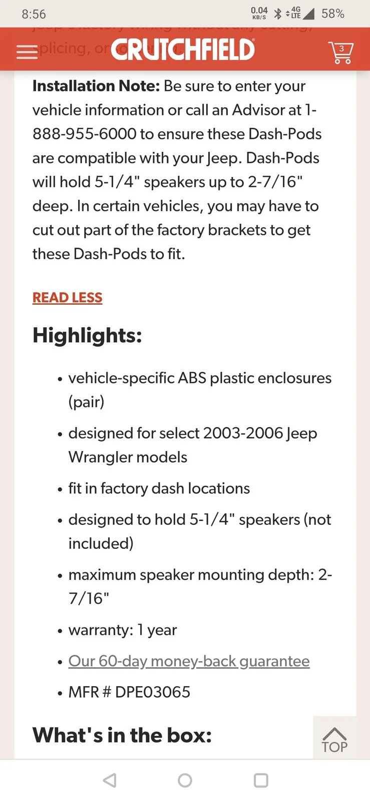

A few tips:
- the pods can only take speakers with a certain depth (crutchfield should be able to tell you this, but you'll need to call them and ask as I dont think its on the website). I bought a pair of morel coax that i had to return because the magnets were too deep
- I could have made the morels fit if I added a spacer to the front of the pod but that would have meant that I would have had to deal with the front of the speakers hitting the dash support.
- The support I had to trim is the one behind the dash that's there in your picture. It has a c-shaped profile (if you were to cut straight across) and I basically just converted it from a "c" profile to an "i" if you look, you can see it in the picture below.

A few tips:

Thanks for the tips. I had already considered the depth of the pods. Amazon has the size listed as 8 x 6 x 7 inches. I assume the 7 is the depth.
I see where you trimmed the support. That isn't the support piece I was talking about. You can see the piece I was talking about in the video below at the 4 minute mark. My Jeep doesn't have that piece on either side of the dash. I don't know if the previous owner removed it or what. There aren't any sharp edges in there so I don't think the pieces were cut out (like in the video).

Ok - I see that now. I think that brace was only there on certain years. I have a 2002 and it didn’t have that additional brace.

A few tips:

Mounting depth is on Crutchfield
