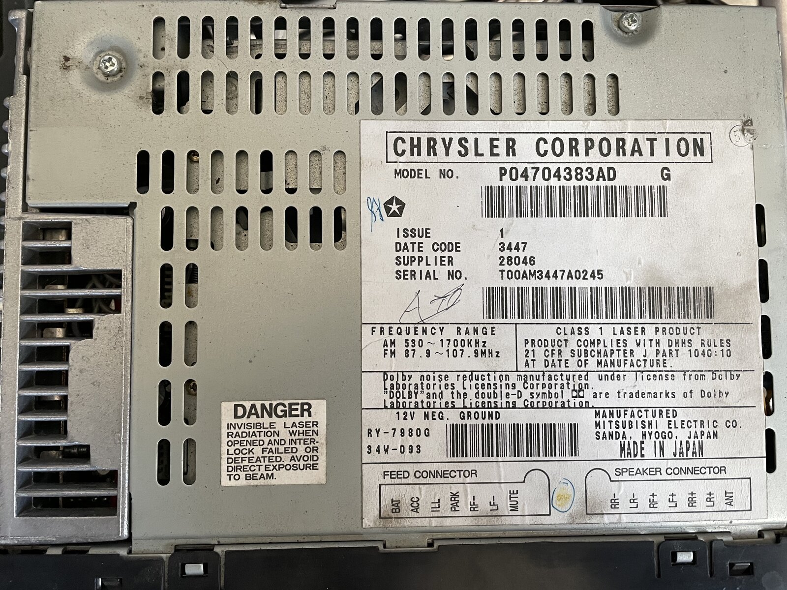

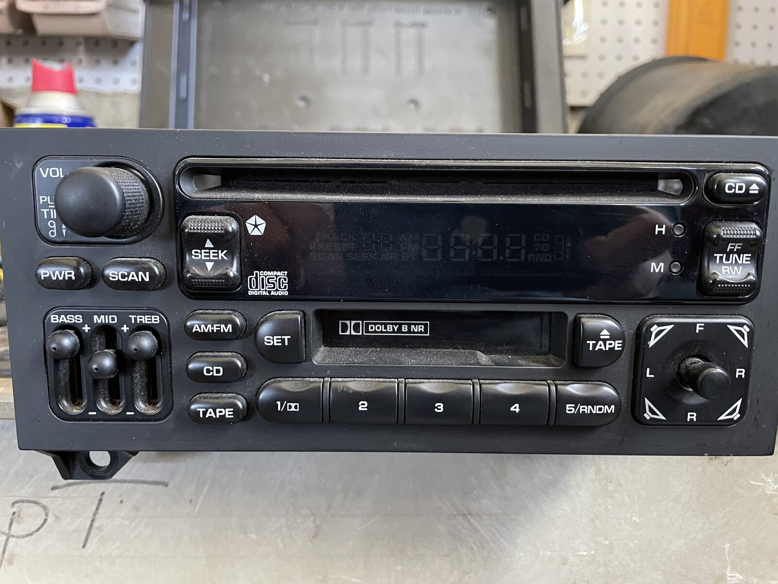

So I’m all stock with the exception of some Polk speakers in my overhead sound bar. I have the factory stereo with a factory subwoofer in the center console so I guess I’ll need a 5 channel amp to power that and 4 speakers? I’d like to figure out a setup without a bunch of wires running underneath the carpet. That’s why those small amps were appealing. I’m not an audiophile by any means, but would appreciate some better sound without drilling holes and running wires all over the Jeep. Thanks for your help so far

Thanks for that! The approach is the most important so you build what you want for the best price. A subwoofer would be a great addition to your system, and like you, I prefer stealth in the center console, and not in the rear space. Finding that center console is huge. Davey's Jeeps has a insert available, but not the center console. I have seen some on craiglist as well, so you should keep looking around.
Your system is solid as-is, check out this Kenwood amplifier with built-in bluetooth. You could then swap head units, and only need to solve for the subwoofer and mono-amp for that subwoofer. Another option is to keep your head unit and go for a five channel amp. More food for thought.

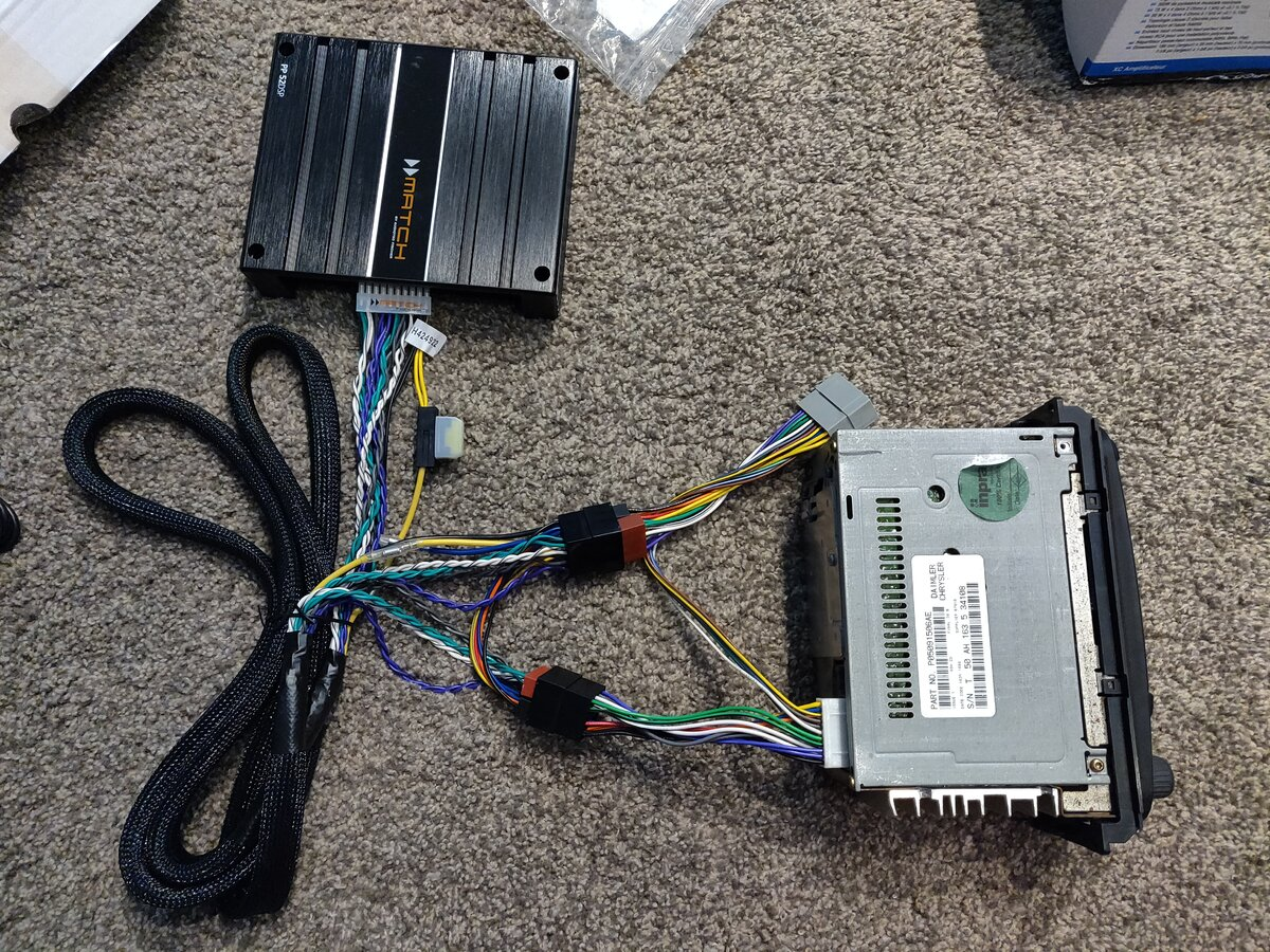

With an amplifier, it will need power and ground, so some wiring is needed. It is nearly impossible to find 5 channel amp, with built-in bluetooth, that is small enough to fit under the steering column, and also a reasonable price. It can be done, but pricey.
There is Match PP 62DSP that is ideal, but you will end up spending $1k on the amp and related parts. You are lucky being in New Jersey as I mentioned that audio shop, Unexpected Creations, who is an authorized dealer for Match, and can ensure the install goes well.
This is the amplifier I am thinking about, and I sold a similar one on this forum. Image of how it looks is below;
  • Simple Plug & Play connection to original sound systems using vehicle-specific adapter cables

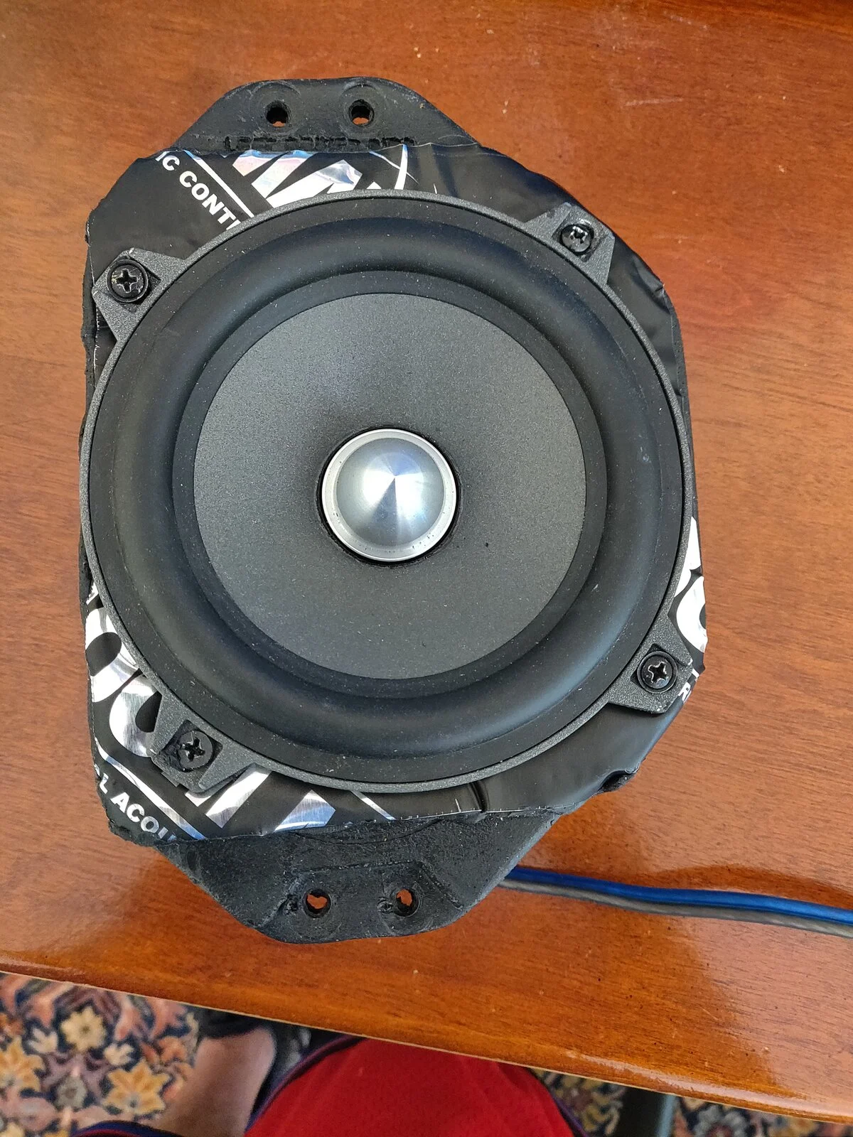

Planning my upgrade. Going to stick with factory locations to save space. Have you run into factory dash pods? My fronts seem to be a factory version of a 5.25 and a 1.0 tweeter in a plastic pod of sorts. Wondering if I should just replace the 5.25 part, add some poly fill, and keep the rest of the stock pod. Don't see too many references on the forum to changing up the front speakers when these factory dash pods are present. Must have been an upgrade to the open 4x6 most seem to be upgrading.
Interesting, can you post a picture of these aftermarket front dash pods?
Most members use the Select Increment pods. Here is a link to them, a and a picture of my 5.25" in them.

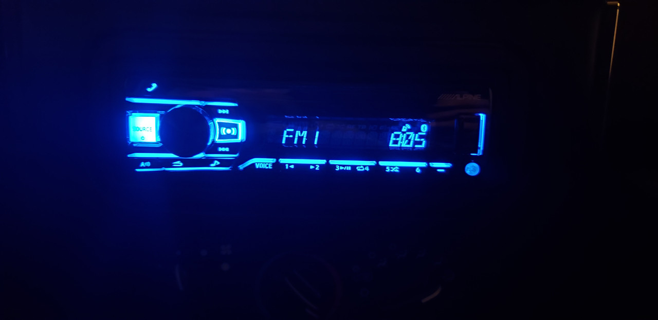

I also listen to CDs and have a Kenwood. It's solid and has great Bluetooth streaming. Unfortunately Kenwood HUs are hard to find as production slowed down during the pandemic. Crutchfield has a nice looking Alpine that would fit your needs.
There is a great car audio guy in Edison, if you live near there. He may have some Kenwoods in stock if you cannot find what you are looking for.
I have used Alpine decks for over 25 years now. I've got a UTE-73BT in my jeep now but it doesn't have a *clock* which turns out to be a key feature for me. I ordered the CDE-175BT yesterday and am looking forward to having CD capability again. And the 5V pre-outs don't hurt either. :)
