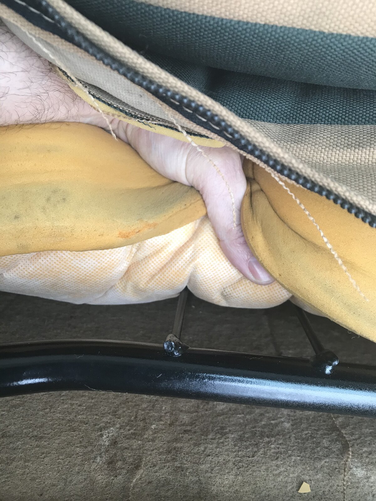

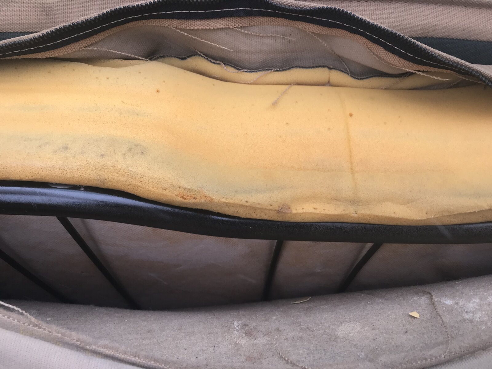

I was able to get the zipper open. This is what I am seeing in there:
It’s a metal base with a thick cushion sitting on top. Is this what you started with? Looking at your picks I was thinking I could slide some wood between the metal and foam and mount to the wood but it wouldn’t really add any clearance and I’m pretty sure there wouldn’t be enough space between the seat and floor.
No, your 97’ must be different than my 05’. Sorry, if you can’t see a way to mount it between the foam and bars then it probably won’t work.

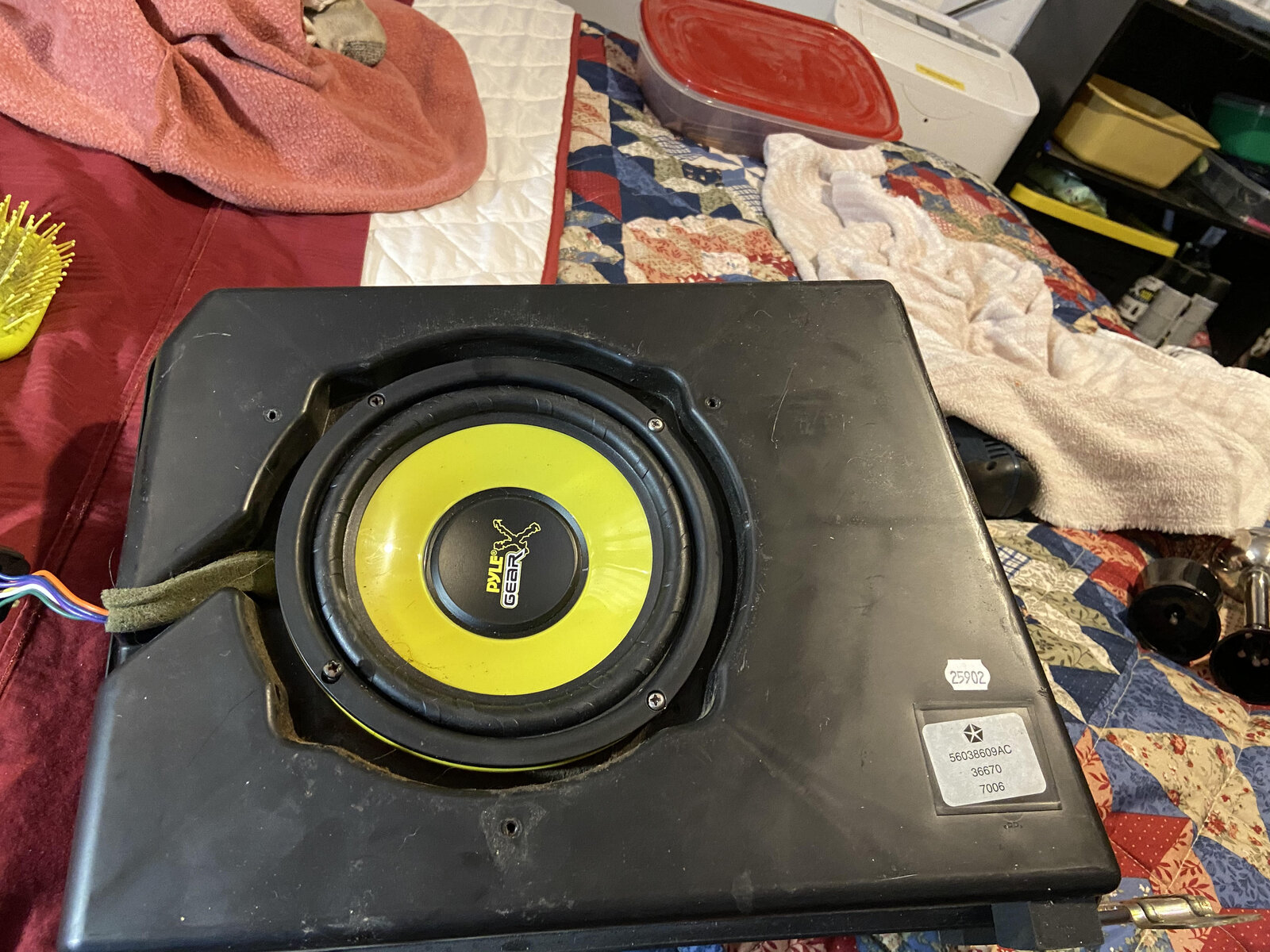

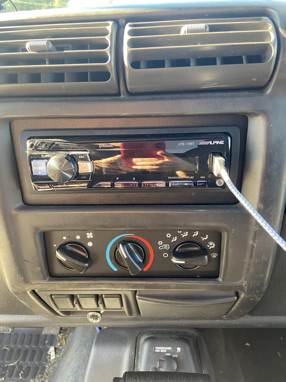

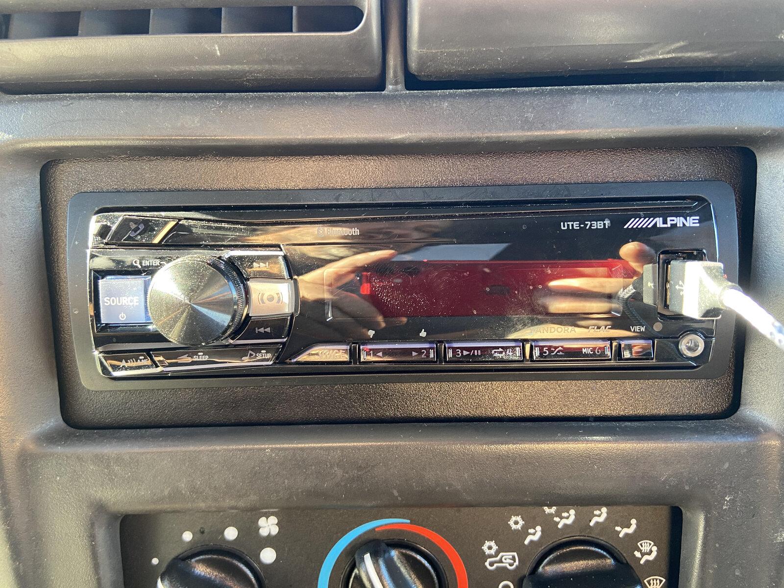

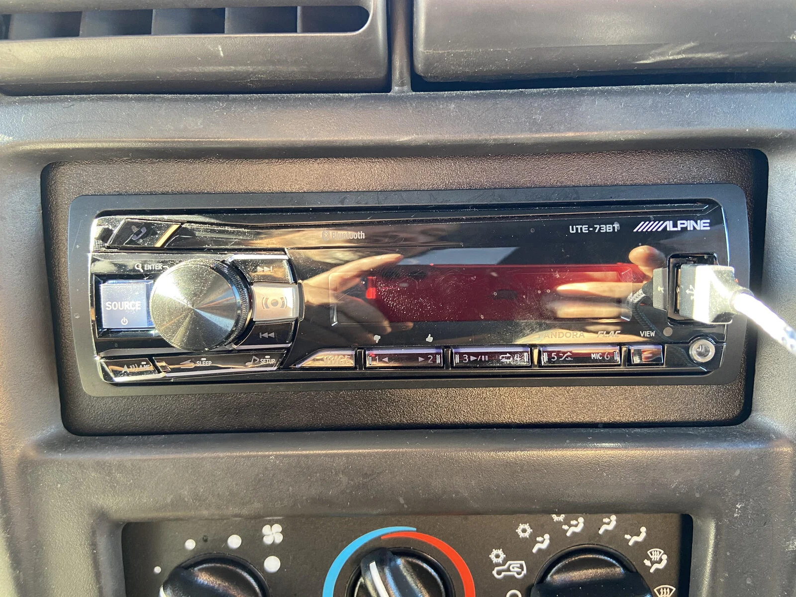

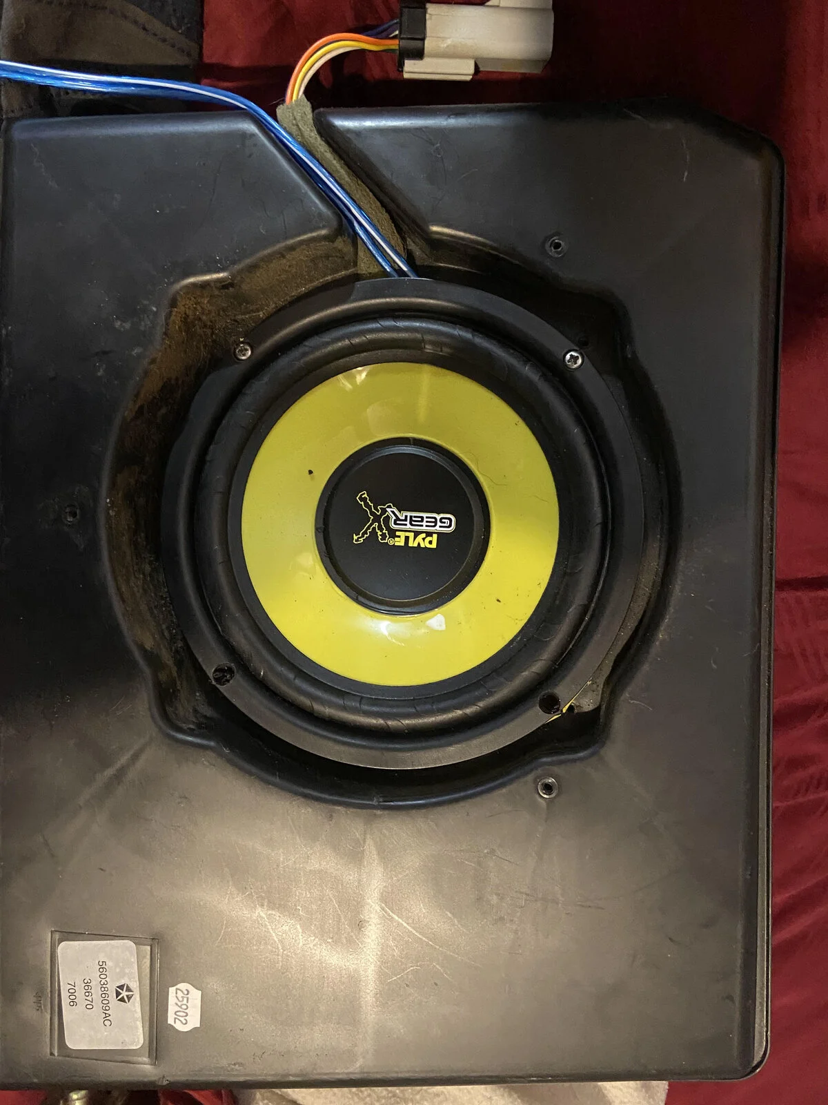

I have been reading these post and just wanted to let you all know what my setup is. Now don't get me wrong this is not the best system ever, but in my 2001 TJ Sport on the highway at 70-75 top down doors left at home, I can hear it clear and loud. As a matter of fact I have people in cars on the highway next to me can hear it.
Pyle 6.5 Inch Mid Bass Woofer 18.99 amazon almost a direct fit in factory sub in center
console screw holes did not quite match.
Pyle Hydra Marine Amplifier Upgraded Elite Series 400 Watt 4 Channel Audio Amplifier 40.99 i mounted under the rear seat
4x Polk Audio DB521 5.25 Inch Coaxial Marine speakers 147.49 amazon 2 in the speaker bar 2 in dash with adaptor.
Alpine UTE-73BT head unit 99.95 crutchfeild
also used speed (9) wire and 10 gauge amp install kit around 30. 00 together
all said it's under 400.00 and sound good
