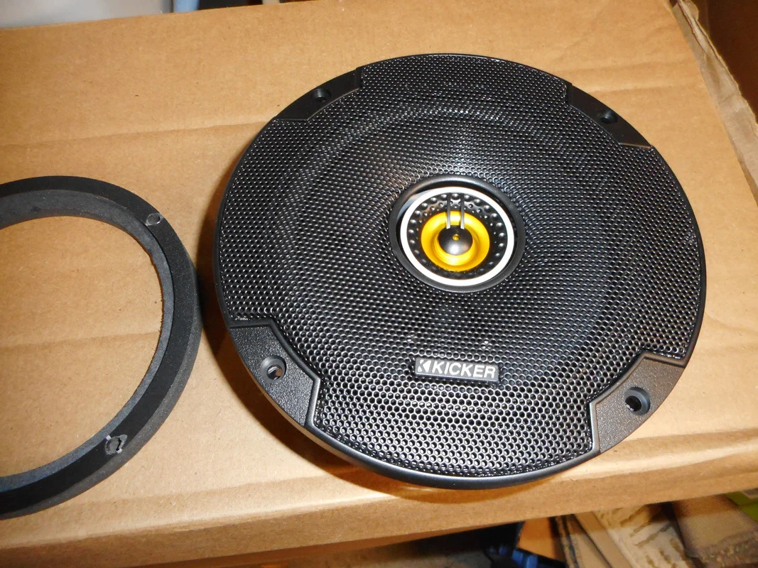

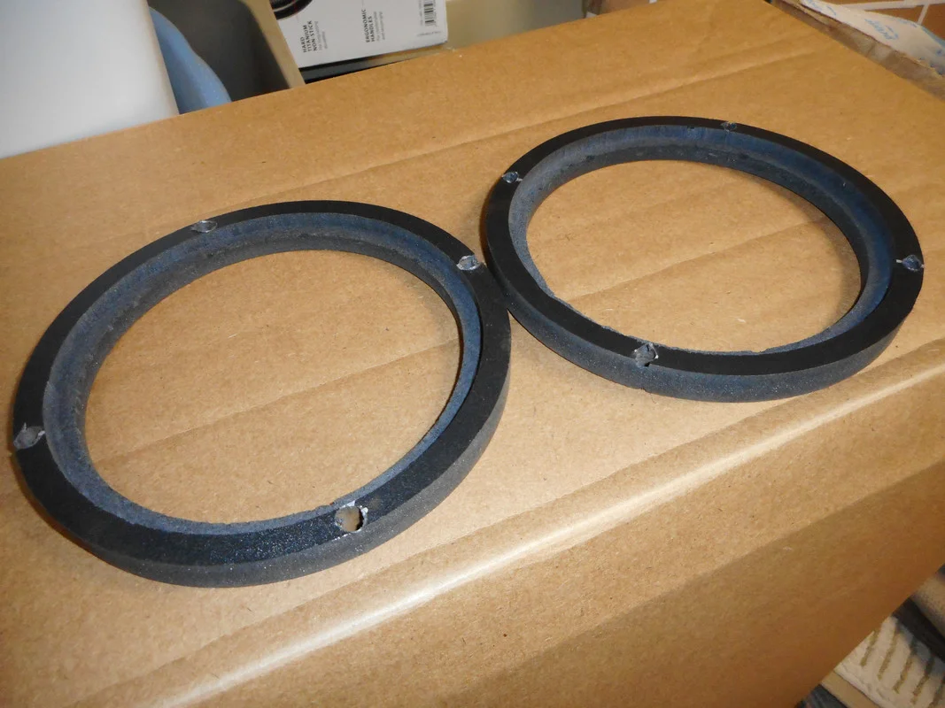

Chucked up the Rabbiting router bit in the drill press and relieved the inner edge of the 1/2" spacers so I can mount the 6-1/2" Kickers in the upper pods

Man these Kicker CS's have super clean sound compared to the 5-1/4" Sony Xplodes that came out of the pods
They are really good for their price point...The D series for stock head units, the C series for smaller amps. I am a big fan, although I no longer have them in my wrangler

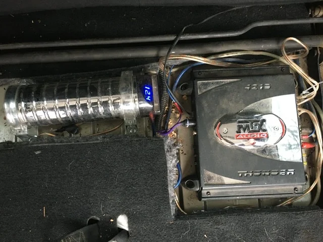

The PO installed this amp and silver tube. Any idea what that is?
If it is wired up in parallel to the power inputs of the amplifier, I'm pretty sure it is a capacitor.
They are used to help smooth out the current going to the amp if your charging system isn't robust enough.
I had them in a CRX in college to stop the headlights from diming when the heavy bass notes hit.

If it’s a capacitor you need to be careful with it. Needs to be discharged before messing with it.

Ahhh, makes sense. Their are two additional speaker wires in the mix not connected, so must be for a subwoofer the PO had installed. I rarely use the radio, so, that's that! Thanks.
