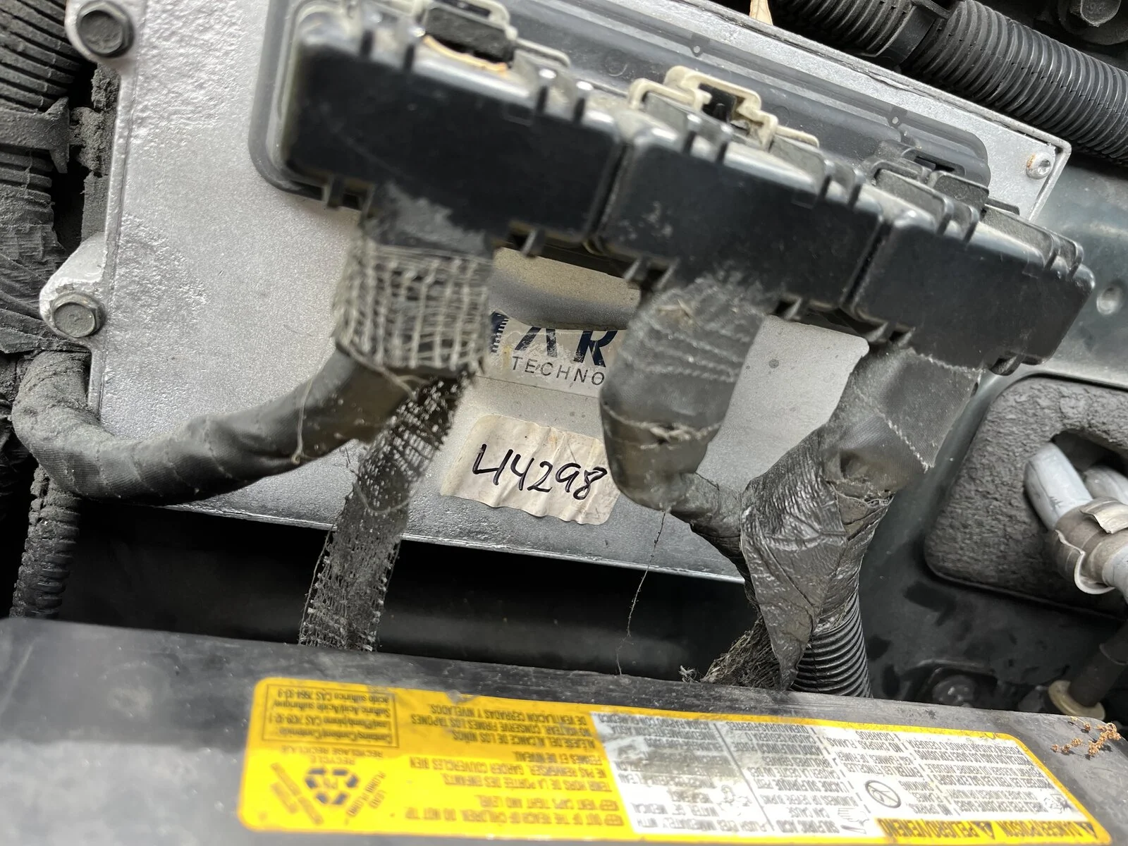

The upshift light coming on with an auto means that in all likelihood someone has swapped in the PCM for a manual. Post up the part number on it.
This is what i think but would i have other symptoms as well having a manual computer in an auto?
@mrblaine part number 44298 Ares Technologies
Part number does no good. Need the OEM number but the fact that it is an aftermarket programmed PCM tells you what the problem is. The only other symptom that may show up is the torque converter not locking up.
