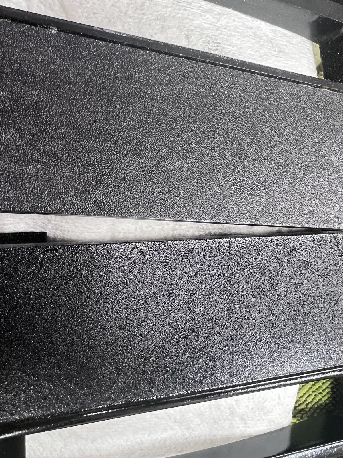

Probably in my build thread. This isn’t a flare, but another piece of plastic I painted with the same stuff. I printed a copy of the auto shift bezel. The original is on top in this picture. The bottom piece is rusoleum bedliner.

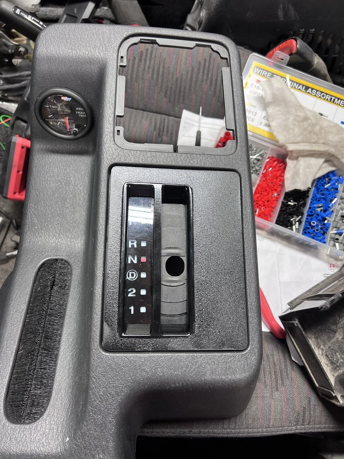

Here it is in the console

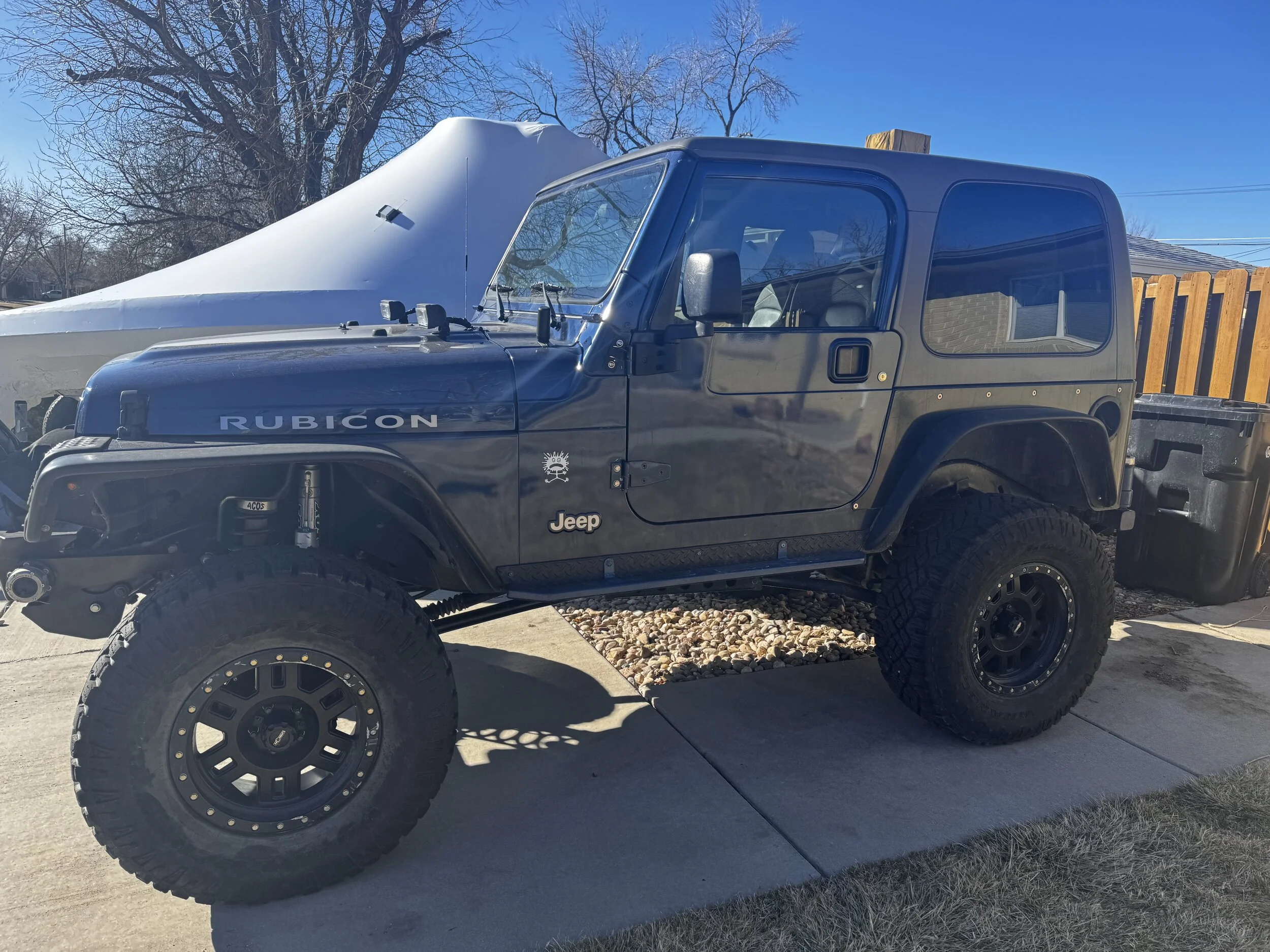

Painted with rust oleum bedliner in a rattle can. Much finer texture than something like Raptor liner
