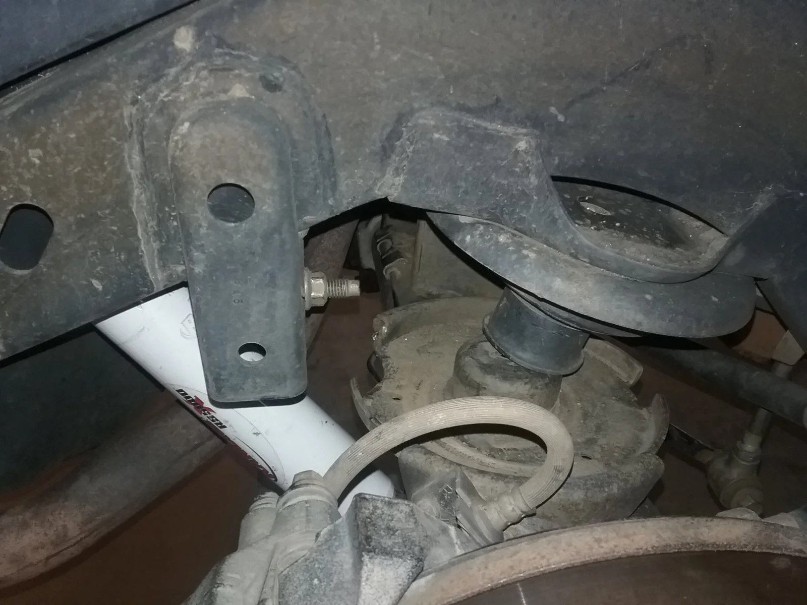

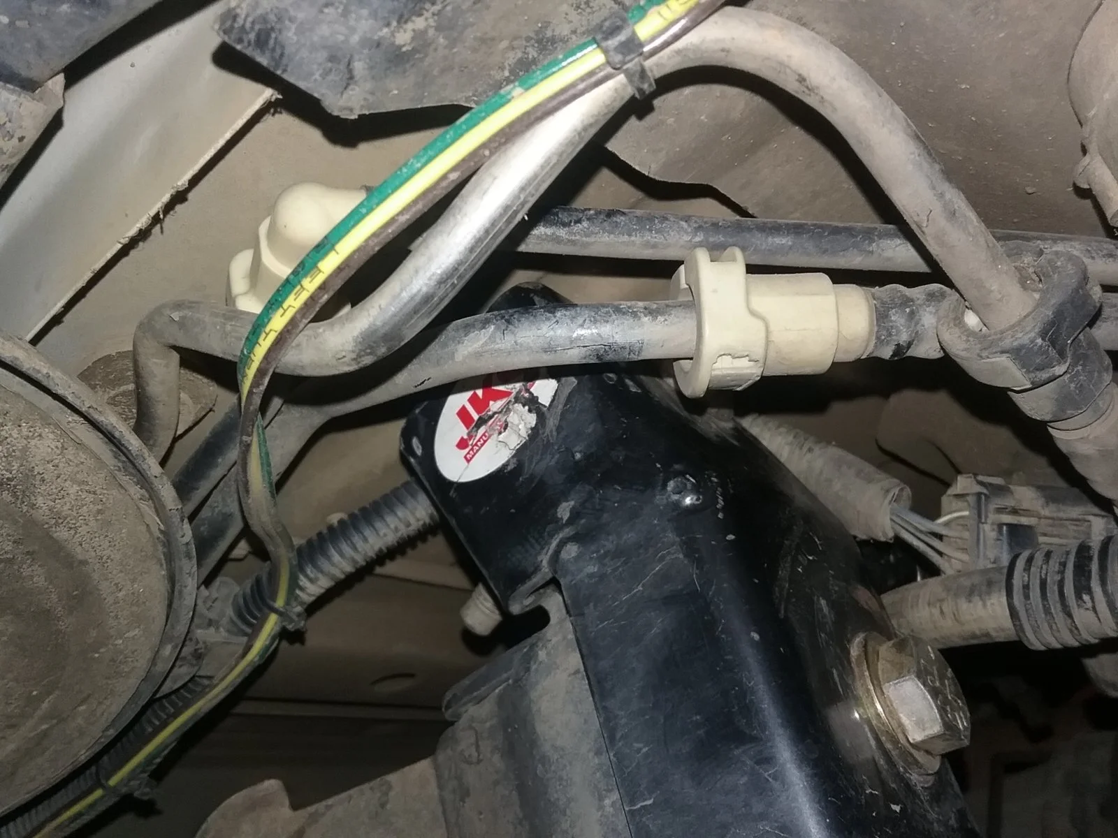

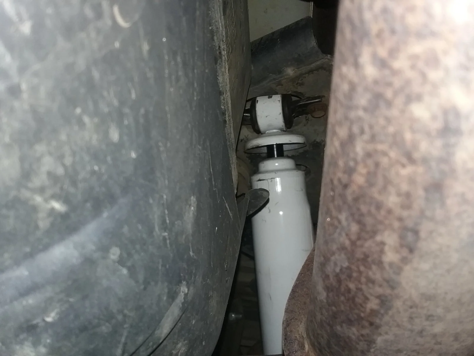

I have a rear TB, so this is my setup. 2.5" lift springs. RC adjustable rear TB, Angled relocation bracket, 1 5/8" bump stops. My RS5000X shocks clear at full bump.
My RB relocation bracket does not. No BL.
Only one mod can change this. Yep, a BL. Also, the TB is now kissing the rear gas tank skid.

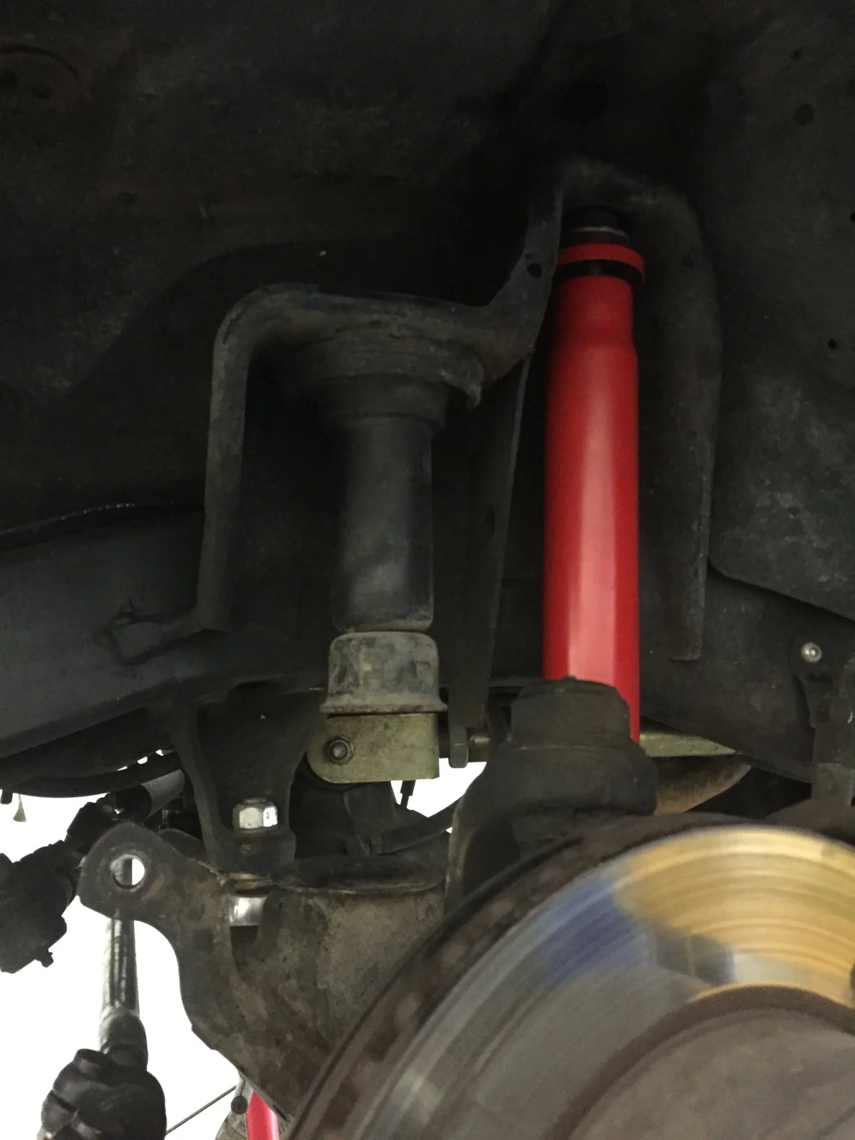

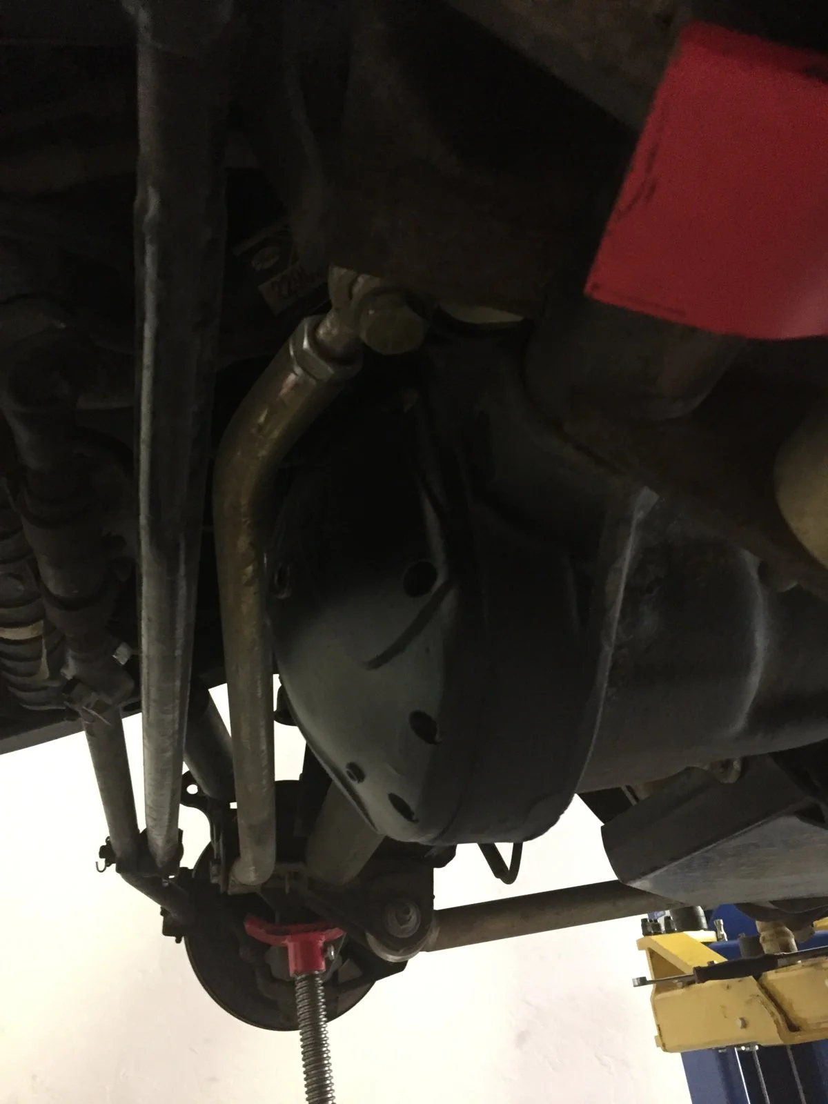

Interesting discussion. I just swapped out shocks (and added an Antirock) yesterday from Bilstein 5100s to Rocksports. The fronts, paired with the Currie 4” coils provide a tremendous amount of travel. The Metalcloak front trackbar still clears the front diff cover by about one half inch with the axle stuffed and the shocks collapsed. I had no interference with any components. The Currie springs and Rocksport shocks seem to work very well together.
