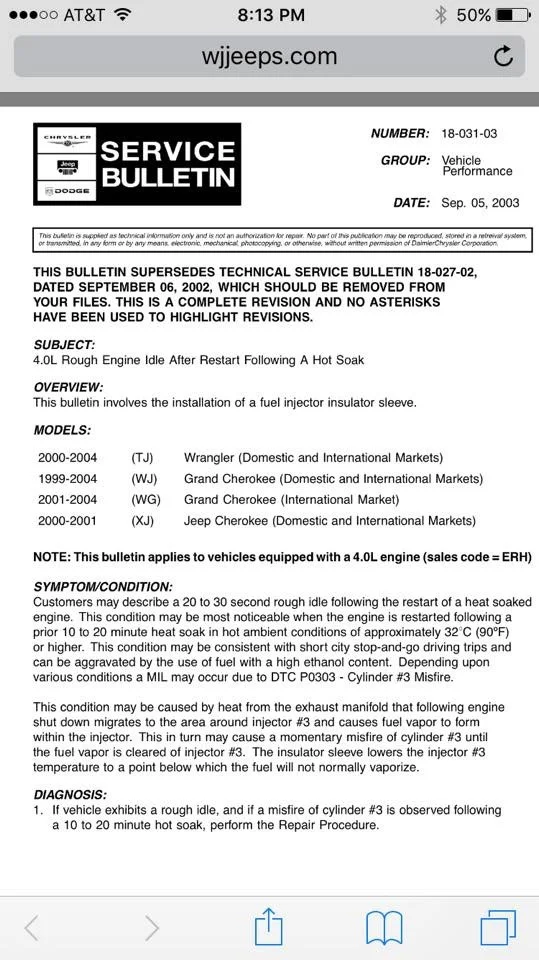

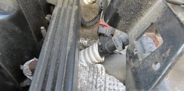

When you're running in a hot climate, such as Arizona in the Summer, when you shut the engine off, the fuel in the fuel rail vaporizes. If you start the engine before it has a chance to cool, and the fuel is still vaporized, it causes a miss in the engine, usually cylinder 3. It only lasts a few seconds and doesn't cause any permanent damage, but it will throw a "P0303" code for a few engine cycles.

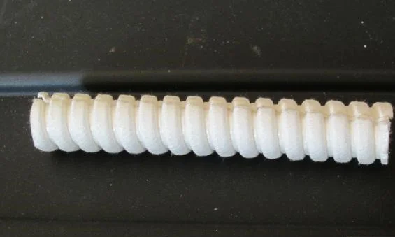

The factory solution to this is to wrap some sparkplug wire insulation around the number "3" fuel injector. Vents work too, and they look cool.

XJ's had the heat soak issue, so much so that Jeep had a part# for a piece of insulation to cover #3 injector. Wish I hung on to the part#, but reason I mention this is it happened on my TJ once a while back during the summer while traveling in higher elevations. I ended up buying the insulation piece from the dealer and installed it. Haven't had the problem since.
Heat soak happens to me in Florida. Local guys have installed the hood vents and eliminated it.
The insulator sleeve is Mopar part number 56028371AA and costs about $7.00. It didn't help my Jeep.

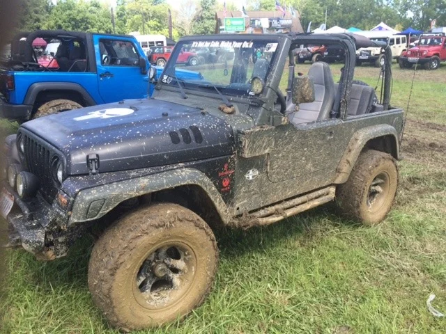

I made my own, mostly because I wanted it too. it did lower under hood temps, but again it really wasn't necessary...

My TJ is a 97 4 cyl 2.5. Strangely enough, I had a misfire when I first got here to CA, but it was not a high temp situation (early January). I might just get the $7 part anyway. Ounce of prevention can't hurt at that price.

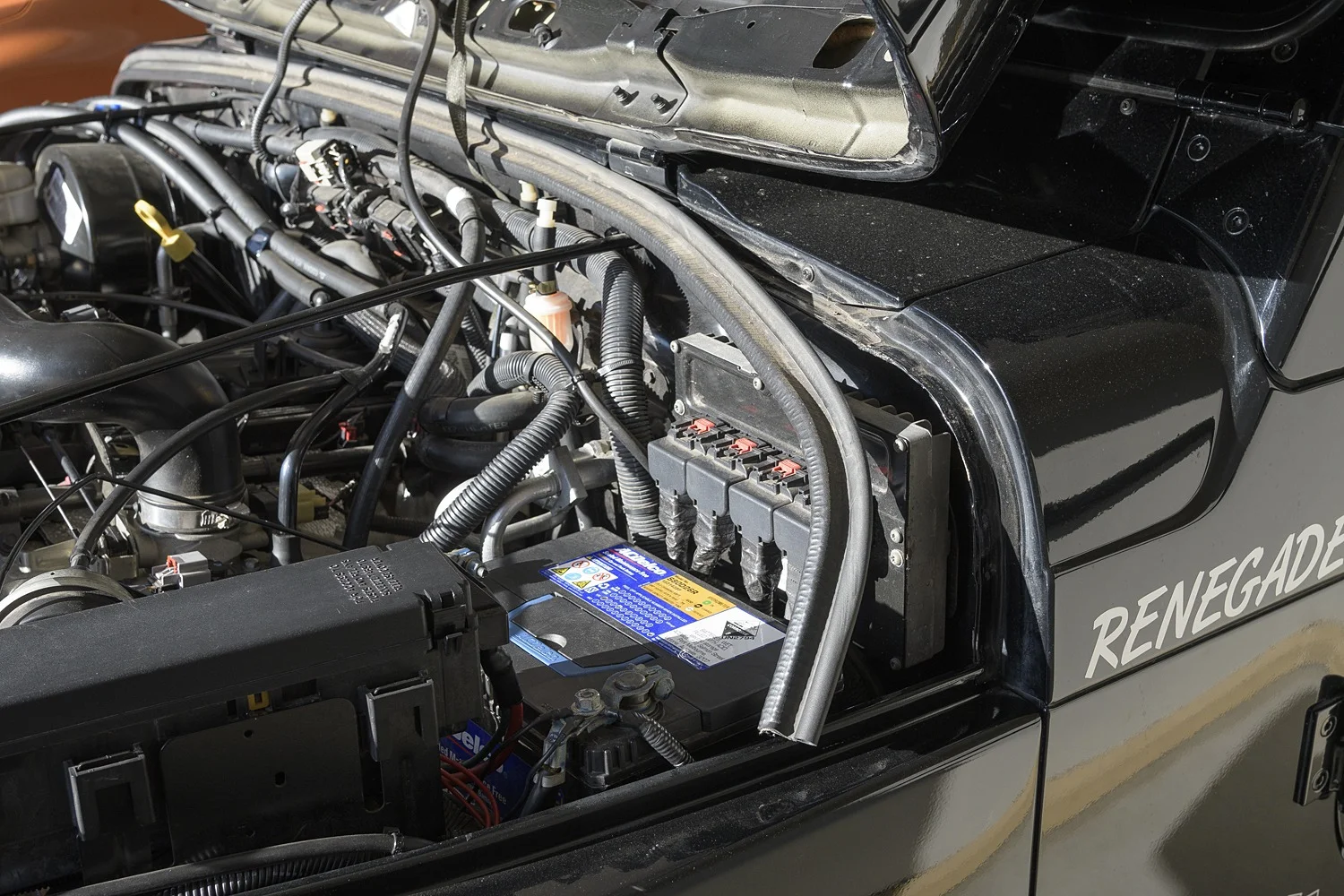

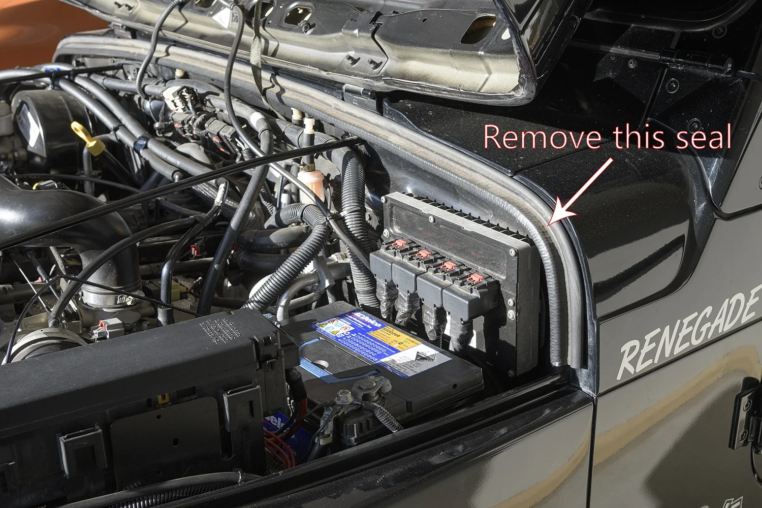

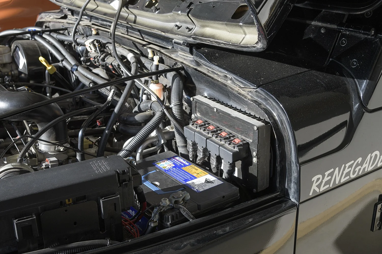

I have been playing with the idea of hood vents for a long time, not to try and cool the engine, but to get rid of the excess heat. Especially heat soak. I don't know if it does much, but I just remove the seal at the back of the hood on hot days. With the seal removed there is a gap that runs all along the back of the hood where heat can exit. Just an option for people if the want to try it.
