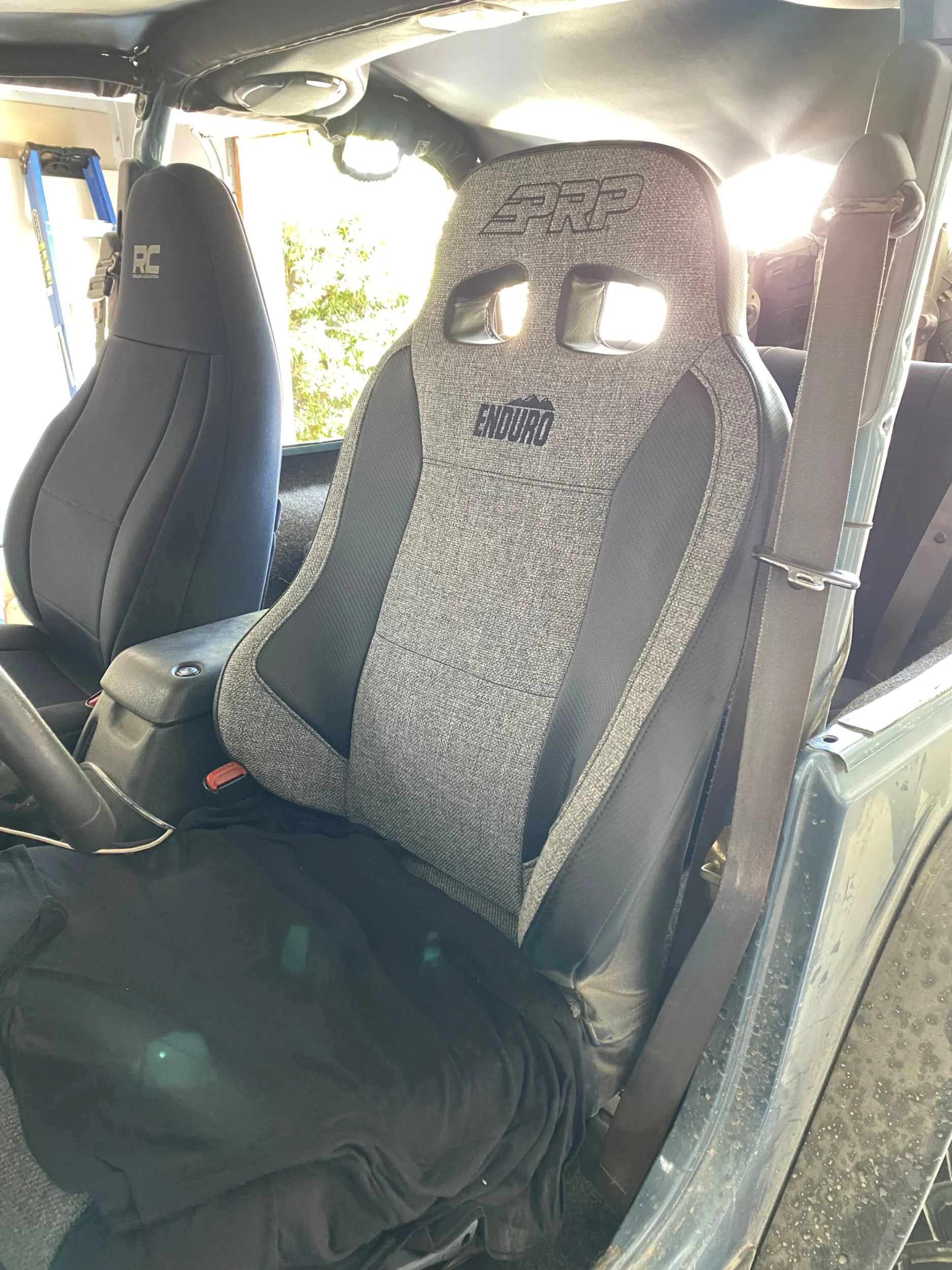

What seat did you buy?

This is the seat I bought, it has lumbar support but it’s a little too low for me. But overall the seat is pretty good, I don’t really get pain when driving on road, so the seat is at least adequate.

I already purchased a new drivers seat, that was definitely contributing to issues, but it wasn't enough sadly - even though I love the new seat.
