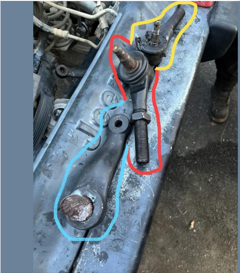

Whoah! Mind sharing details on that failure?
We run a currie correctlync and feel pretty good with 35’s and a gentle driving style. Hadn’t even considered the steering box sector/pitman shaft shearing off.
The Mercedes steering gear found on 03-06 TJs has a bit of a history of breaking at the sector shaft where the earlier Saginaw boxes did far less so.
