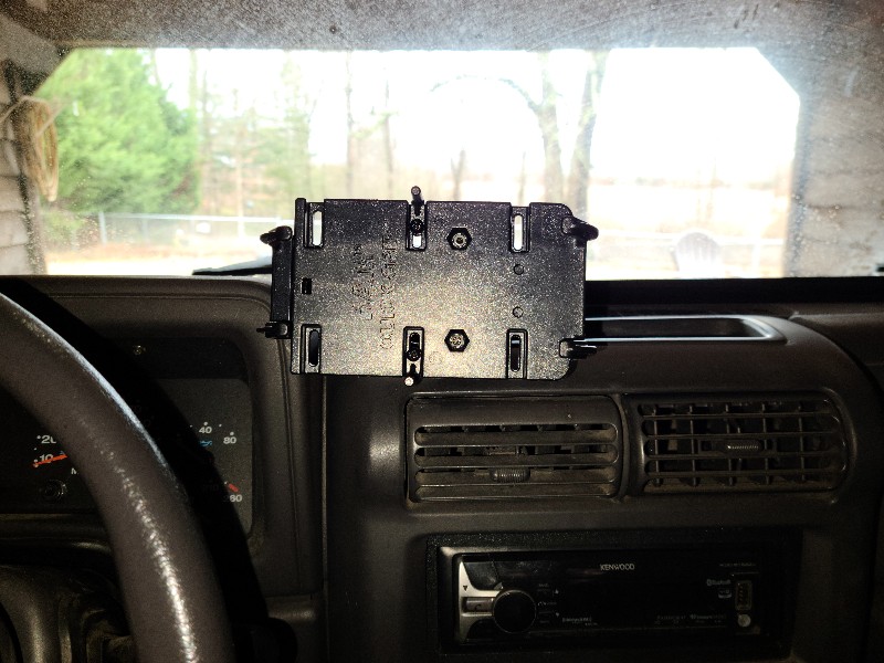

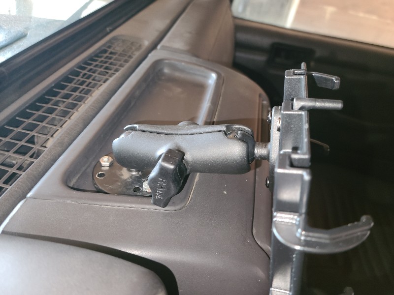

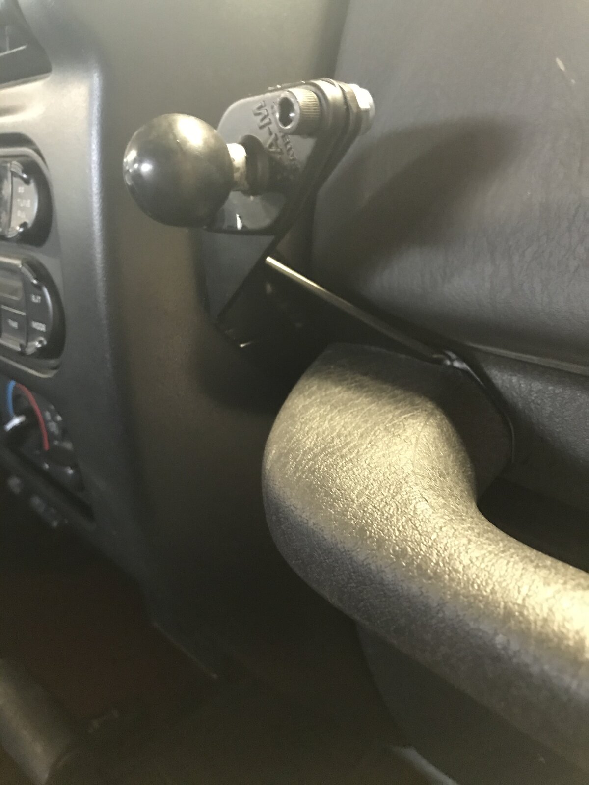

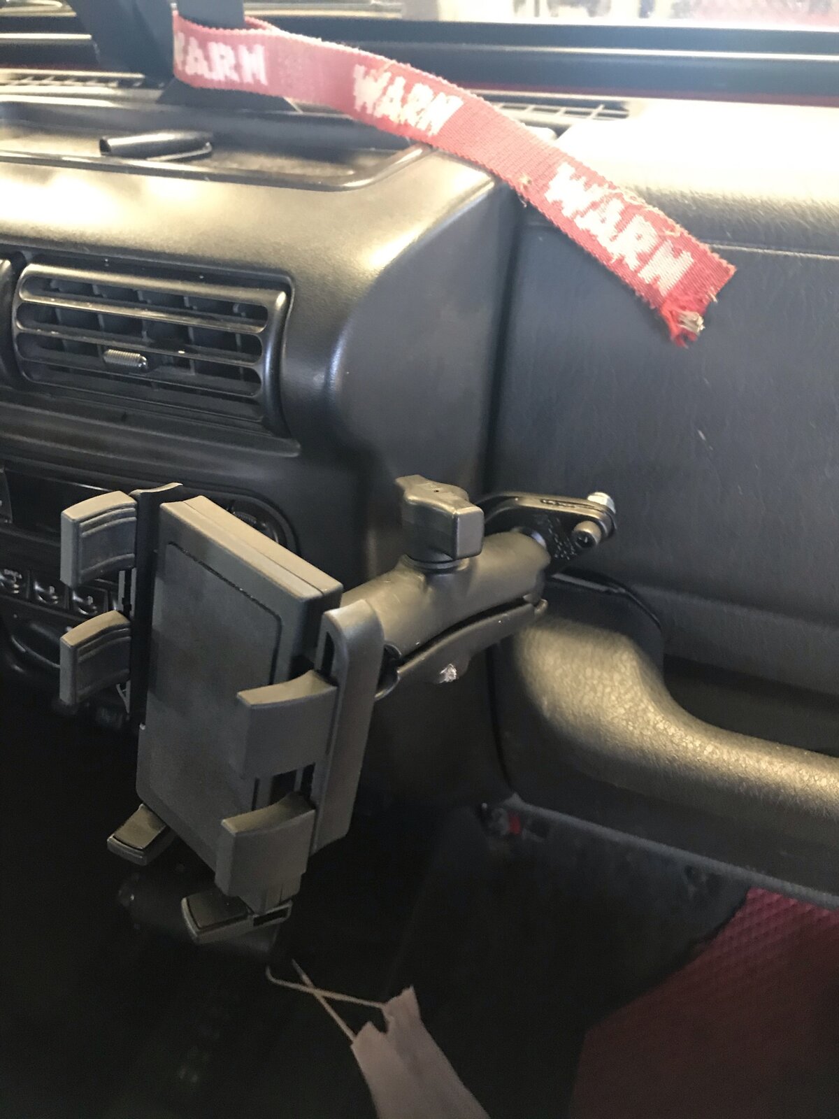

I have realized I need to find a phone mounting solution for navigation purposes.
Here you go!!

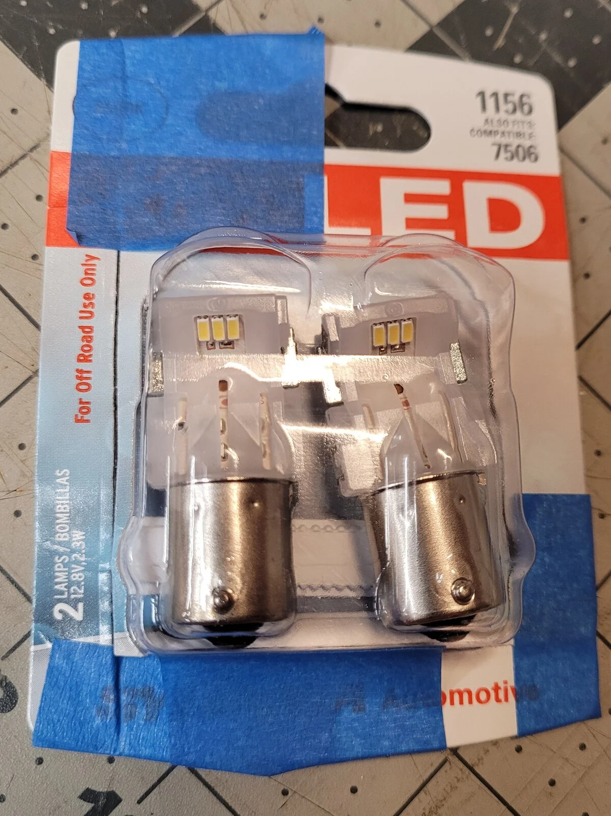

Between coats I added some Sylvania LEDs to my footwell lights. Those were ok. However, I tried adding the same brand of LEDs to my backup lights, and no, they were not good. I didn't even put the lens cover on because compared to the regular bulb on the opposite side, they were just weak.
So if you're at the big box store getting spray paint and think you want to get these for your backups, don't.
