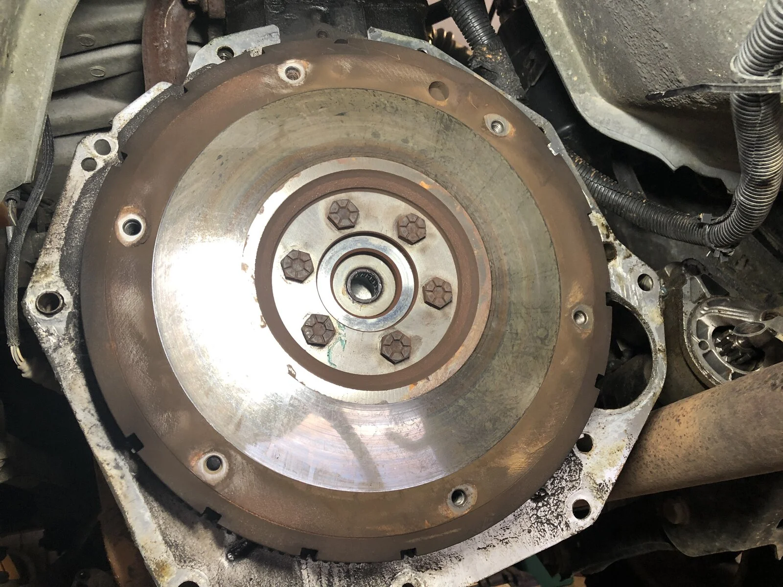

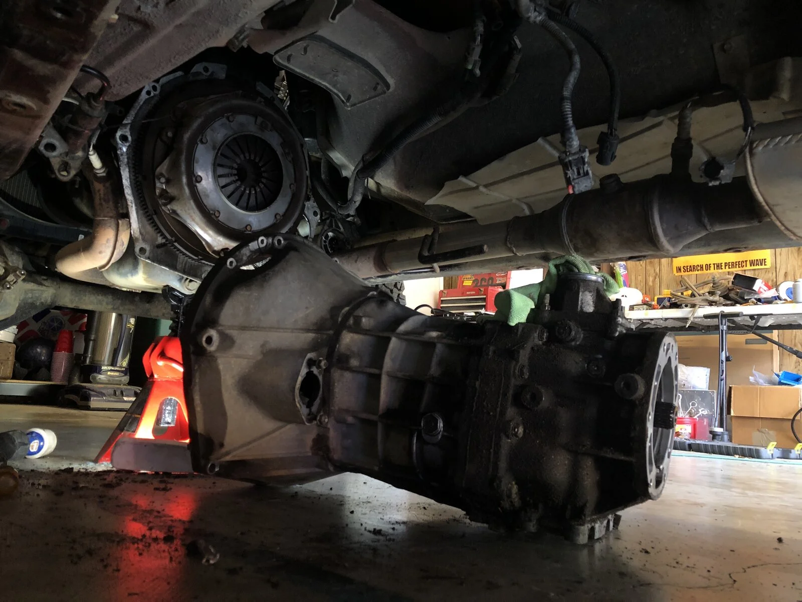

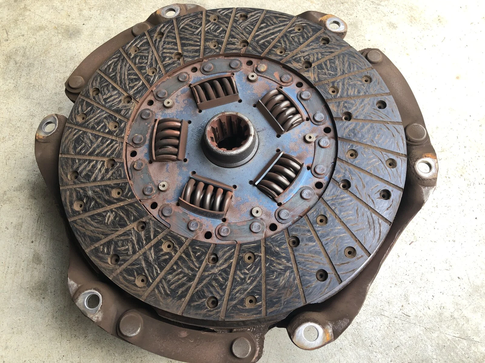

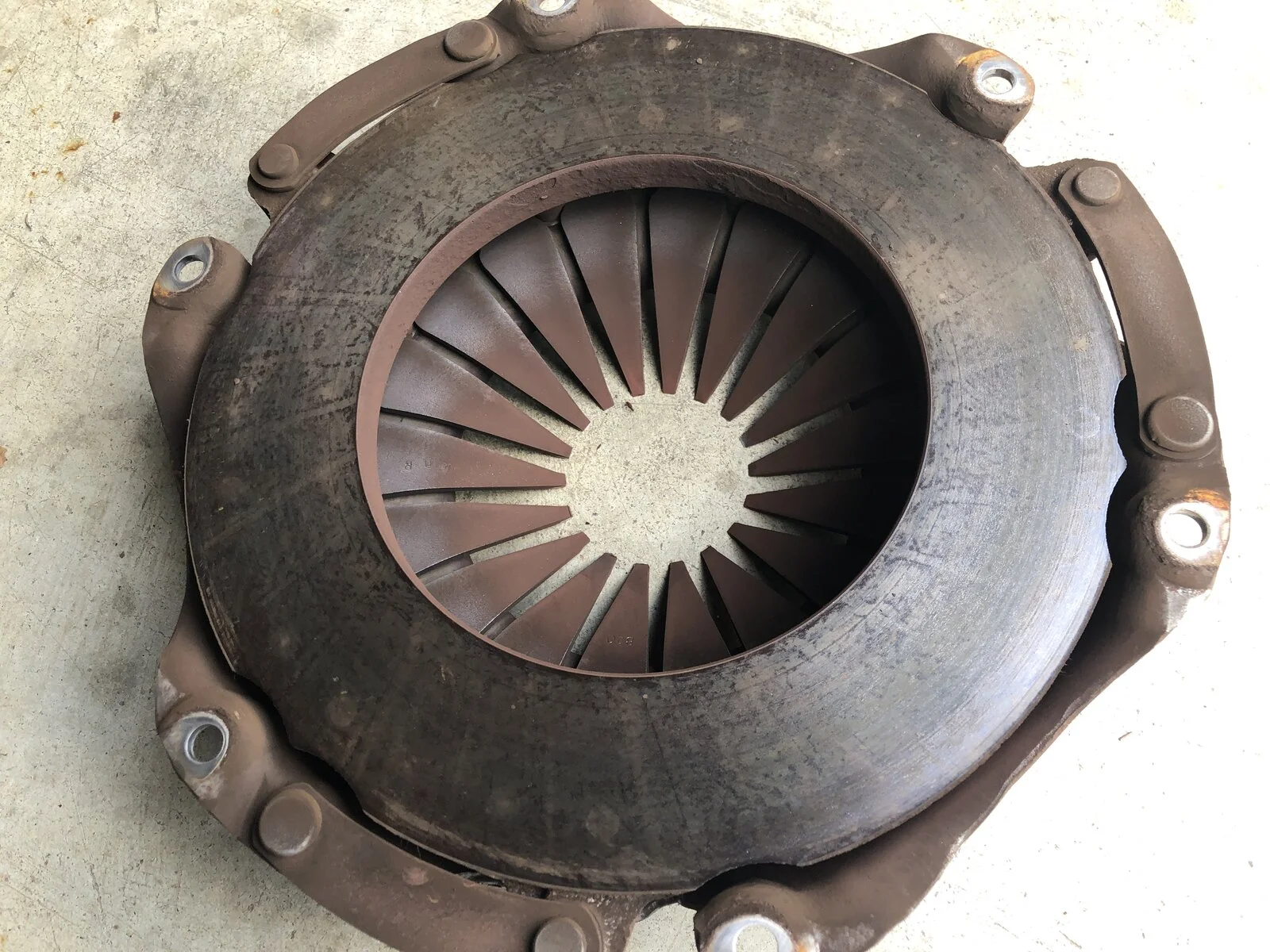

Spent the day pulling my trans/transfer case and clutch out of the Jeep. I was hoping it was only going to be to replace the clutch components, but I'm worried about this trans. I don't think the factory used orange gasket sealant, did they? So, I'm guessing someone has been into the thing before. I've driven it for over 50,000-60,000 miles since I've had it and have always had a question in my mind about it's lifespan. It shifts...but not consistent or smooth and I had driven it 100 miles or so the night before I parked it with no issue....BUT. That play in the input shaft and the metal particles in the oil that has wept out of the rear seal area has me thinking it's rebuild time or new trans, since I have yet to find a rebuild kit for it online. I'd rather not put a clutch in it, stick this trans as it is back in and have it blow up on me later.
Throw out bearing does seem shot, but I'm surprised the pressure plate and flywheel look better than I thought they would...not blued, but definitely showing signs of wear.
Anyone have any sources for AX-15 rebuild kit?

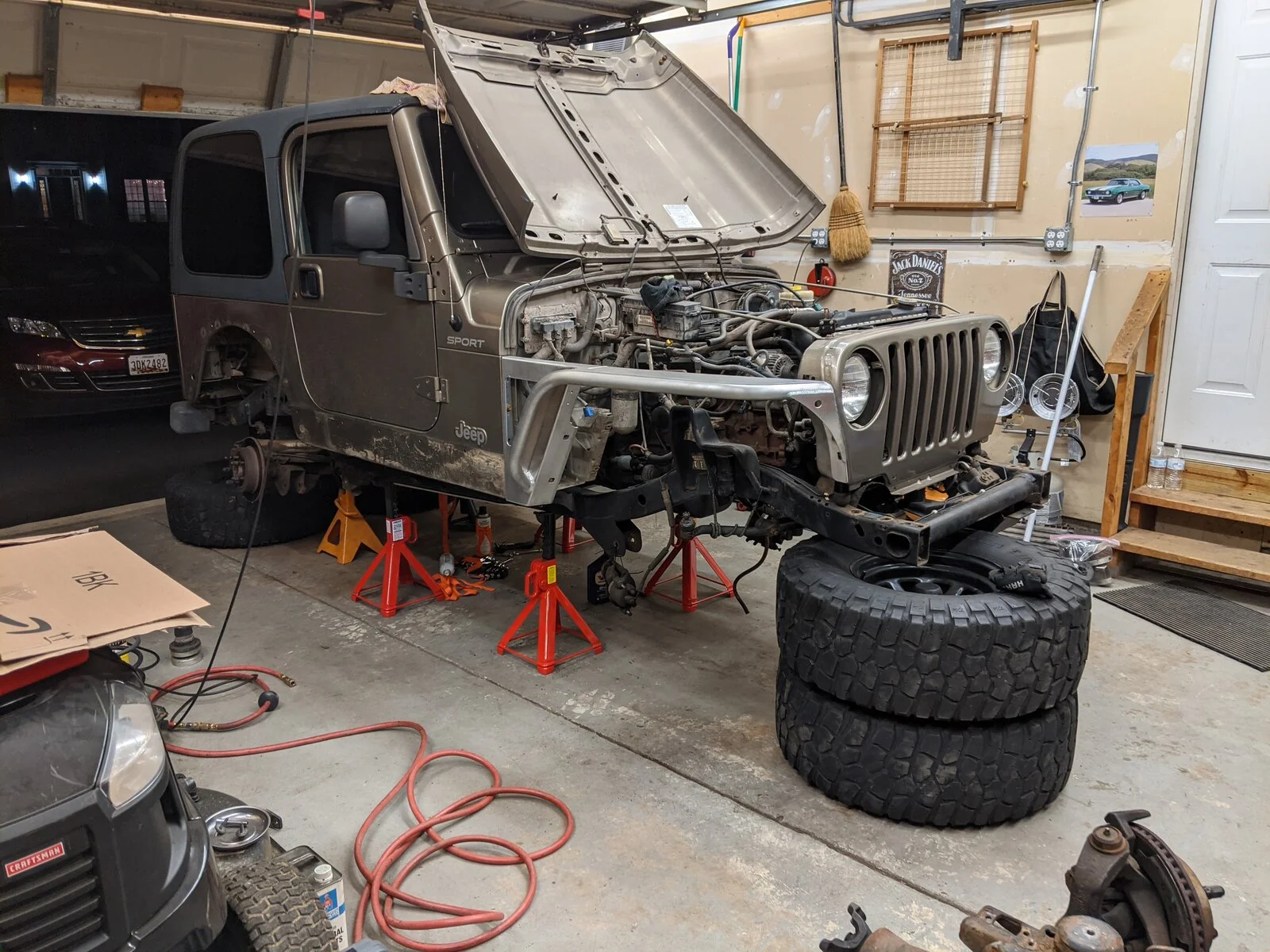

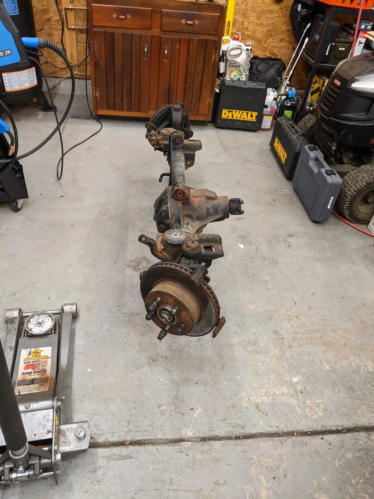

Front axle is out.

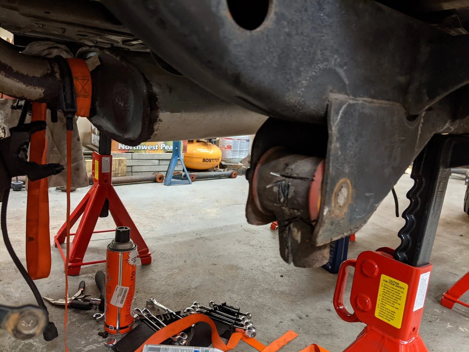

Rear axle only held in by brake line and breaker tube. Lubing the brake fitting with Kroil overnight. Considering a full SS replacement on the brake lines so that may be irrelevant.
I won't be reselling the lower control arms. Lol.
Clearly tried the grinder. With the axle out, I should be able to get the sawzall in to get this frame mounted piece out. Diablo sawzall blade well worth the cost. Did the job clean and quick on the axle end.

BTW, Tires are there for piece of mind - no weight on them. After putting the Jeep up on the 4 new jacks (USA made 🇺🇸), I still had some underlying concerns of having no backup if (God forbid) the Jeep shifted. I trust the jacks 100%+ but first time with the Jeep on only jacks was a bit intimidating.
Learned early on to throw the tires under the vehicle while their off as backup if the vehicle falls off the stands. Without anything there, I could only think of becoming a Flat Stanley for the moments I was under it without the tires there as a backup...
Having seen the @mrblaine idea to use straps to secure the Jeep down to the floor while on all jack stands, I'm really considering adding floor attachment points for the sense of security.

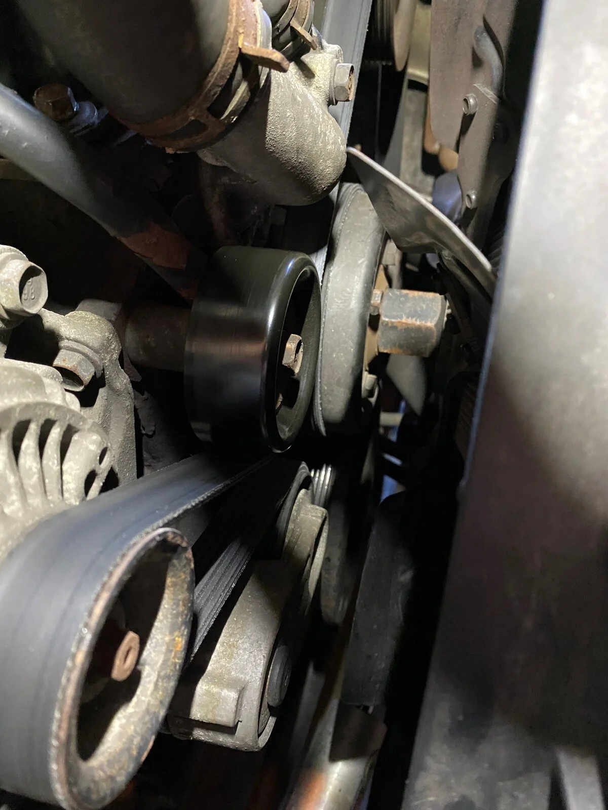

Changed out the idler pulley and a new belt. Picture isn't the greatest but I couldn't say I did it without proof! ;) View attachment 233455
IF you didn't throw away the old idler pulley; you can replace the old bearing and keep the old pulley as a spare.
I purchased the bearing from Grainger and didn't take very long to replace.
