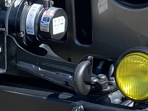

Finally bolting up the winch on an elevated plate. Would somebody tell me just WHY elevated plates start their up-slope so close to the mounting holes?!? Another inch farther away and the stock tow hooks would fit without alteration! Some folks swap them side-to-side to work around that problem, BUT that trick doesn't work if you have stock fog lites. So, I'm grinding down a about 1 inch wide by 1/4" thick slope on the bottom of said tow hooks.
I had the same problem, I got a set from etrailer that aren’t offset
  • Sad
Reactions: Chief Brohician
I ended up using a plate that mounts behind the fairlead, and lets me mount the fogs at the same level in the center.
You can get these. They fit perfectly. I reused the factory bolts though and put a couple coats of paint on the thinly coated clip thing. (Which you don’t have to use)

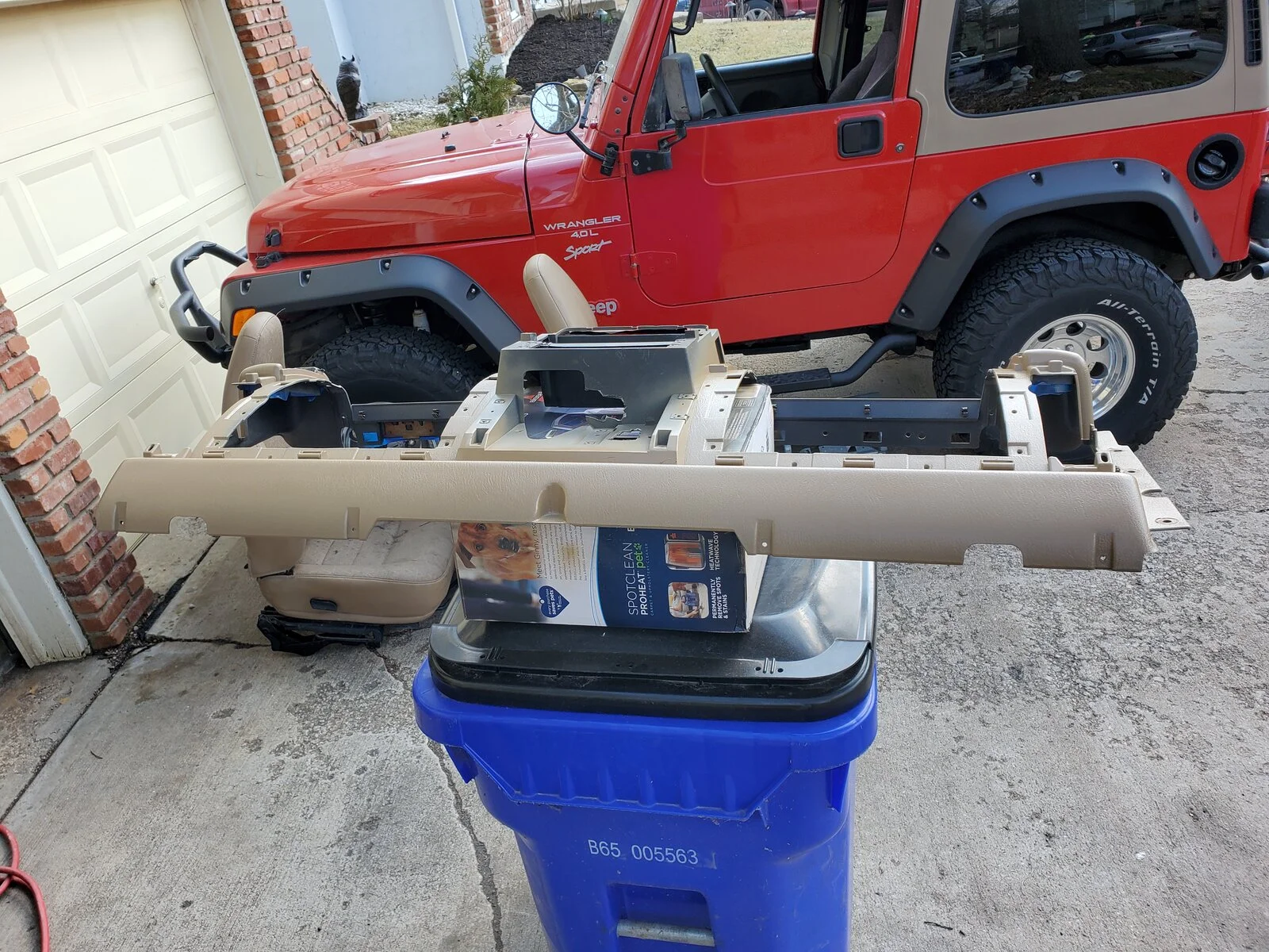

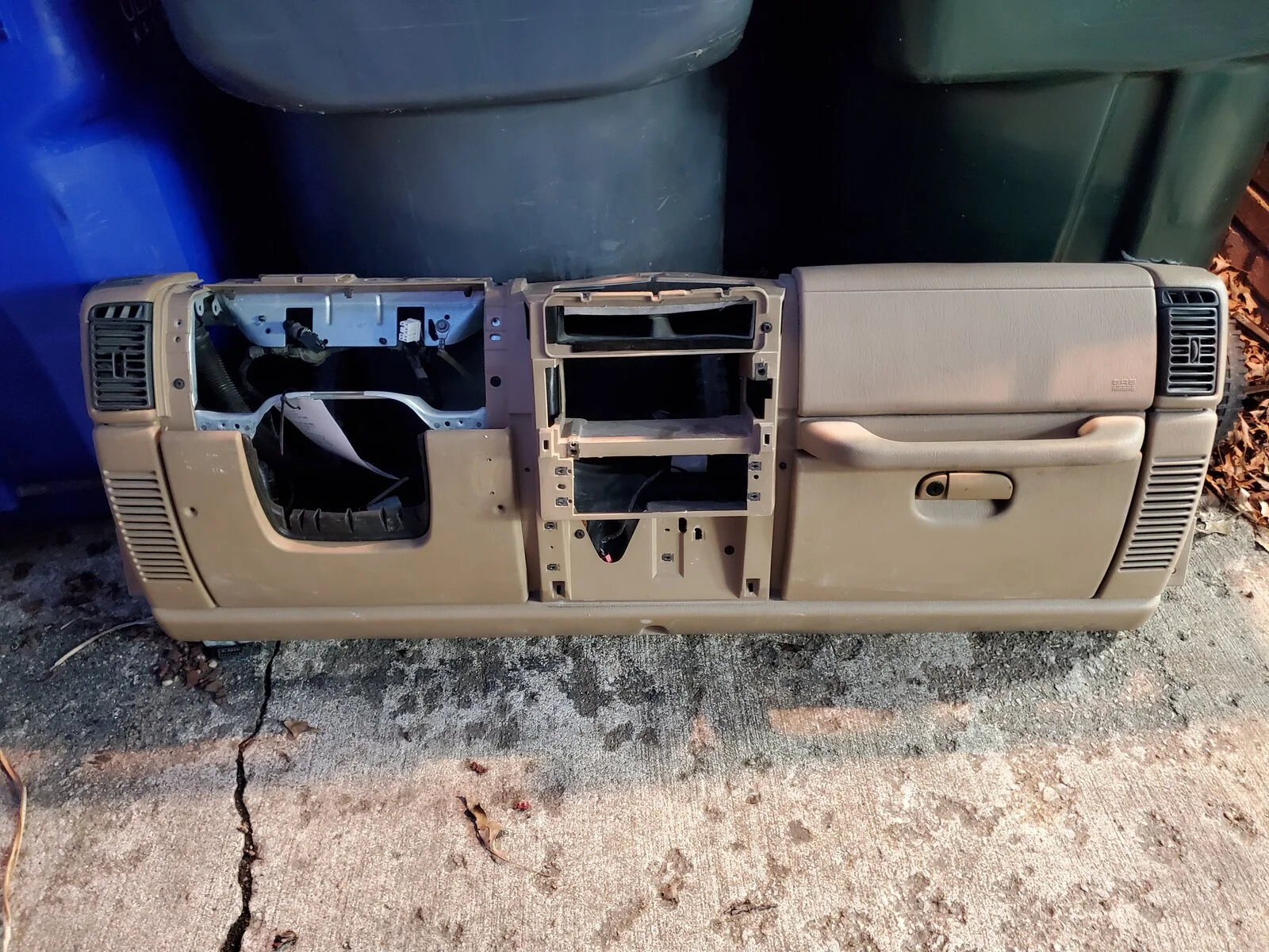

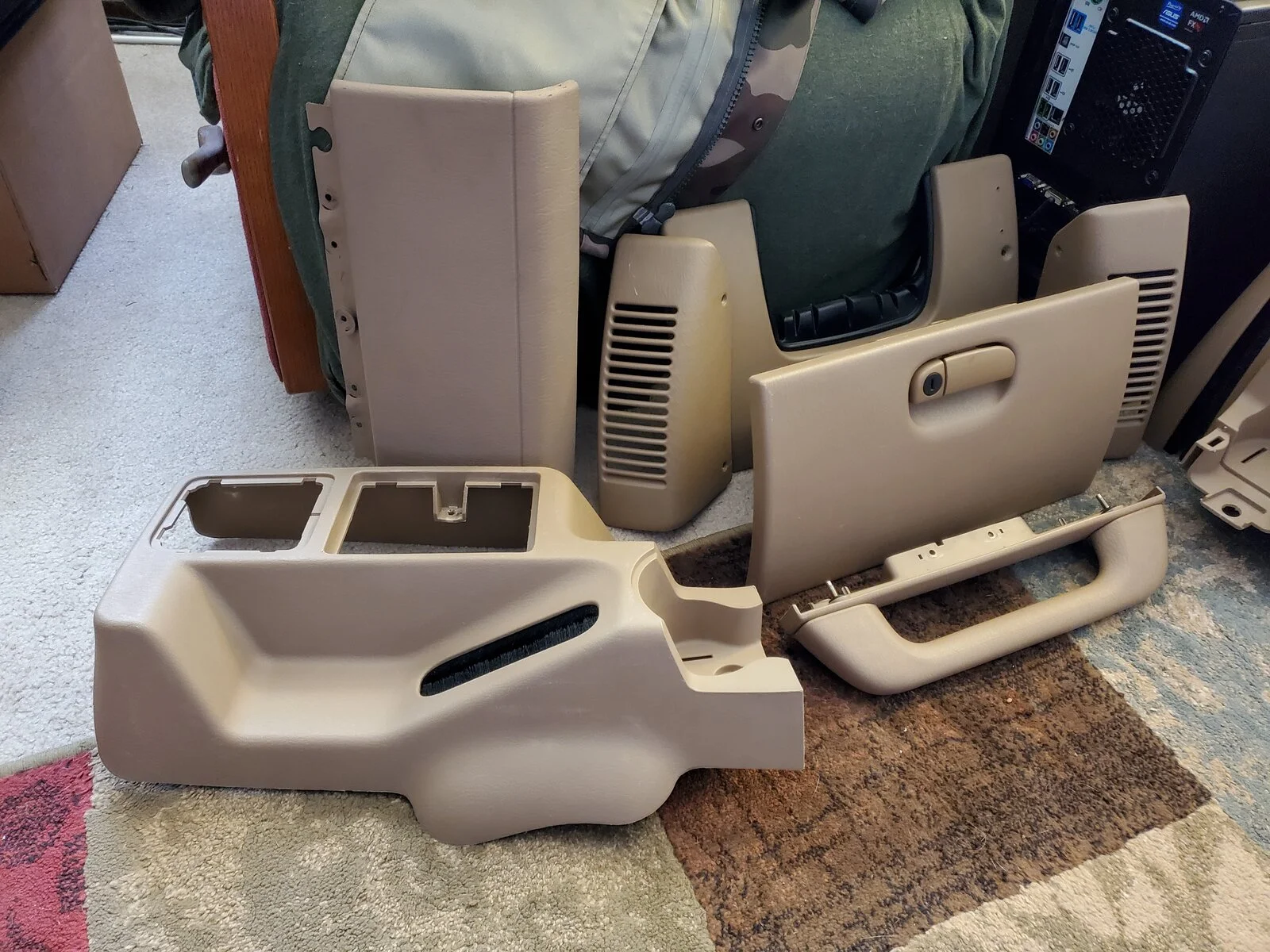

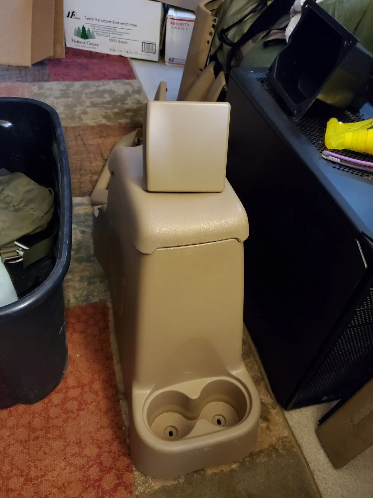

The dash came with the cluster bezel and centerstack bezel:
Cleaned up the dash and console parts:

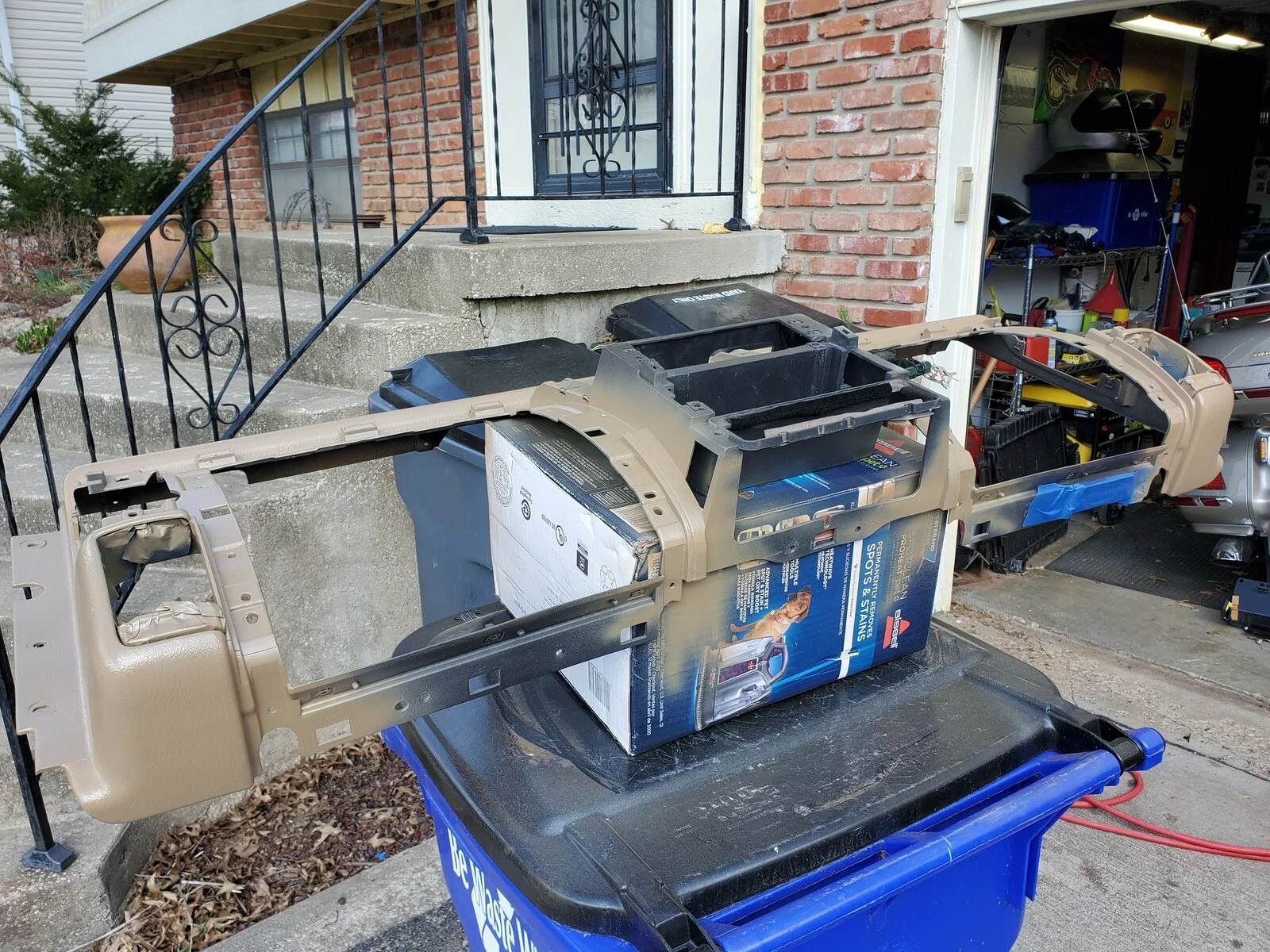

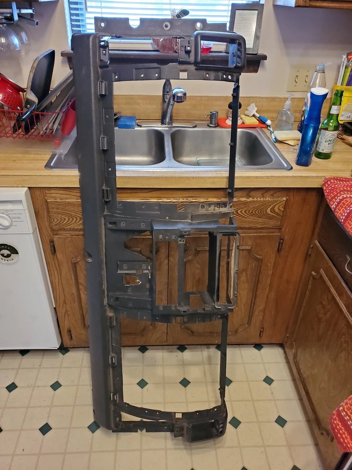

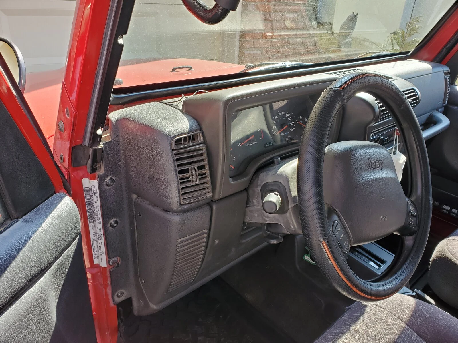

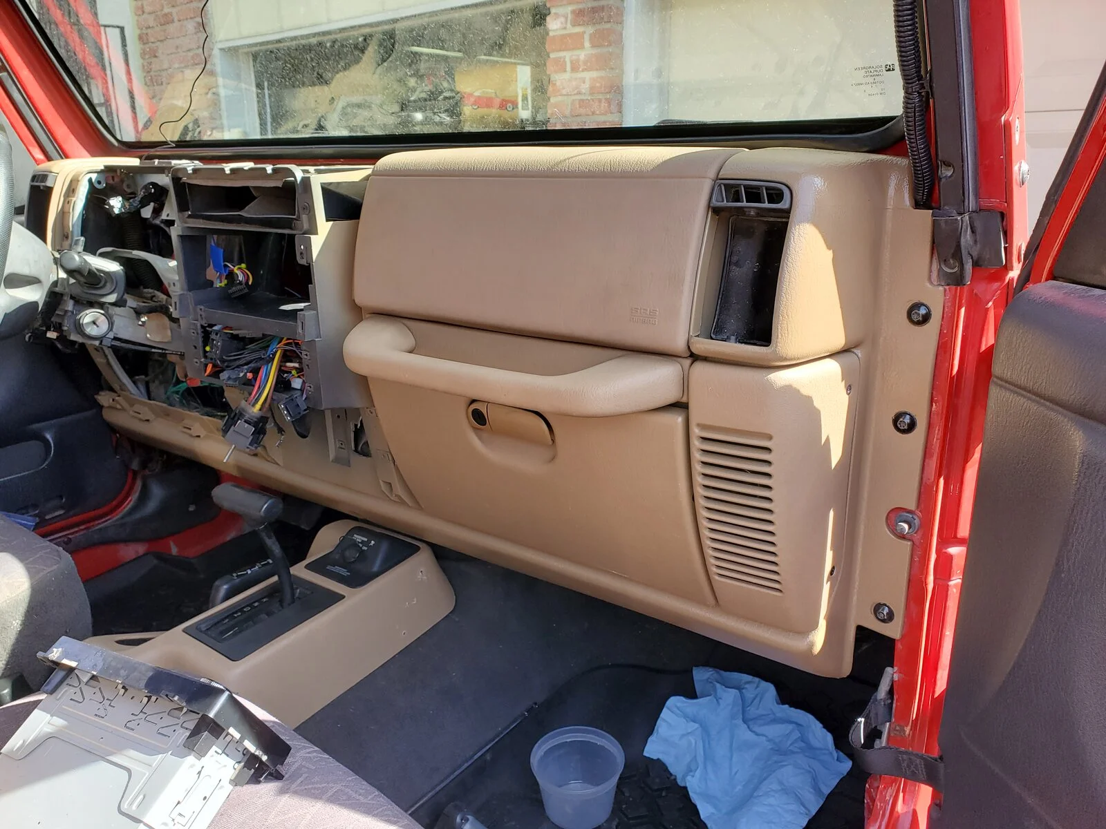

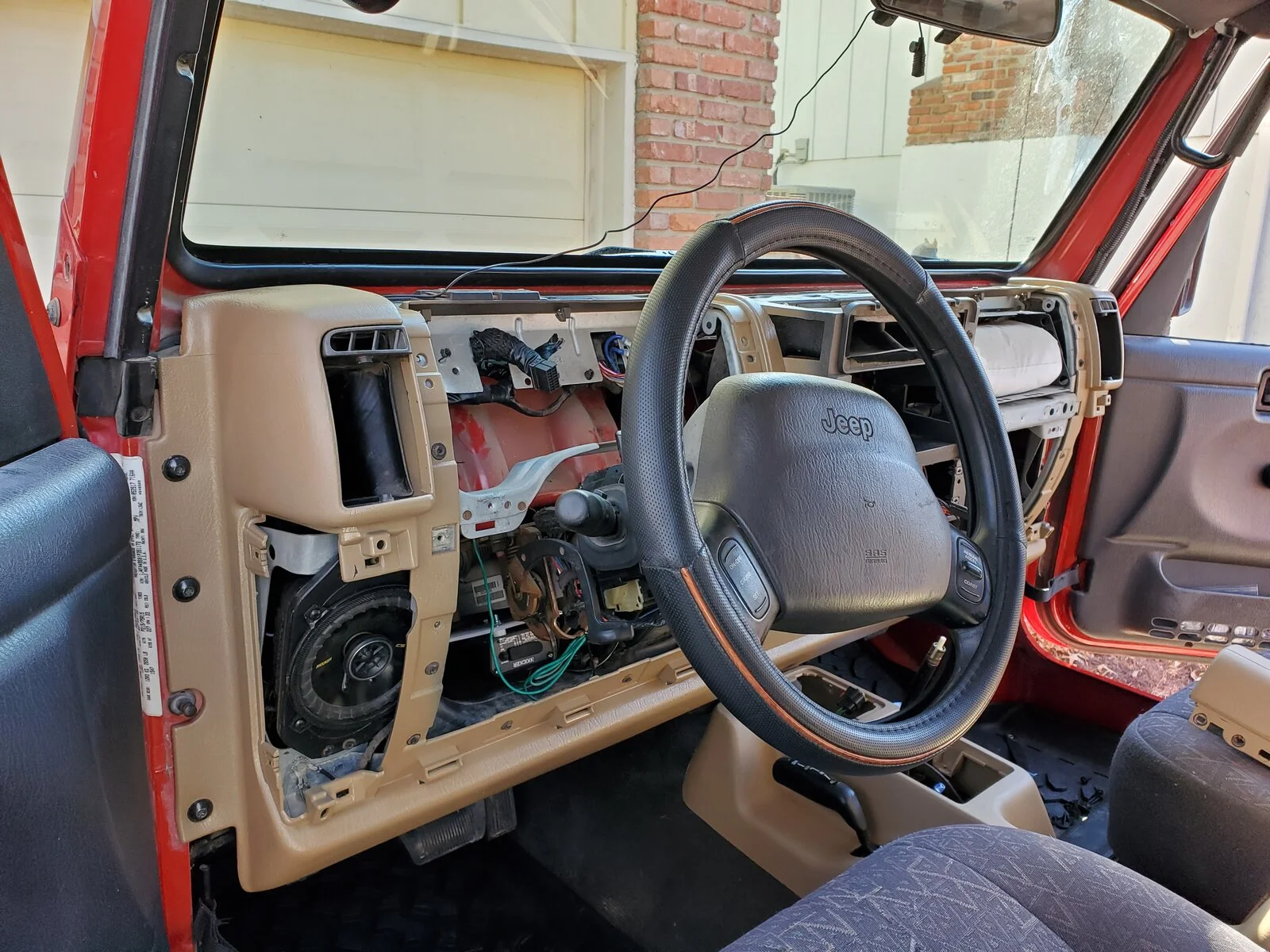

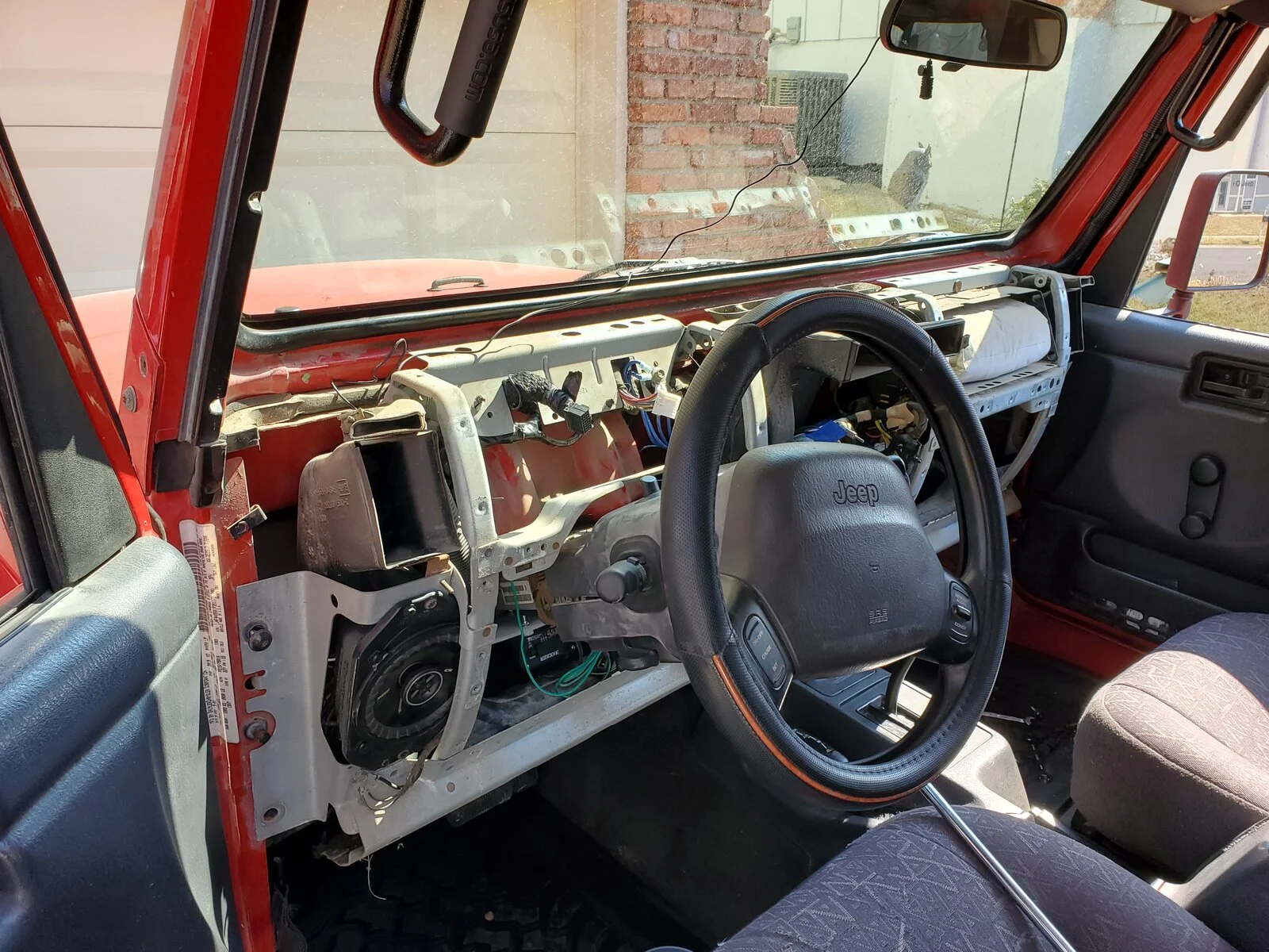

I had originally thought, I'd just cut part of the gray dash with the VIN on it, and leave it attached to the framework, and attach the tan dash to the same framework. But, the easiest and safest way to stay away from problems with the law, was to paint the gray piece tan. Researched the interior paint, SEM has a perfect match to camel, annnnnnnd nobody in KC has the SEM color match mixer. Got impatient, and found Krylon Satin Nutmeg at $5 a can, to be a perfect/near perfect match. Let's run with it and see what happens. I painted the ashtray with it, and it's sitting on the factory camel console. Looks good to me!
Let's get started!
Pulled the plastic dash:
Washed it in the sink!
Kidding! The handheld shower head in the tub worked great!
Started the painting.....:
Finished the painting....:

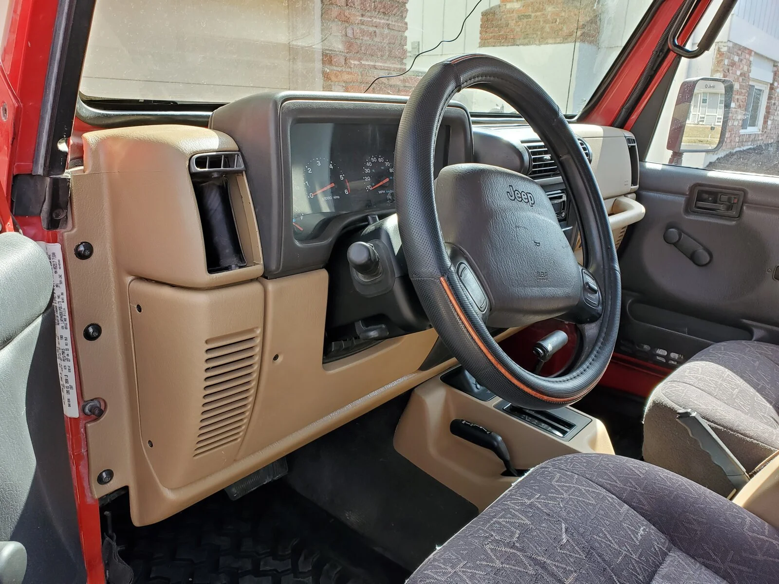

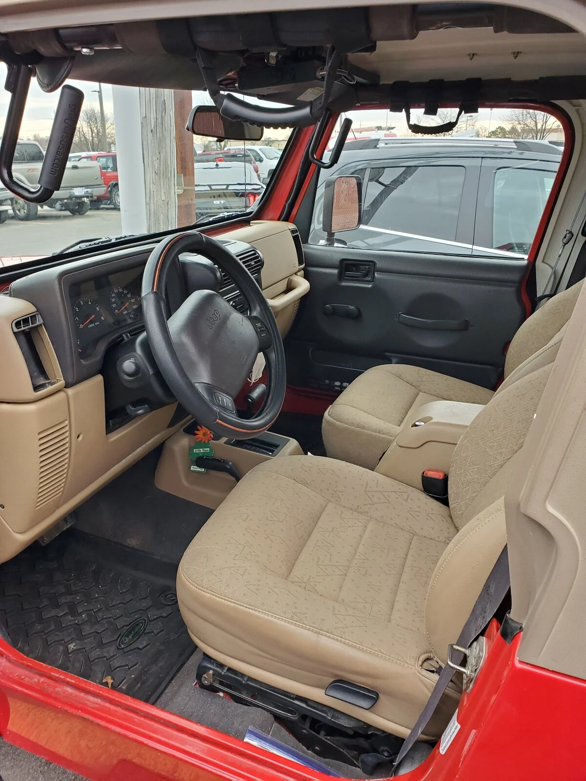

And waited just long enough to put it back in (I swapped out the console and my modded subwoofer while the paint cured):
The airbag cover was especially fun!!! I recommend a zero offset box end ratcheting wrench!!
Repainted the awful steering column shroud a flat black and put most of the rest of the dash pieces on:

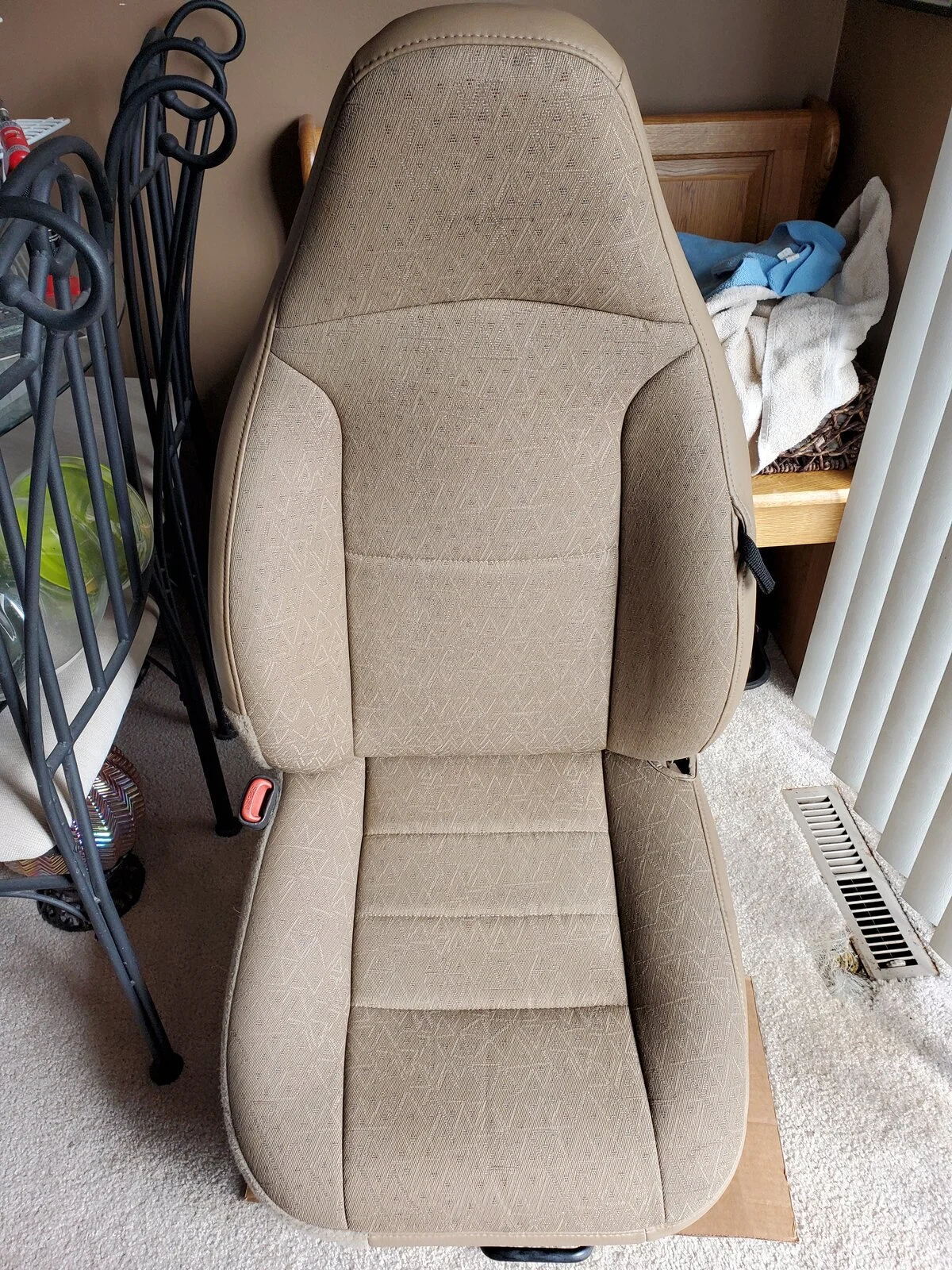

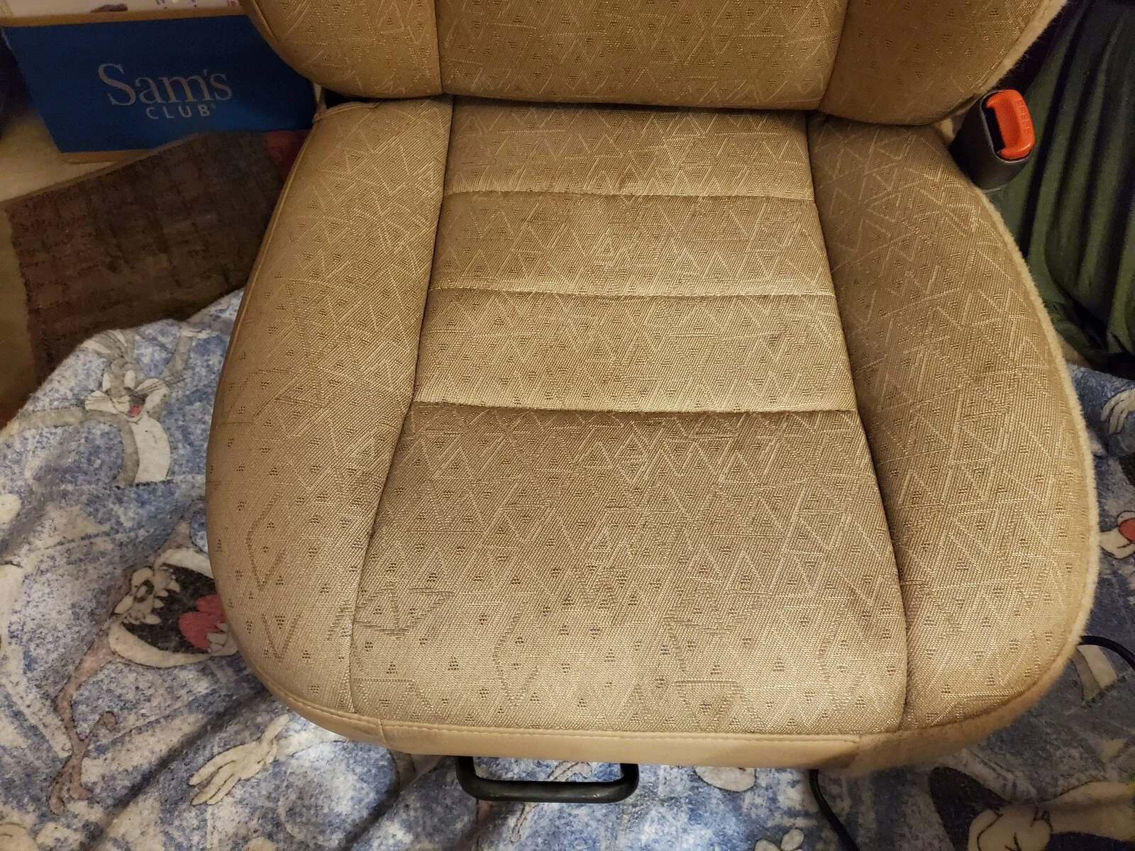

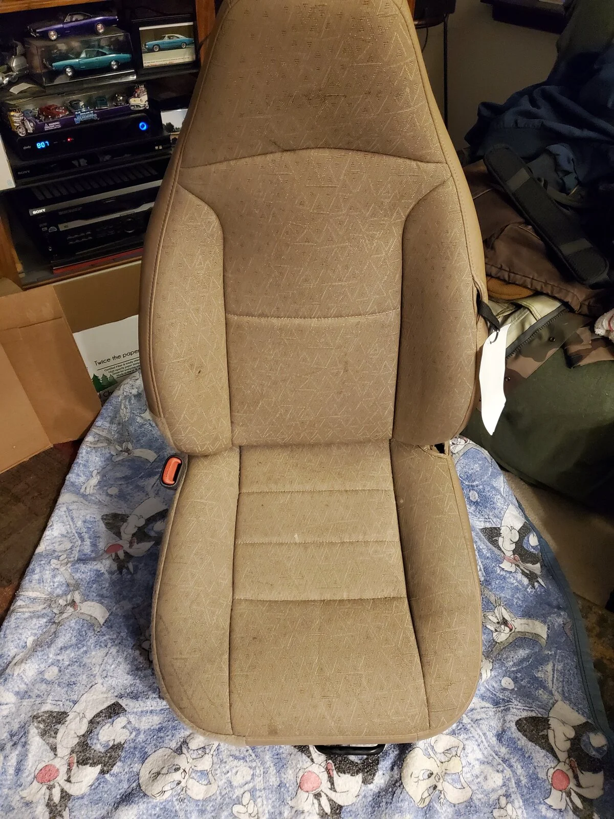

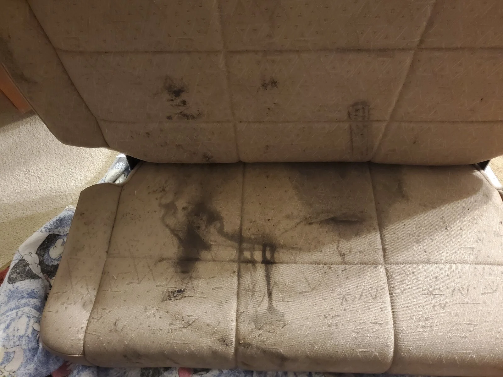

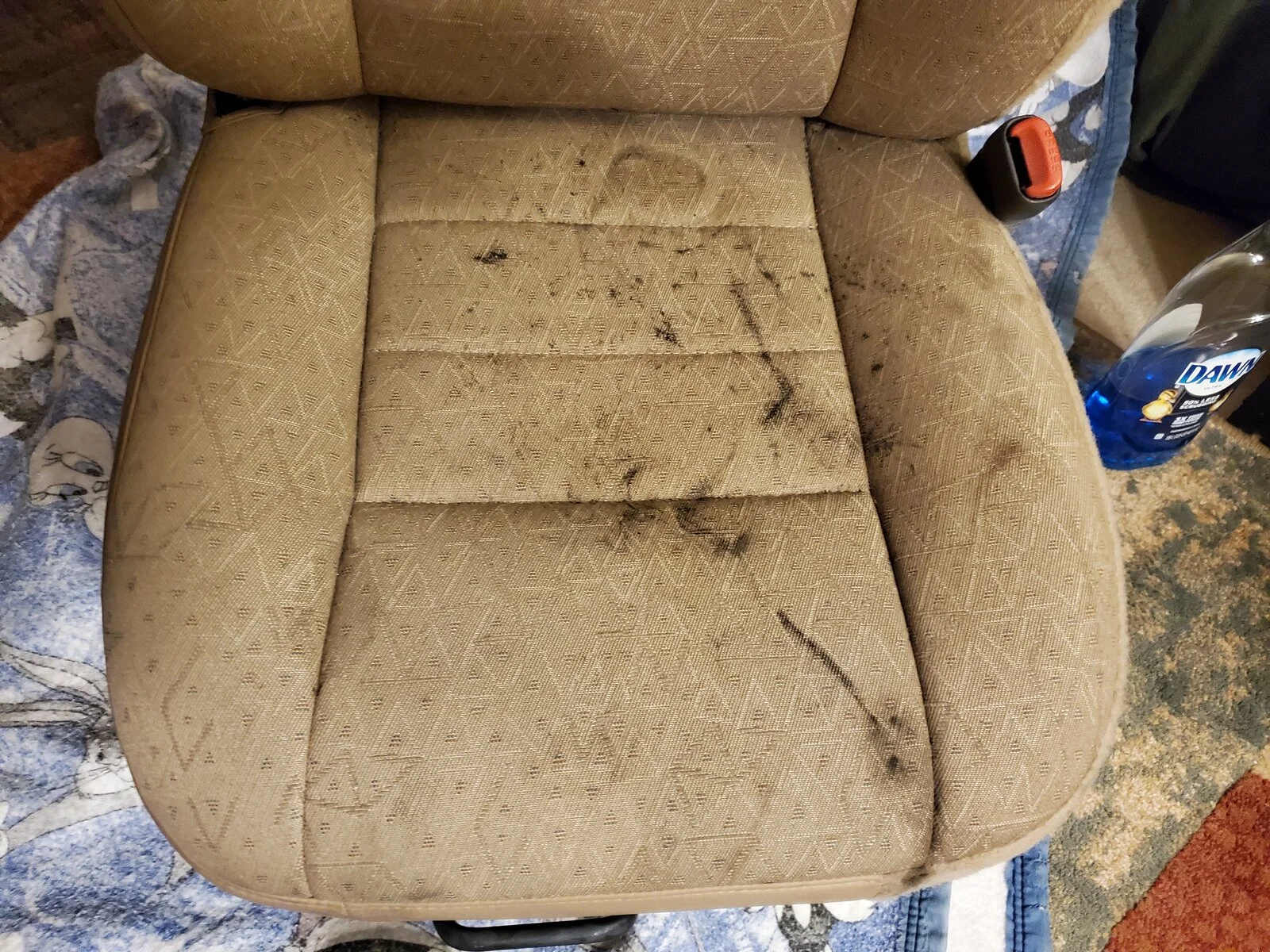

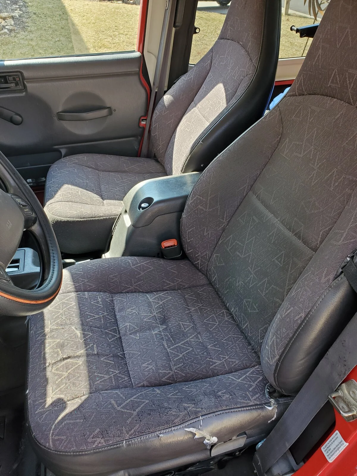

Tan driver seat before cleaning:
Tan driver after:

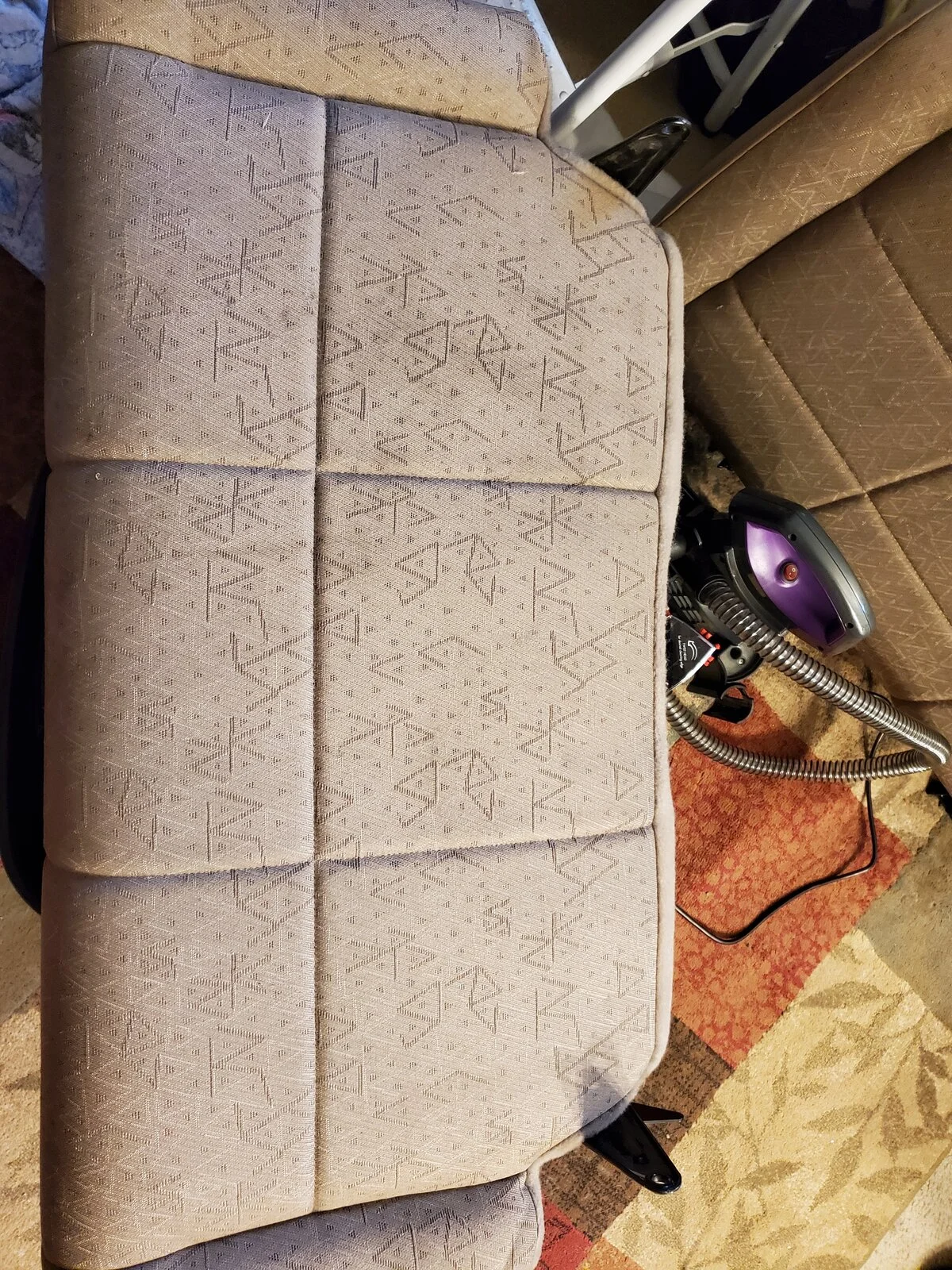

Not much of a change. Just a few problem spots, but this was my test subject. I used a Bissell Little Green Proheat spot cleaner with their Pro Oxy stain solution. Now, on to the real challenges!
Passenger seat before:
Passenger seat after the second cleaning. I hit it a third time for the faint spots towards the front:

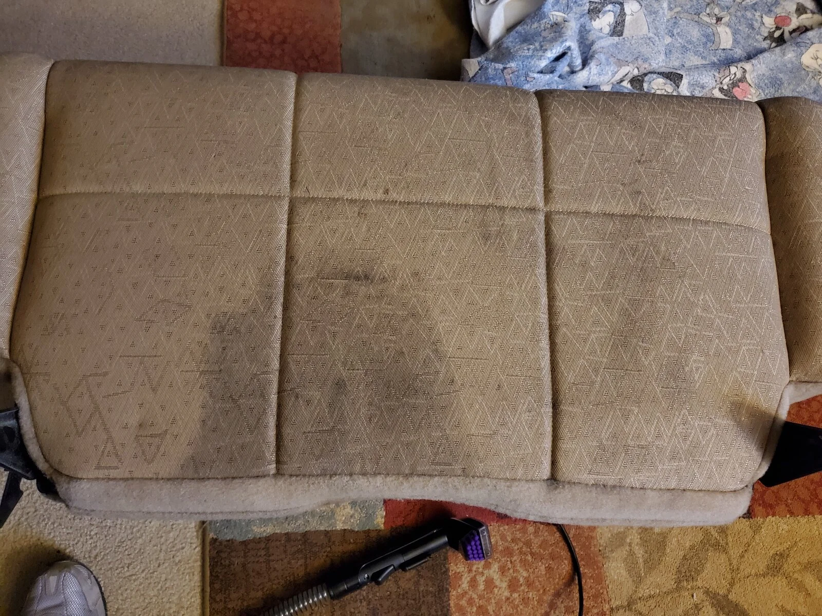

I was in Heaven!!!! And already thinking I was money ahead. But the back seat would be the Everest of jobs.
Before:
After the first cleaning (notice the big dark stain):
After the second cleaning:
After the 3rd cleaning:

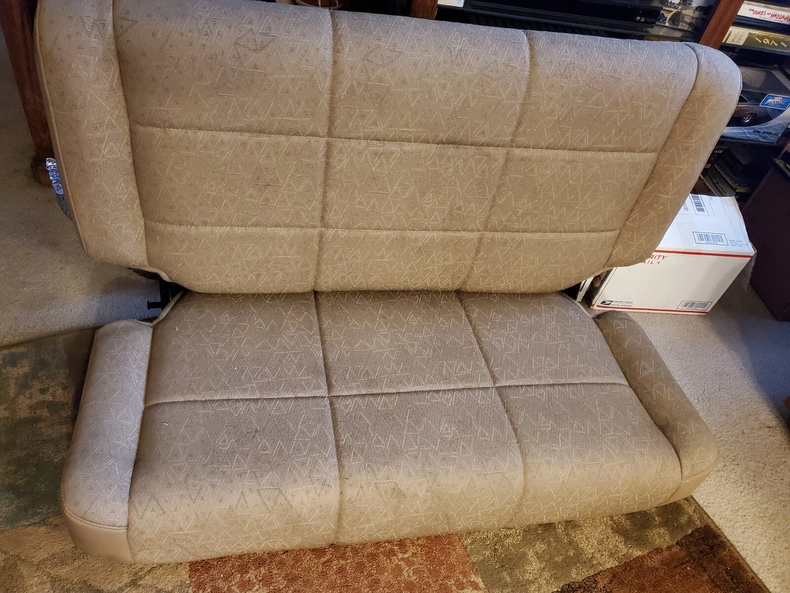

Before:
After:

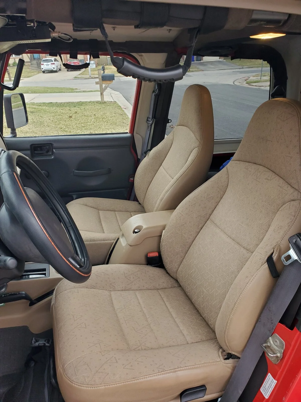

I had no idea they would clean up this well. I had hoped that they would clean up some, even dreamed they might be presentable. But these seats....those seats.....OMG, they turned out well! I'm sitting up higher again. The donor TJ only had 100K on the clock, so they weren't used/abused like mine had been. The paint on the dash, yes, a little fragile. But the SEM from my reading isn't perfect either. And for $5 a can, I'm happy with the Krylon for now. As far as the cleaning, I had to pick a spot or small area, and go over it maybe 15 times, spray solution, suck it up, spray solution suck it up, spray, spray, suck it up. Back and forth, back and forth. Let it dry overnight to really see how it did. Then do it again. And again. Probably have 10 hours in just cleaning the seats. Worth it though. Still can't believe it turned out this well. A little doctoring to do on the long defrost panel, and I've put the vents back in, but I'm happy with the results. Real happy!

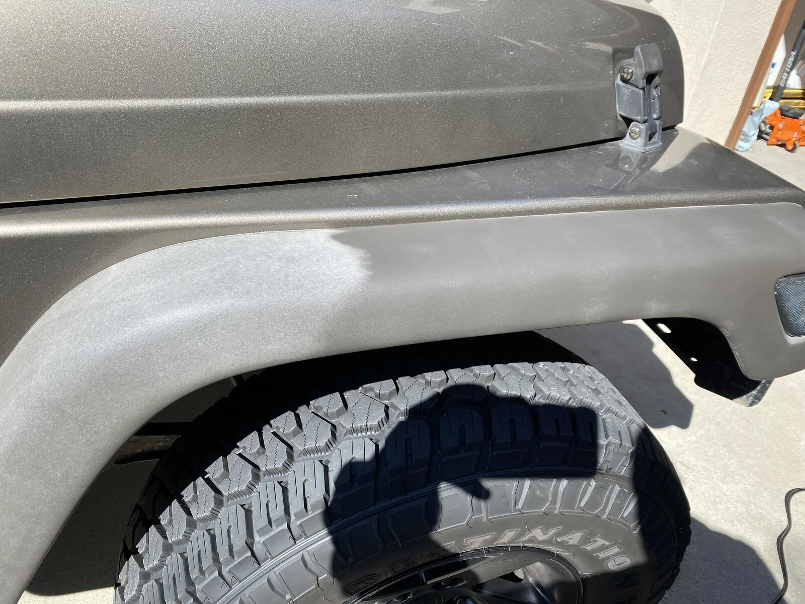

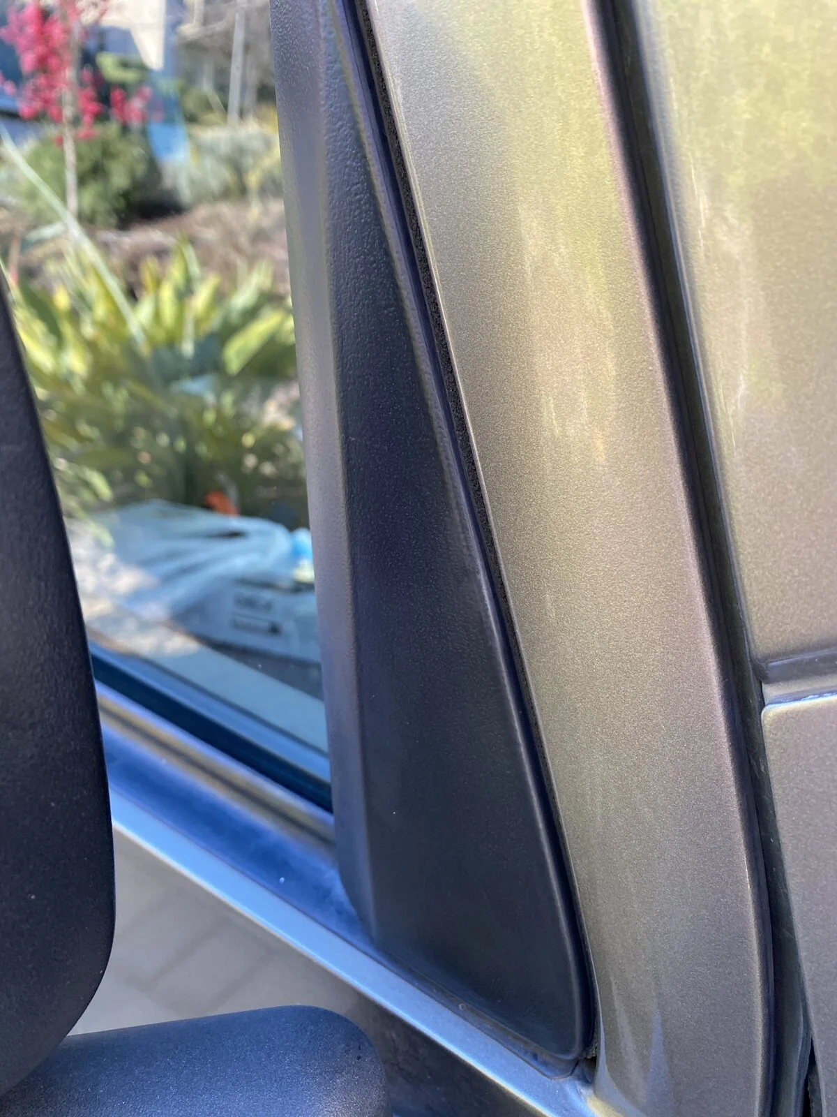

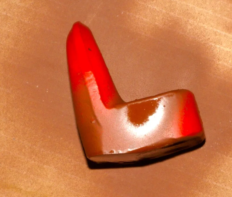

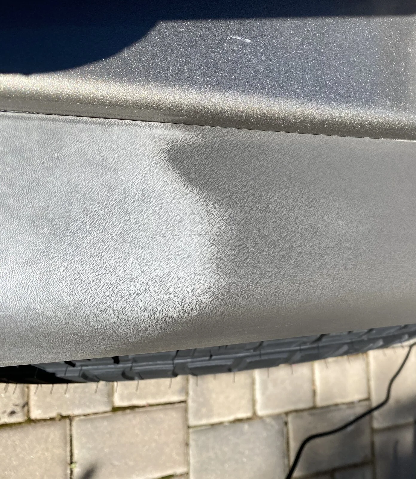

Fender flares treated with a heat gun (1300 degrees) to restore color (pics attached). It works on that little plastic corner triangle at the front of your door windows, too.

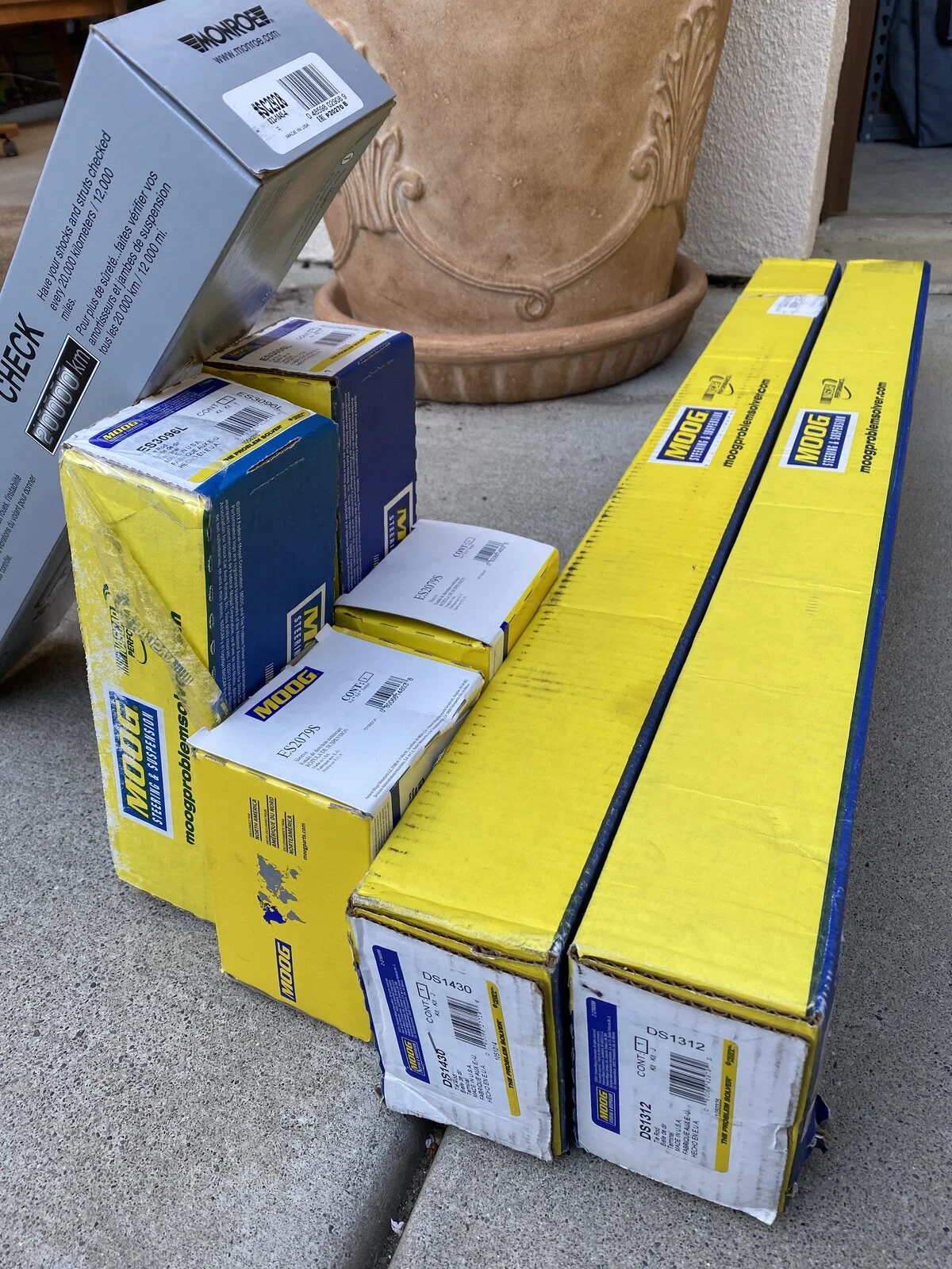

Replaced drag link, steering dampener (Monroe SC2928)
Upgraded to ZJ tie rod. Looks great, much stronger than stock. I bought it from O’Reilly’s - it’s the Moog brand and I paid way too much but I wanted to get it done right away and it was already painted for me so I rationalized it.
I replaced all related connectors, tie rod ends, and added Lucas Red n Tacky grease to all the zerks.
I set the toe in per the method recommended by Stu, seemed alright but I took it straight to an alignment shop this morning so I will see how close I made it. I also stopped by Lowe’s for some square tubing so that later I can do it using Blaine’s method that was posted by Jerry.

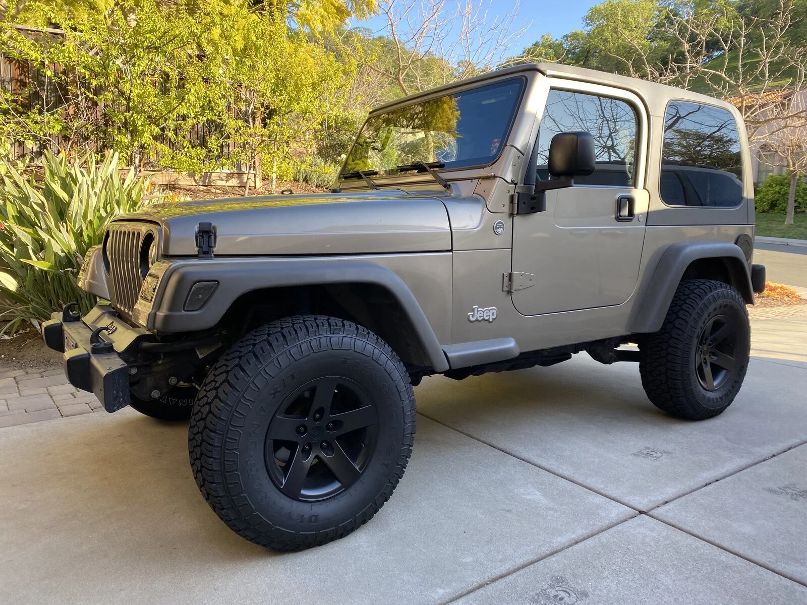

Here’s before on the fender flares:
In progress
After
(Not 100% fair comparison because before is in the sun and after is in the shade)
here’s that corner piece (don’t have a before but it was very faded)
steering parts!
