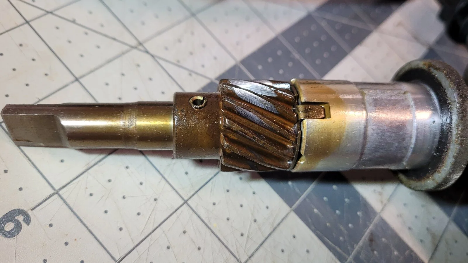

Yesterday I replaced my 05's OEM OPDA (it had an '04 date code inside its housing) with a new Crown unit. I have not had the barrel of monkeys noise that I could recall, so this was preventative maintenance.
I followed the usual steps found in all the tutorials and write-ups, used the original cam sensor, got everything back together, and (holding my breath) the Jeep started up and ran until normal operating temperature with no codes. I didn't have a chance to test drive it last night. I should be able to do this today. I will say, I don't think I have any valve/lifter tick now. It was always minimal anyway, but my ears couldn't hear any.
As with other projects where I encounter minimal hiccups, I'm skeptical I did everything right. I read horror stories and I didn't (so far) have that type of experience. (The worst of the project was cutting a slot into one of the old OPDA's cover screws because the T25 rounded out due to the angle of getting a tool in there.) I can't be the only one who doubts themselves after doing this stuff, can I?
I found the similar type of wear on my old OPDA everyone else reports; but the cam did not look similarly worn.

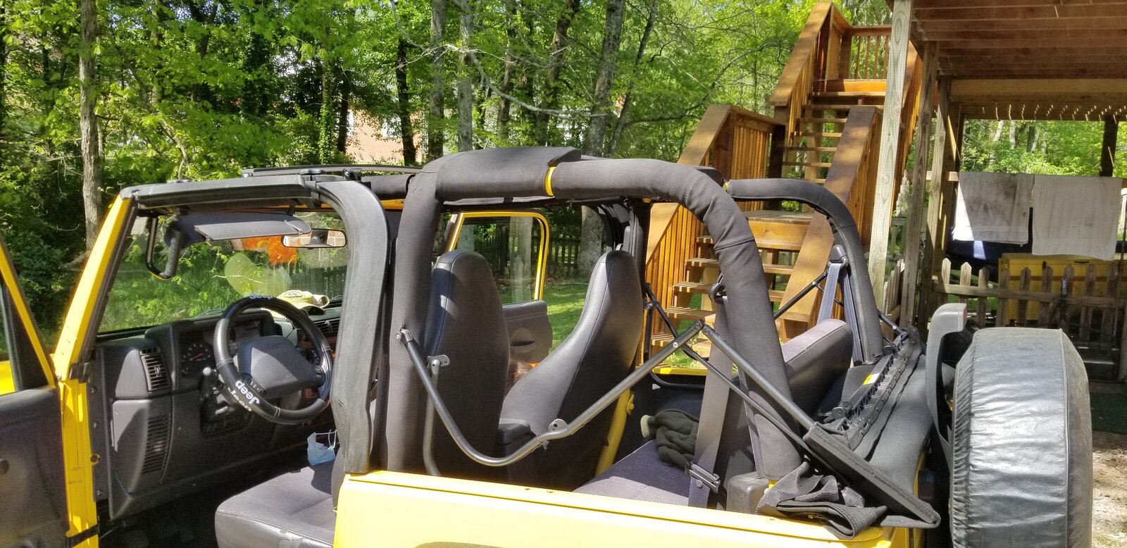

I’m wanting that top. My only concern is I heard the top will get to flapping going down the highway. Have you noticed this?
I’ve had the same top for 2 years and I couldn’t be happier with it. The first thing I noticed when I took it for a drive was how much quieter it was than my OE top. Now...the OE top was pretty dry rotted but it obviously fit perfectly but it was flappy IMO compared to the Trektop NX.
M
Makes sense, I’ve always been torn on which is better if you only had one. I pick up my half doors this week and then maybe I can decide. I have to paint them, but plan on keeping both.
Id keep both if I had the place to store it. Half doors is basically a commitment to a summer only Jeep. Which is fine because I only drive it when there’s no chance of rain and the temperature is greater than 65.
Makes sense. I still ride in the winter when there is no salt down. My garage is filling fast, thankfully it’s a deep garage for my work area, workouts, and storage.
