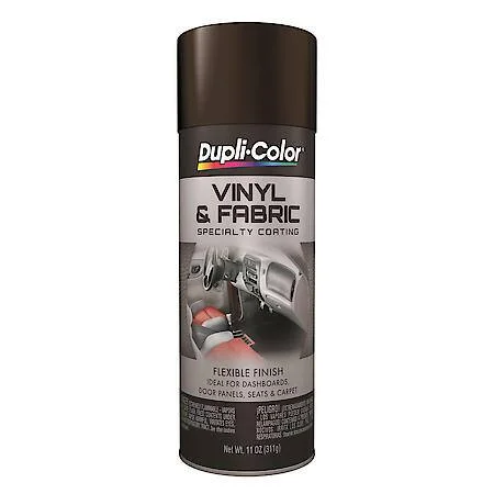

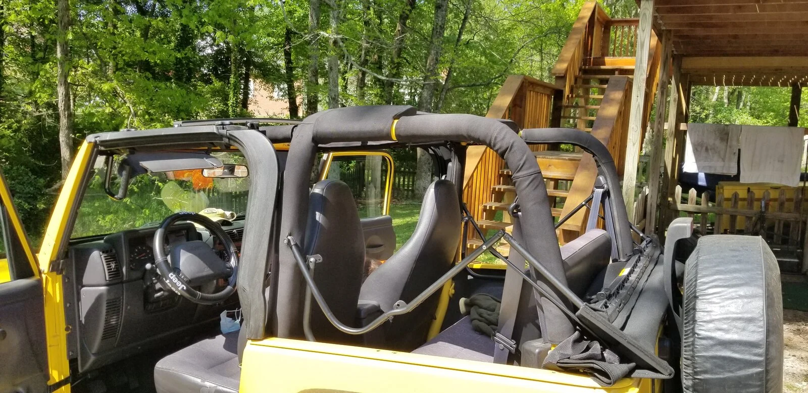

Sure. My roll bar covers and soundbar were faded almost to a purple look from 20 years of sun. Several others on this board have recommended painting them, so I decided I would give it a try.
I removed the covers from all of the roll bars except the ones over the front doors. (These would require a torx wrench with a hole in the middle of it that I don't have.) You have to remove the top anchor point of the seatbelts to get the covers off.
I also removed the sound bar. It is 4 torx screws and a plug, so pretty simple.
I laid them out flat on plastic drop cloth's in my driveway and painted them with DupliColor Vinyl and Fabric paint. I let them dry for about 30 minutes and gave them a second coat.
For the bar covers over the front doors, I used the plastic drop cloth to cover everything but the bars, and gave them two coats as well. I put it all back together, and it looks much better than it did. There is a paint smell once I put the top back on, but I'm confident that will go away in a few days.
I purchased the paint at Advance Auto Parts. I had to go back for a second can, so you may want to start with two.
Hope this helps. Let me know if you have more questions.

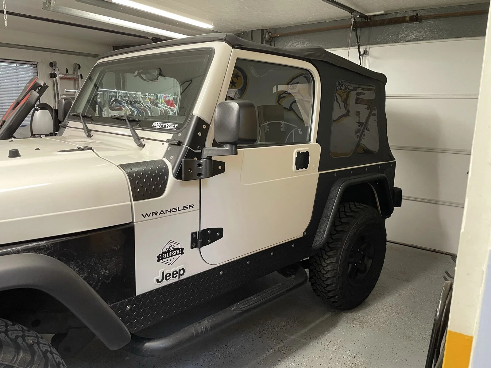

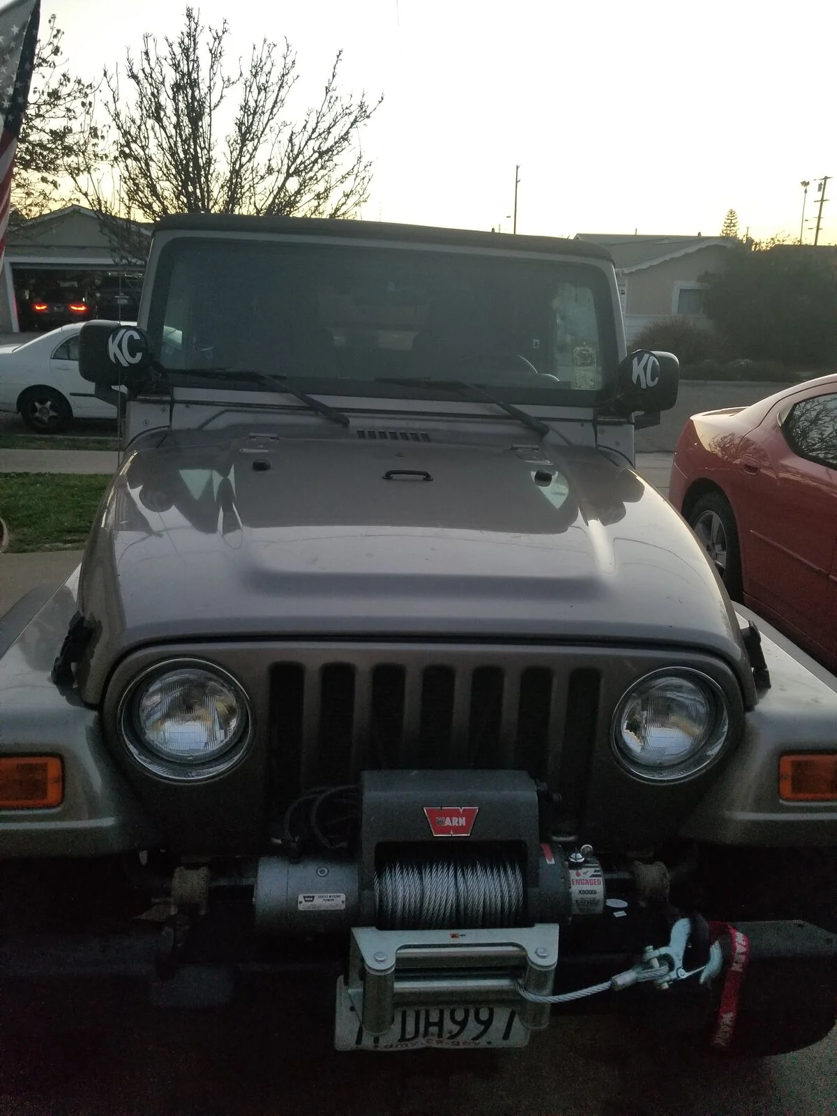

Replaced my soft top today. The sierra offroad one, looks good and was a huge upgrade to my old torn one, couldn’t even see out the windows.

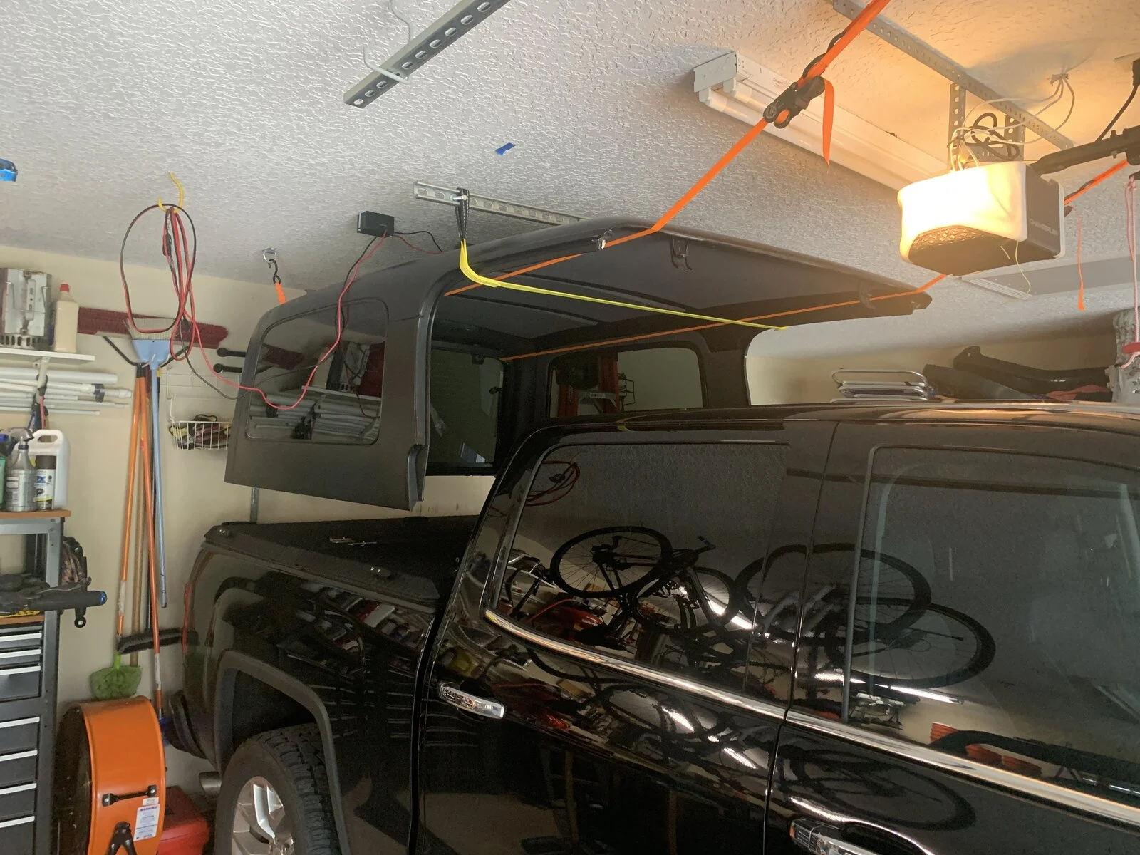

Just manage to get around to cutting the hole in the garage ceiling for the hoist. Was planning on rewiring the controller to the longer cable afterwards but I found out I don't have the right size female quick disconnect terminals on hand. Off to the hardware store tomorrow!

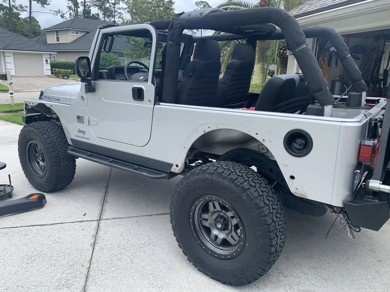

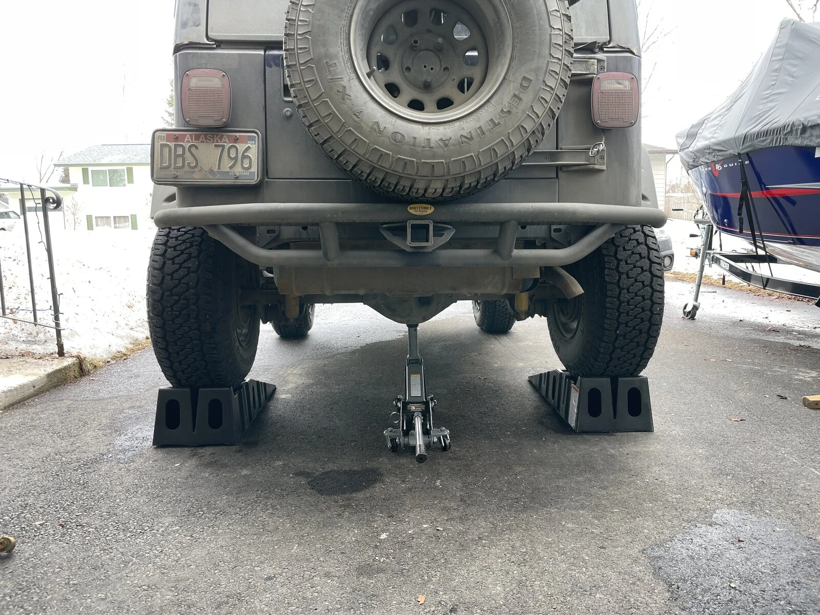

Took the flares off to do some cleaning and rustproofing of the nutserts. Tomorrow or the next day I will lift the body off the frame slightly to get the factory rubicon rocker guards off and do the same thing. With the step/sliders the PO put on the factory rocker guards will not quite slide out and they hit the steps. Lifting the body somewhat should give room. Its going to be raining for a couple of days so I have the right timing figured out.
My truck fits nicely under the hardtop on the new hoist.

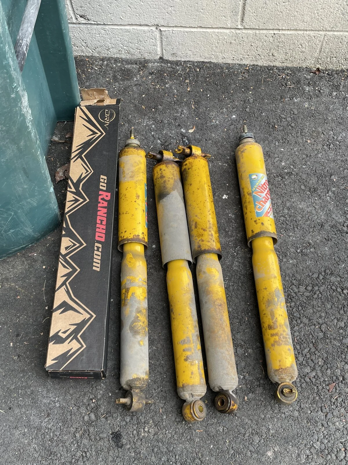

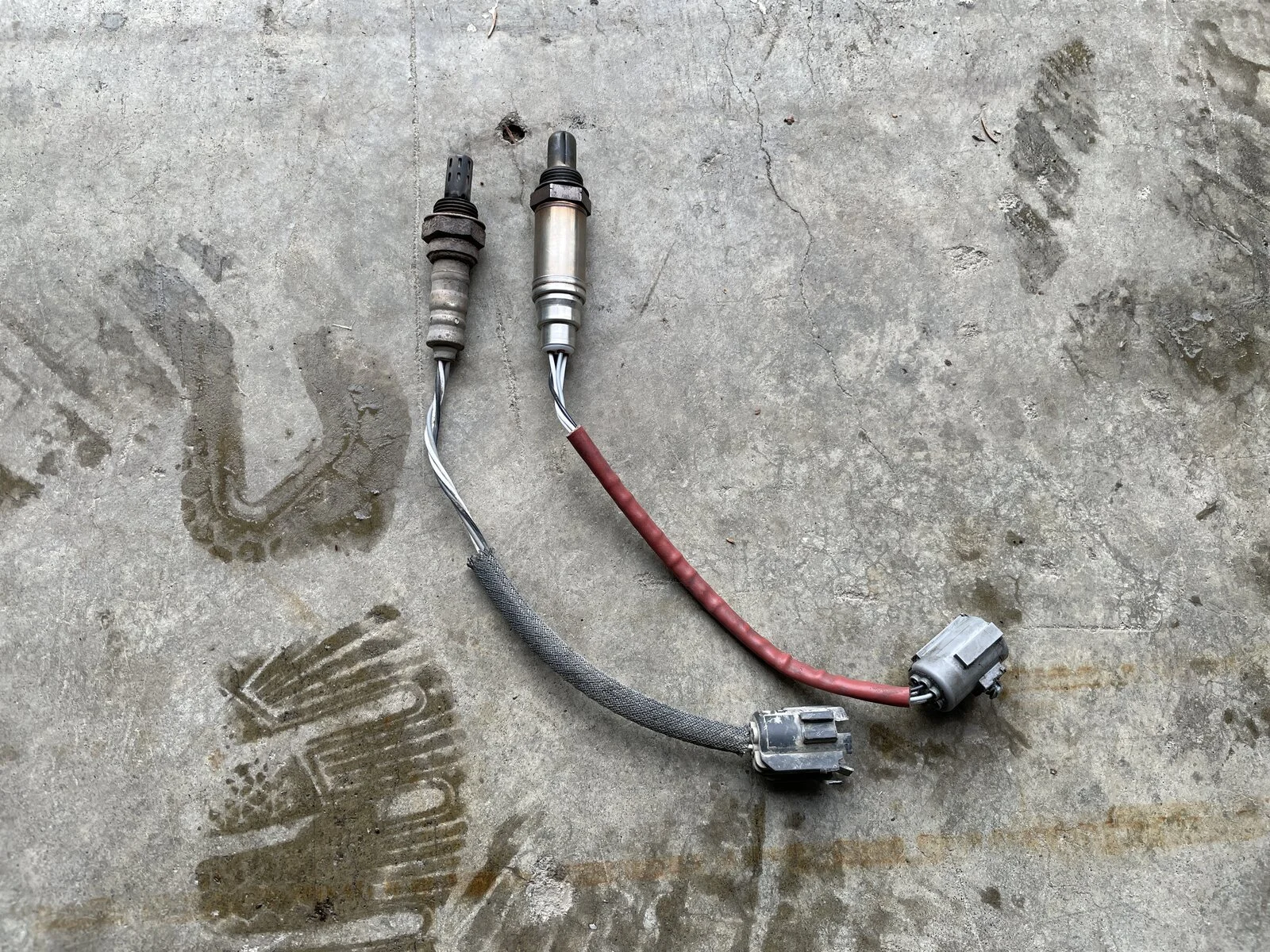

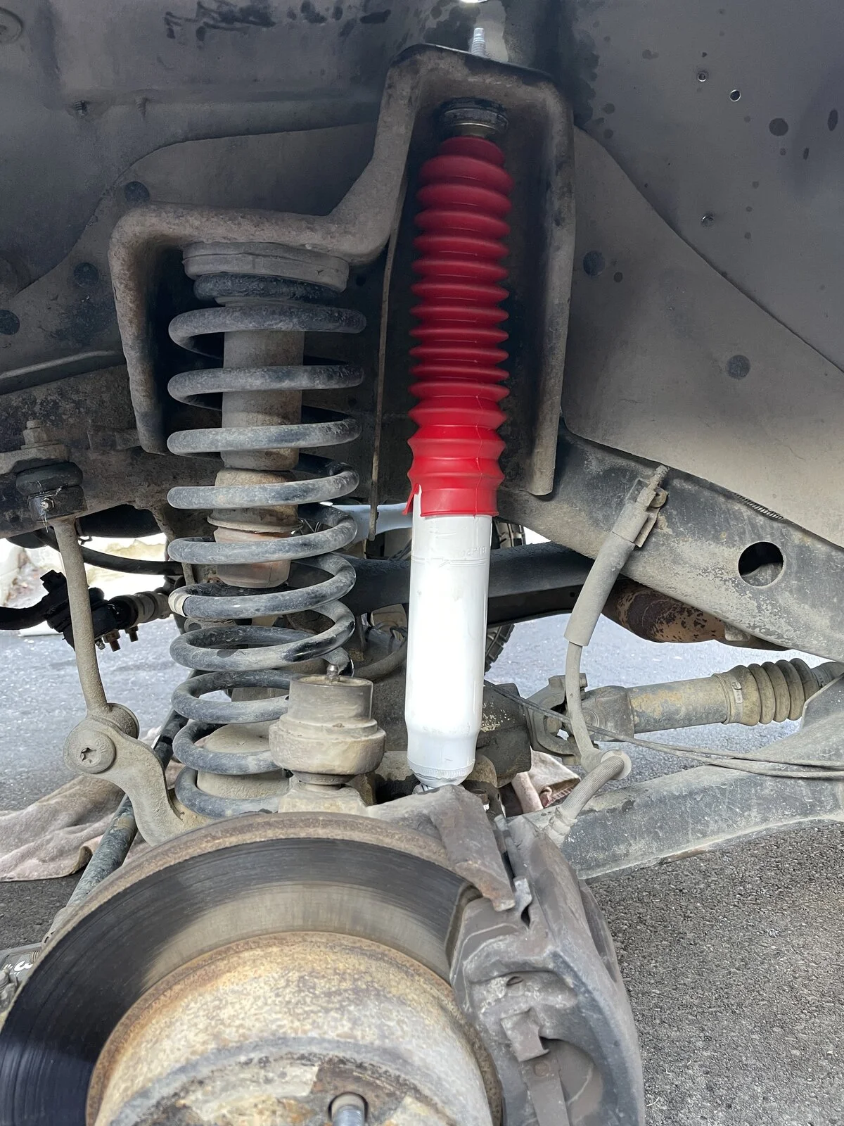

Finished the shocks. Ranchos all around. Also finally got the downstream O2 sensor swapped. Now both are the the correct ones.

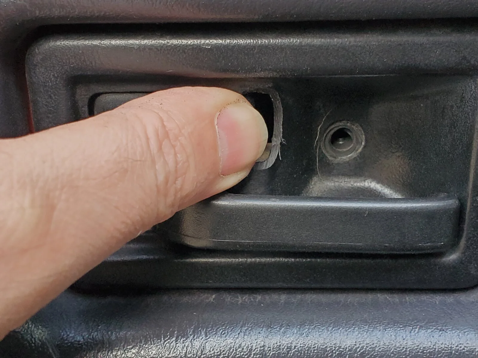

My driver side lock linkage is not as "correct" as the passenger side is. The passenger side pretty much goes click click click whenever you flip the lock lever on the inside forward or backwards. The driver side, I "got working" not long after buying the heap, but it is more mush mush muuush when operating the lock lever. It is functional but has caused me injury 2 or 3 times now. When attempting to lock the door when getting out, I typically use my left thumb and rock the lever forward. Occasionally it takes more effort than it should and my thumb, while rocking and pushing the rocker lever forward and in, jambs the front part of the lever opening up in and under my thumbnail. Yes. It feels just like you just now thought it would feel like. This past week, as that part of the door handle broke the bond between my thumbnail and nail bed, I decided it was time to make a change, at least until the next time I have the door apart and can maybe rectify the real issue. Today, I took a Dremel and a sanding drum and clearanced the plastic away, so my thumb would hopefully never endure that pain again from this particular issue on this Jeep.
