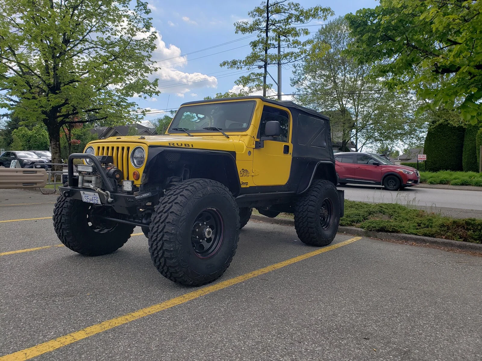

Cleaned er up and took it to the mall! :) My mom laughed when I pulled up in the Jeep to my folks place for Mothers day haha

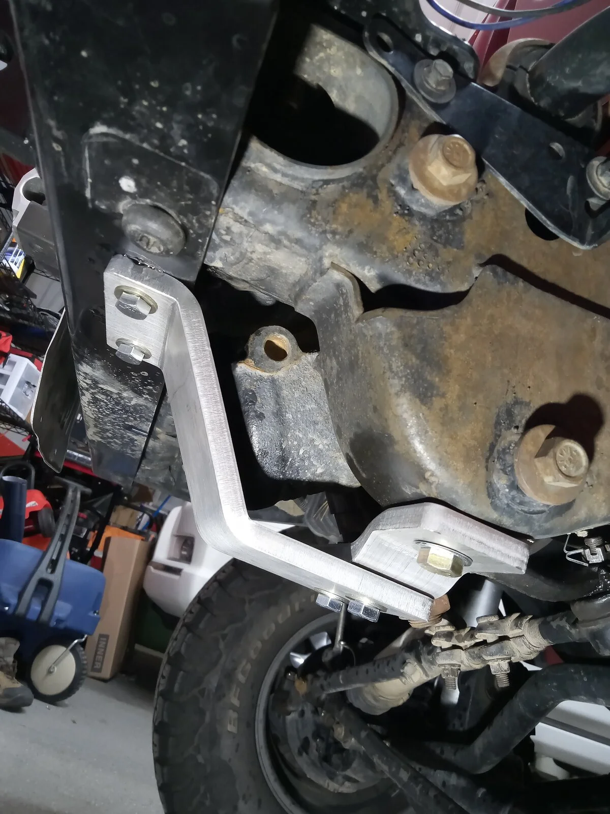

OK I'll bite. What is this?
steering gear skid (savvy)
that.
It's the third one I've had. The first was integral to a heavy old Body Armor bumper that was on my TJ when I bought it. I dropped it on rocks enough times to know that I needed a skid there when I switched to a stubby Warn bumper that didn't have an integral skid.
I ran the Warn for about a year, but when I started looking into an Anti-Rock I discovered that some people have clearance issues with steering skids that use the steering box mounting bolts. The extra thickness of the skid pushes the bolts out just enough that they can touch the sway bar arm. The Savvy skid purposely does not use those bolts so it doesn't create that issue. So when I swapped rigs, I left the Warn skid on the TJ and got this Savvy for the LJ. It's been sitting in my garage for a good 2-3 months while I've been taking care of other aspects of the build. I'm in that phase where the last 10% of the build takes just as long as the first 90% because it's a bunch of little stuff like this.

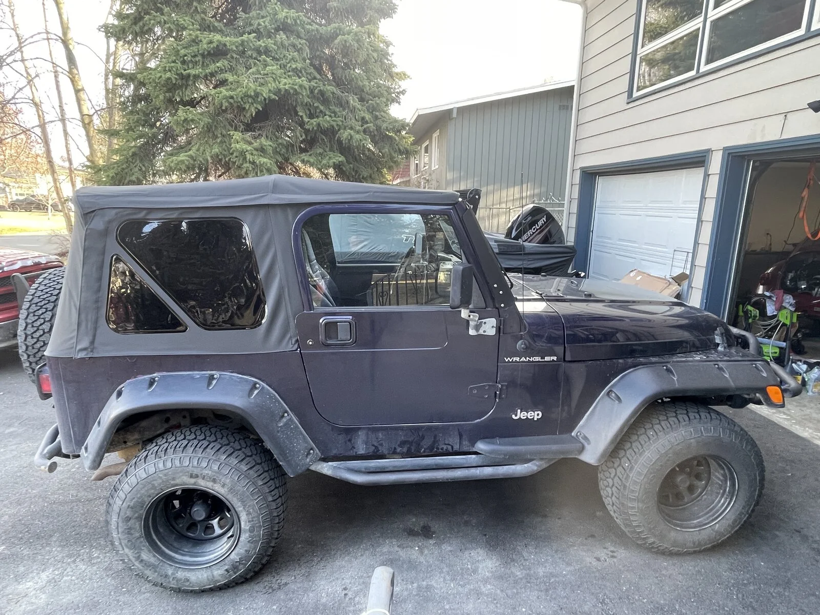

We put a soft top on the teenagers ride. Had to buy complete kit as it had a hard top. The instructions were vague and not well written.
I’m wondering if we did something wrong. I took the rubber gasket off the top of windshield as the bracket doe soft top would not fit properly. Was that wrong? The top seems to fit. Should I put the gasket back on?
The gasket seals out wind and rain, without it I would think it would rattle when you’re driving it.
Reactions: MangoTango
We drove it after and it didn't seem to. I can put it back on, we were just not sure as the front bar didn't seem to sit correctly when it was there.
