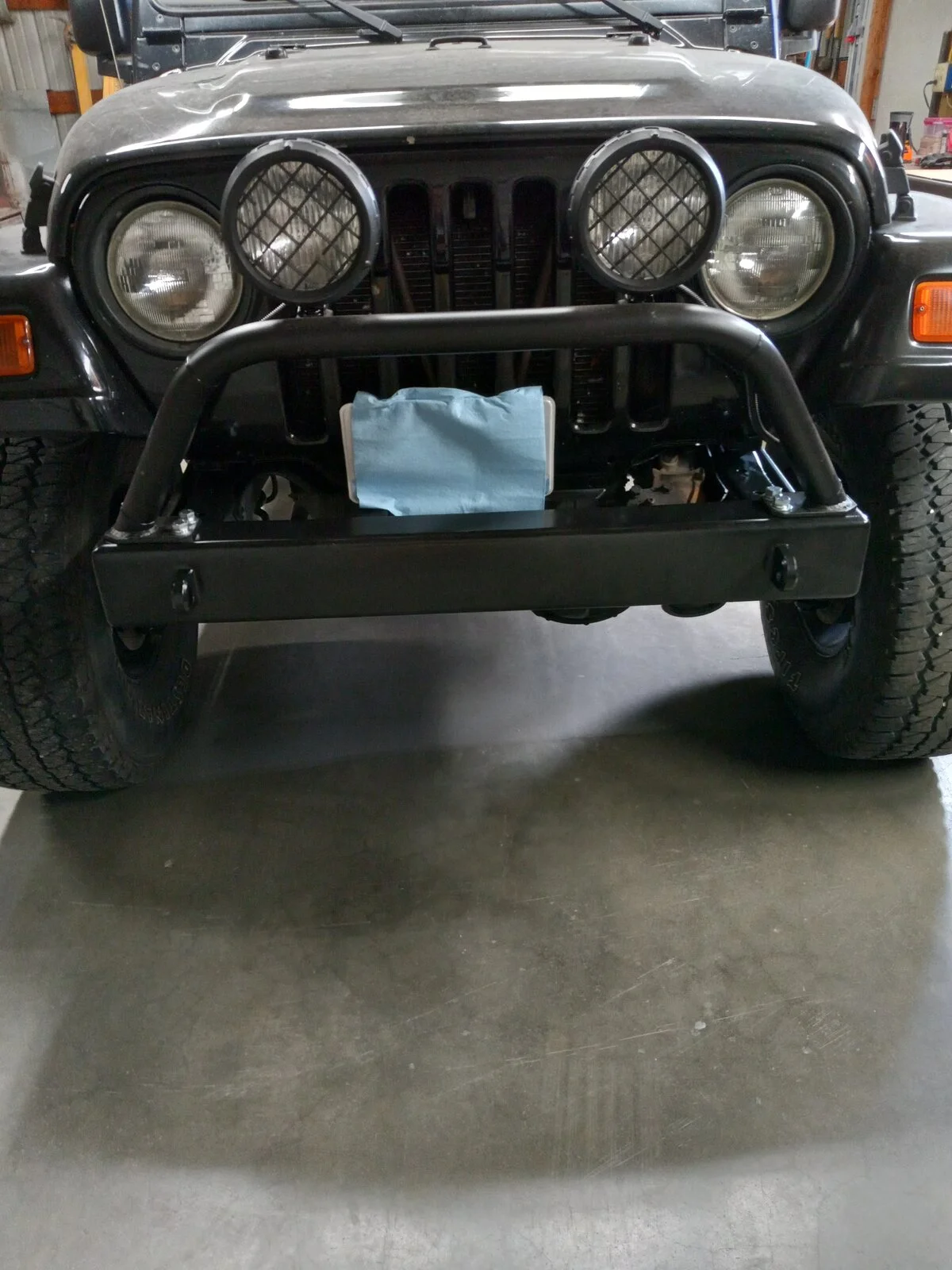

Installed my stubbified front bumper.

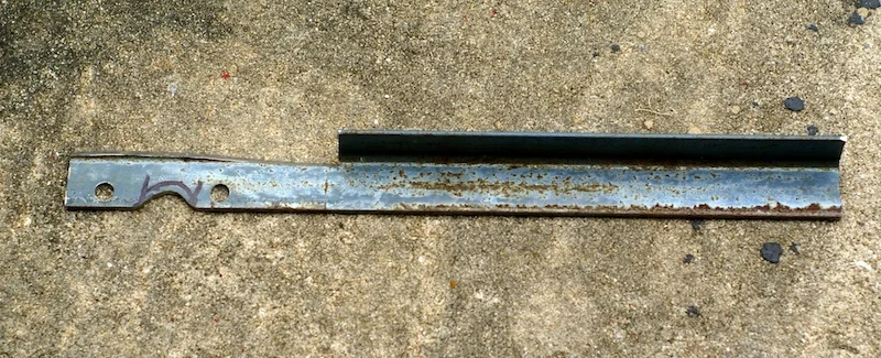

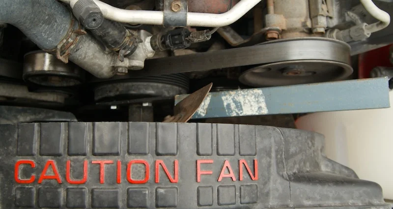

Sometimes the best tools are the ones you make yourself:
The fan was not "stuck", but it was "stuck enough" to where the pulley wouldn't hold still from belt tension. I would have bought a tool like this local, but as is the ever-ongoing problem with brick and mortar; nobody had one. And they're expensive, so rather than order and wait on one, I hacked this one out of some angle I had lying about. Once the tool was made, the fan spun off without any drama whatsoever. In any event, the necessary hoses are off the old WP, the serpentine belt has been partially removed, and only the WP pulley needs to come off before I unbolt the pump itself. WP pulley seems to be stuck on too, but I was out of time for the day so I didn't try very hard to get it off. Had to Henna my hair, which takes 6 hours.
3/8" holes on 2-1/4" centers if anyone's wondering...

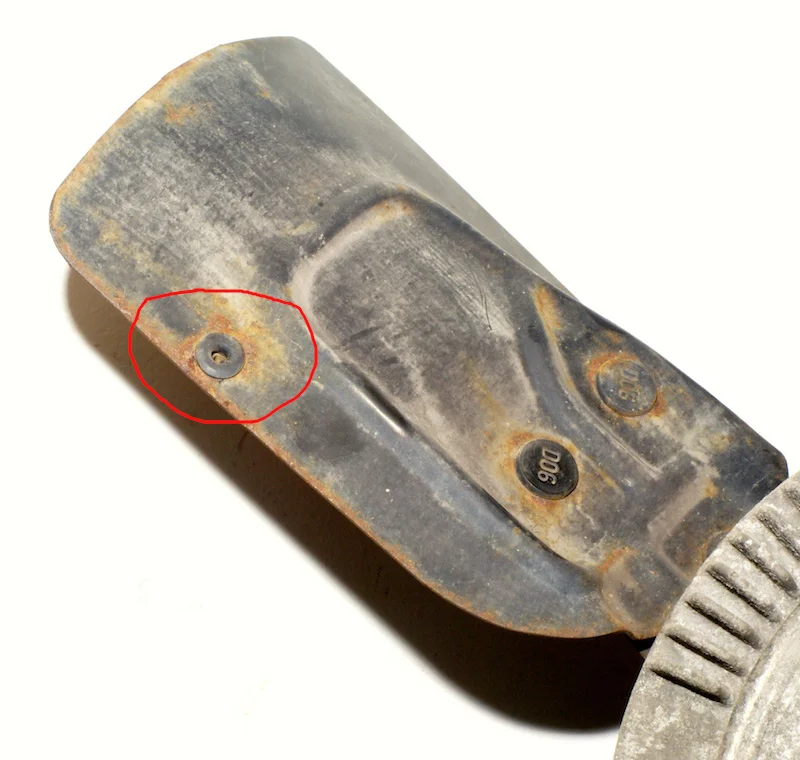

BTW, what's up with this pop rivet in the fan blade?:
Something to do with balancing the fan at the factory, or some PO baloney?
View attachment 274449View attachment 274450
The fan was not "stuck", but it was "stuck enough" to where the pulley wouldn't hold still from belt tension. I would have bought a tool like this local, but as is the ever-ongoing problem with brick and mortar; nobody had one. And they're expensive, so rather than order and wait on one, I hacked this one out of some angle I had lying about. Once the tool was made, the fan spun off without any drama whatsoever. In any event, the necessary hoses are off the old WP, the serpentine belt has been partially removed, and only the WP pulley needs to come off before I unbolt it the pump itself. WP pulley seems to be stuck on too, but I was out of time for the day so I didn't try very hard to get it off. Had to Henna my hair, which takes 6 hours.

I’ve always heard its for balancing.

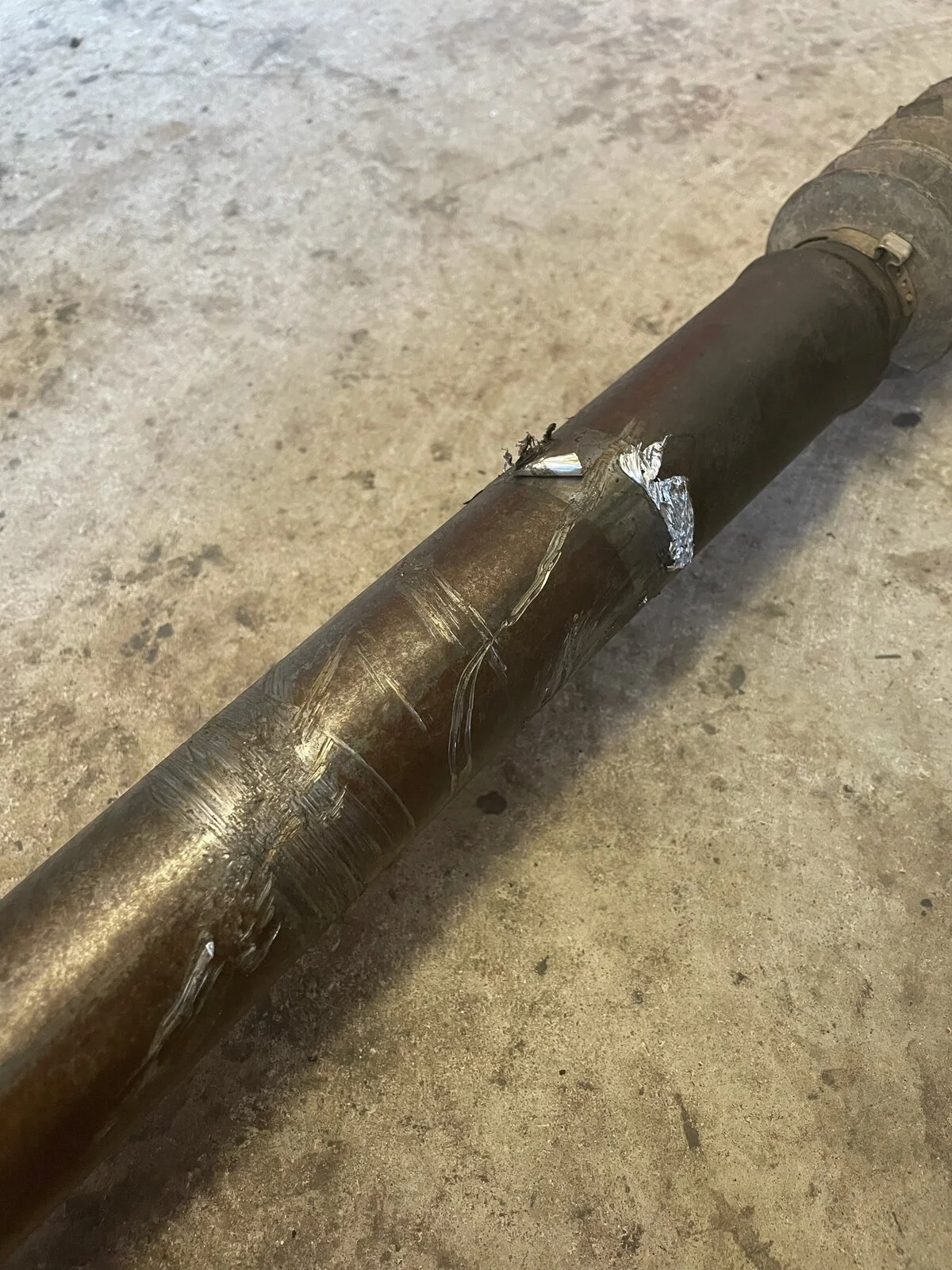

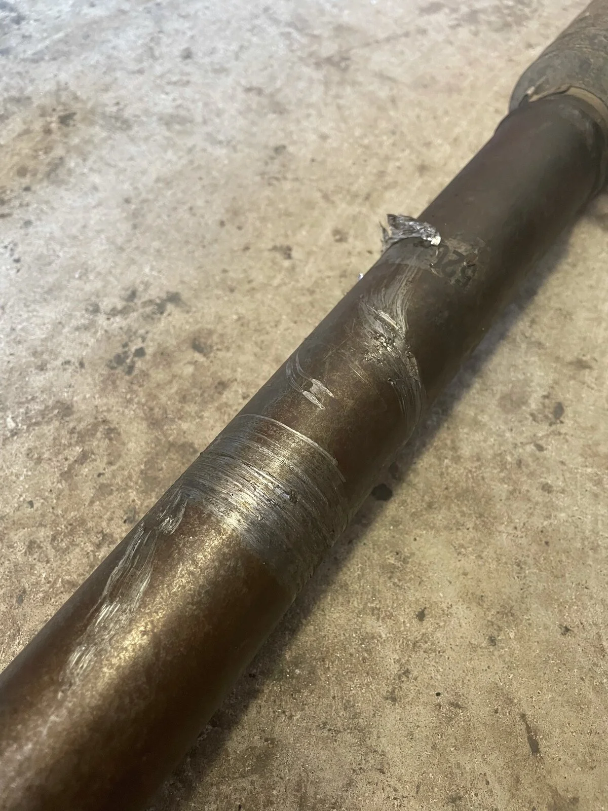

Also pulled the front shaft, which I think may be giving me some rumble up front. Maybe because I spun it on the rocks because it seemed like the thing to do.
