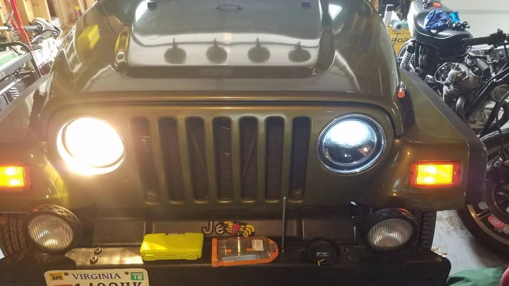

Replaced the headlights with some knockoff led trucklites. Big difference, and only like $120. Love it

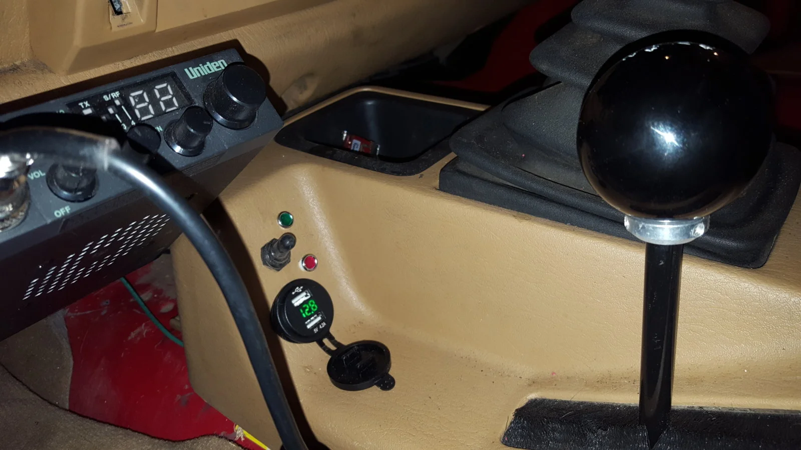

Well I didn't do it today, but I did do it yesterday. I installed and wired in a USB phone charger with a voltmeter installed on my auxiliary battery. It looks weird because I took the picture before I wrestled the carpet back in place.
How hard is that to do? ... (get it working I mean) I find electrics difficult so anything more than plugging in an extension cord worries me haha
It was really easy. There are only two connectors on the back. Positive and negative. I have mine wired to a stock after-market switch on the dash because as long as it has power the volt meter is on and I wanted a way to turn it off when I am way from the vehicle but I also wanted it to be able to function while the key is off but I am still around the vehicle like say if I am camping or sitting around a camp fire and I want to charge my ipad.
You could hook it up to key power or battery power, but mine is hooked up through a fuse to a switch to the USB charger. So that way as long as my switch is on I have power and I can always see what my second battery voltage is. This will be good when I get my winch installed. I would be more than happy to help you if you wanted this too.
Basically I have a power wire running from the battery to a switch. then a power wire coming from the switch to the power on the USB charger, then the charger is grounded. That is it. If you don't want to run from your battery you can run it from your key power so it is on when your vehicle is running. Not my choice, or you can run it from your fuse box since you don't have two batteries yet and just have power on all of the time but run it through a switch to turn it off.
BTW, the switch above in the picture is the dual battery isolator switch nothing to do with the USB in the picture.

It was really easy. There are only two connectors on the back. Positive and negative. I have mine wired to a stock aftermarket switch on the dash because as long as it has power the volt meter is one and I wanted a way to turn it off when I am way from the vehicle but I also wanted it to be able to function while the key is off but I am still around the vehicle like say if I am camping or sitting around a camp fire and I want to charge my ipad.
You could hook it up to key power or battery power, but mine is hooked up through a fuse to a switch to the usb charger. So that way as long as my switch is on I have power and I can always see what my second battery voltage is. This will be good when I get my winch installed. I would be more than happy to help you if you wanted this too.
Bascially I have a power wire running from the battery to a switch. then a power wire coming from the switch to the power on the usb charger, then the charger is grounded. That is it. If you don't want to run from your battery you can run it from your key power so it is on when your vehicle is running. Not my choice, or you can run it from your fuse box since you don't have two batteries yet and just have power on all of the time but run it through a switch to turn it off.
clear as mud?
Cool thanks for that...seems easy enough :confused: haha seriously though, I like the idea of being able to switch it on and off without the ignition being on.

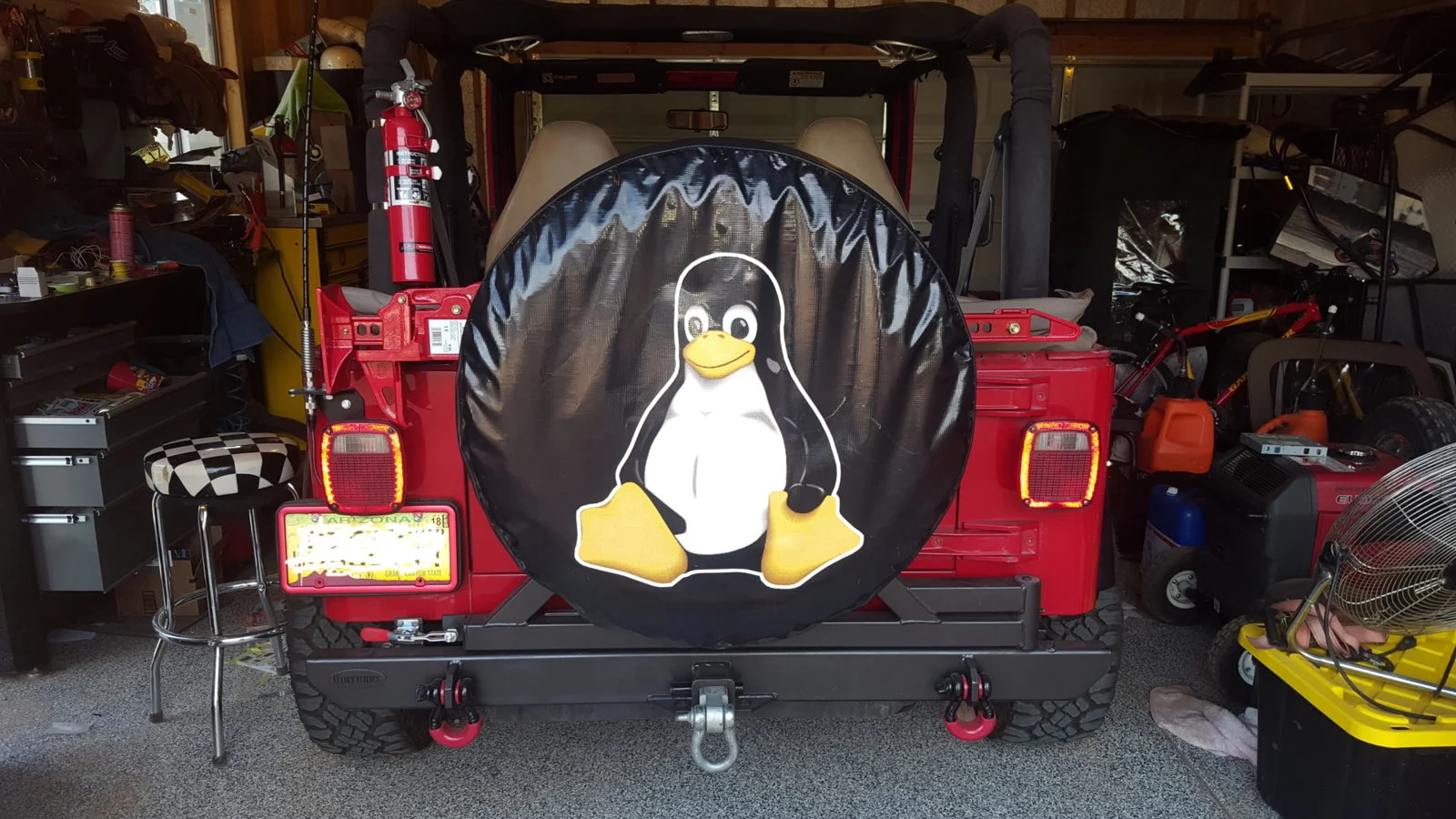

It is. The penguin, not so much.:)
Can you tell me what you did with the d-rings? I like the spacers you used, and would like to do that, only not red, you know...
While we are on the subject....Penguin???? (Do you like fish, maybe ?) ;)

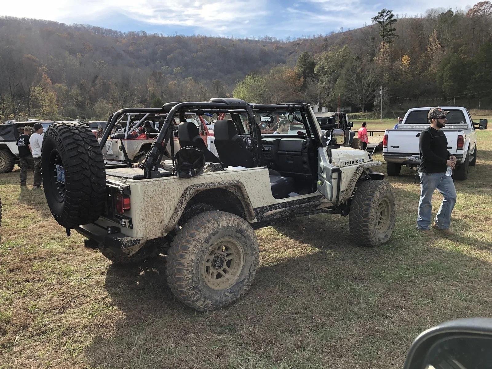

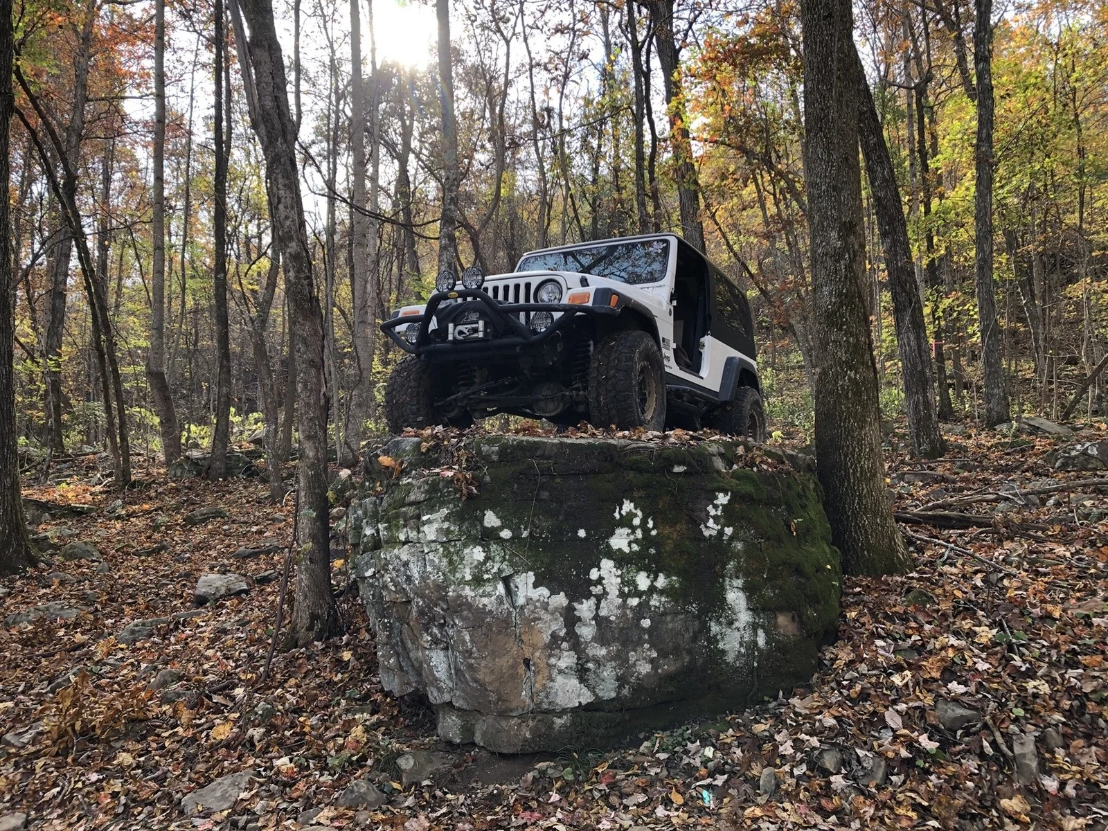

Had fun in the LJ yesterday at Adventure Off-road Park.. beat the crap out of my gas tank skid and pushed my jeep a lot further than I have in the past without breaking anything.
Let my wife drive down the mountain [emoji51]
This LJ was up from the Miami area.. had a 5.3 Vortec under the hood.... I can’t picture a better looking jeep imo.
