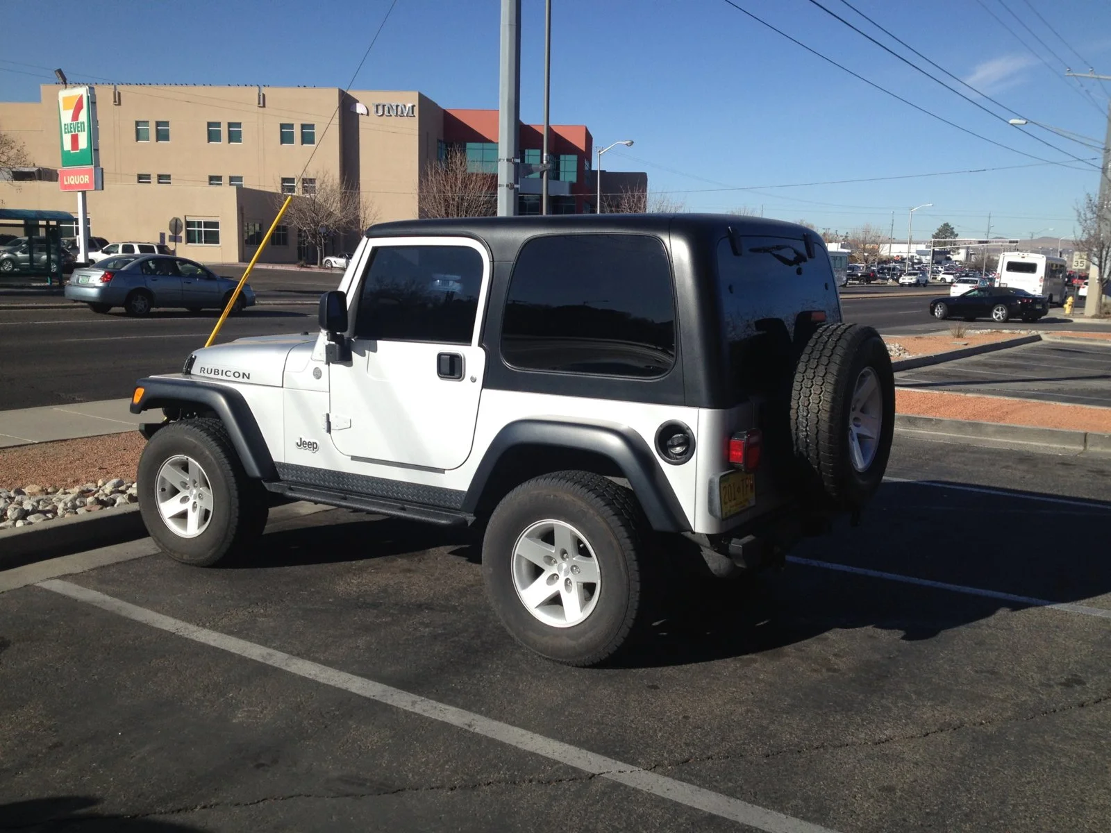

I do run those exact springs. I agonized over which to buy for a couple of months, due to the fact that at the time I had no aftermarket additions, with the exception of the Body Armor rails. I couldn't justify getting the HD springs, I thought they would be too much for my Jeep. In the end I went LD, and even with my Dirtworx front and rear bumpers (which I added months after I put on the OME, and the measurements after mounting bumpers did not vary from before), and the hardtop, running 265/75-16 tires, the height is fine. I did add 3/4" spring spacers, however, for that much more lift. Wasn't necessary, I just wanted to. Here's a photo I took last week:
It doesn't look spectacular, like a lot of the TJs on here, but it rides and looks just as I wanted/needed. The only thing that would improve on what I have is some better tires, but load range C tires in a 16" wheel size are hard to come by. Duratracs are one...
Also, I have no drive line issues, ie. vibrations, of any sort with this setup. There's a very slight perception of harmonic issues around 55 mph, but that is attributed to the larger tires with the automatic transmission/engine rpm, which would most likely be solved with an axle re-gear. Stupid overdrive ratio...

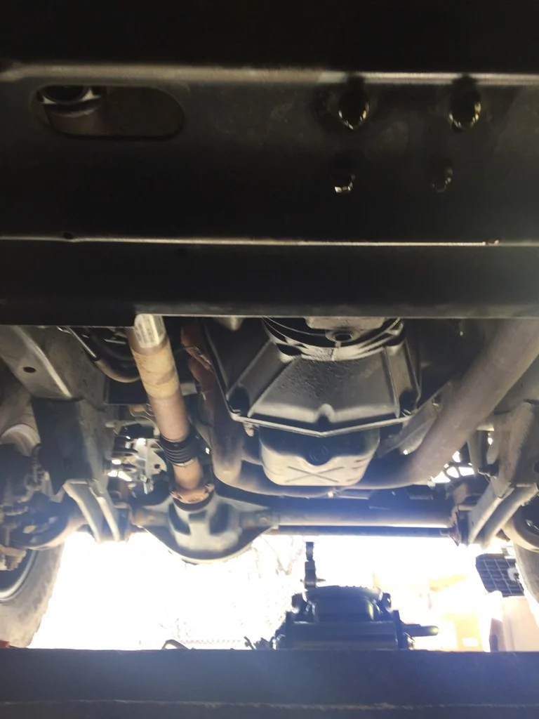

Not that it matters now, I run the HD in front and the LD in the rear on my Jeep. I have the extra set of HD's because I originally bought the HD kit, but since I have no weight in the rear it lifted it almost 4 inches in the rear. I had to drop the transfer case it was kind of a mess in my case. I had to take out the rear spacers and put light duty springs to get it closer to level. I ended being able to remove the transfer case drop in the end. Honestly it gave me over a 2inch rake.
That said nobody else had the same issues I have so I am curious to see how yours turns out please keep us posted with pics?
