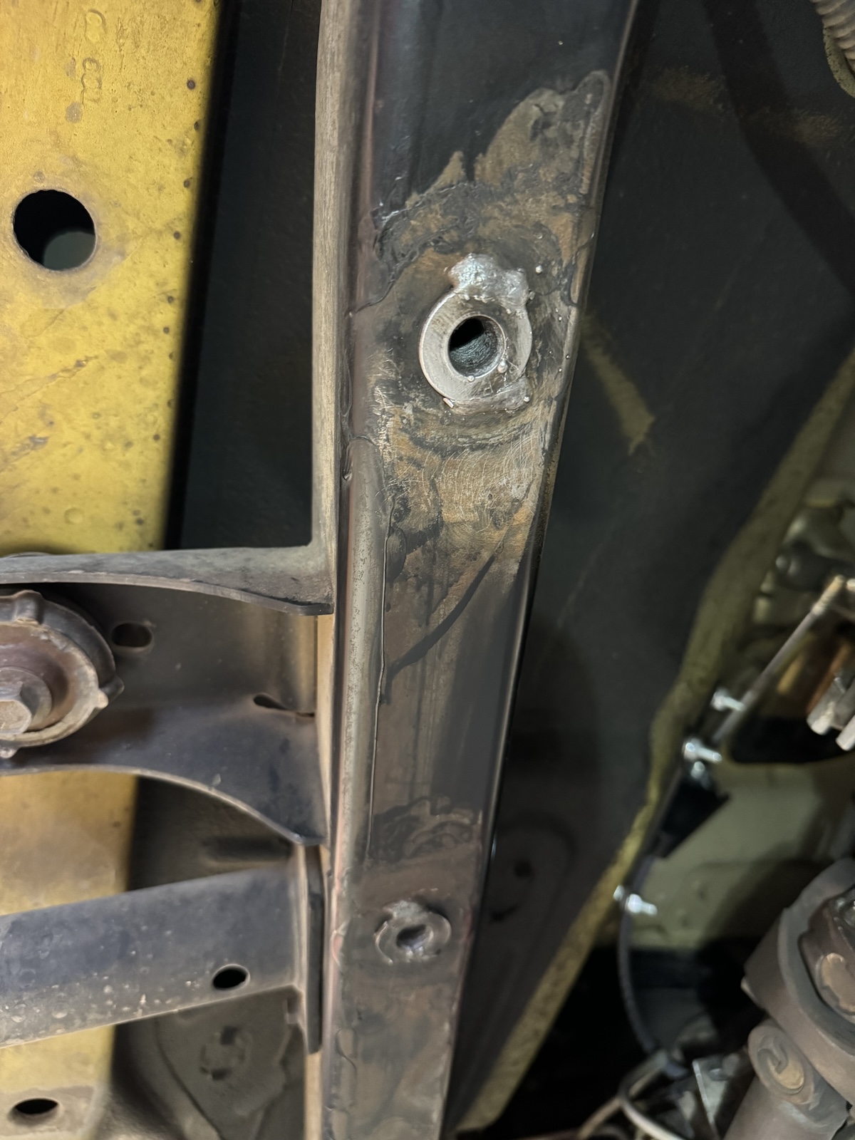

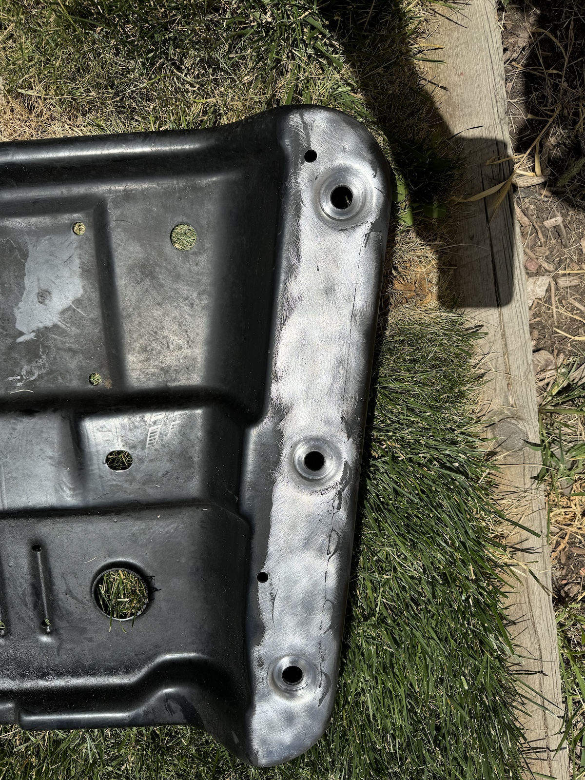

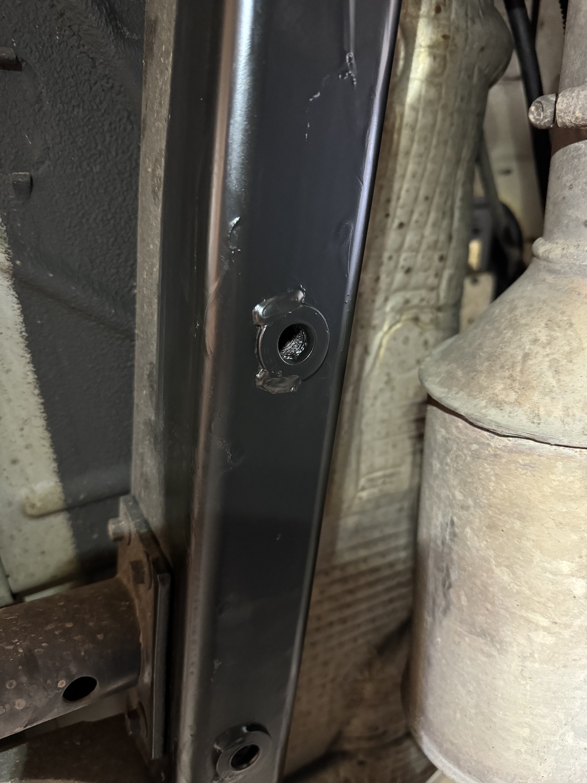

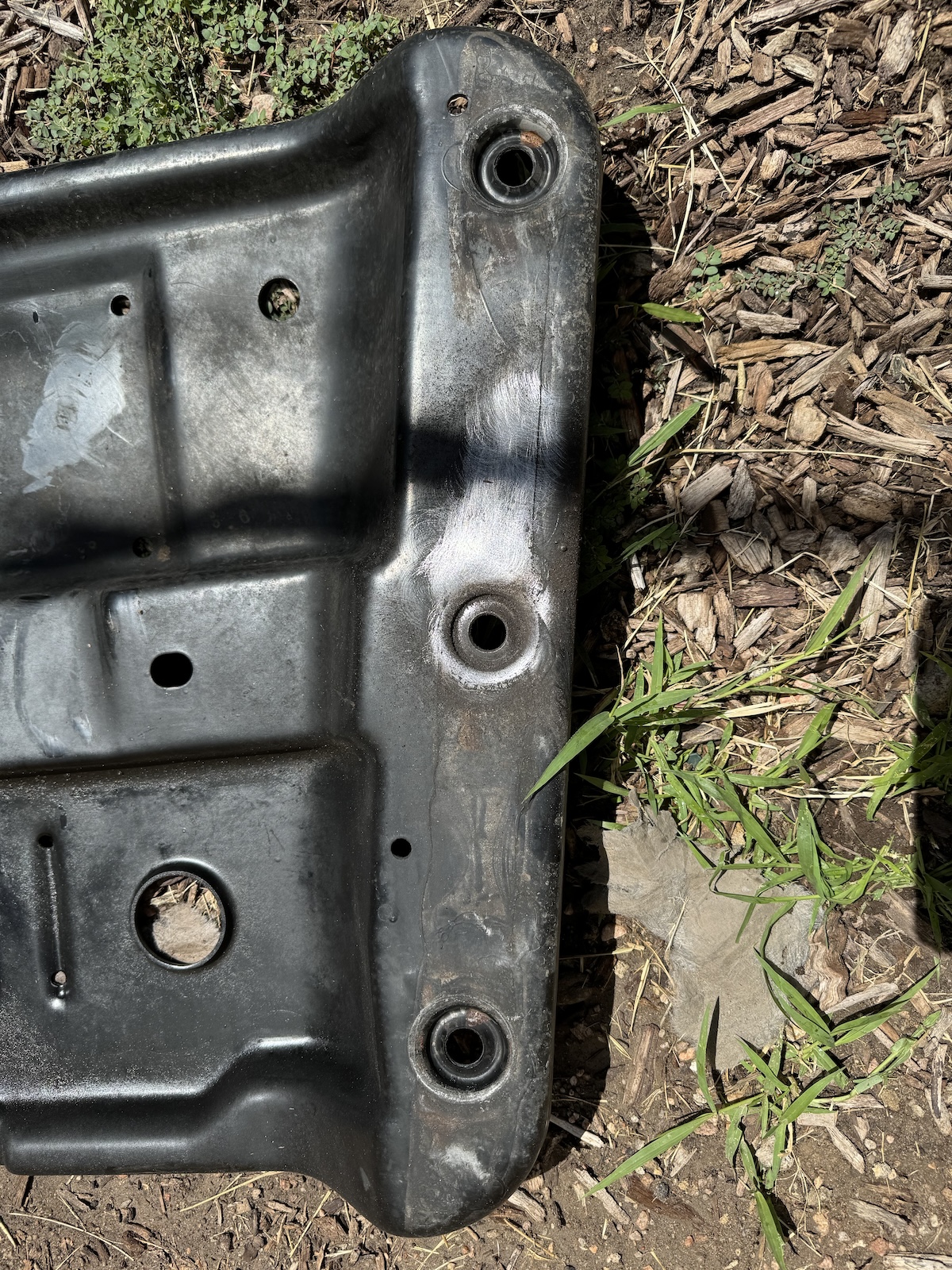

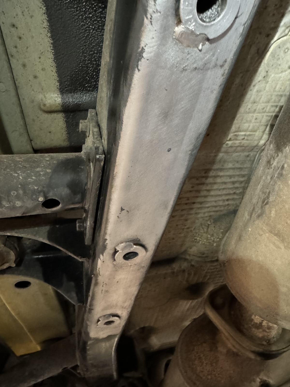

I finished up the rust mitigation for the frame & skid plate and got it all put back together. I'm really bad at taking before pictures once I start a project. The pics for the before sections are either a) the not bad side and/or b) I have already started removing some of the rust and paint. The driver side wasn't that bad, but the passenger side had way more rust. Overall, this rust wasn't that bad, but it was a new project that I wanted to learn how to do, I had the time available, and I wanted to take care of it before it got worse.
I used a drill with a steel wire brush to strip the paint and rust off. Then, I used a coat of rusty metal primer that was recommended to me by Zorba. Then, I did 2 top coats of SEM bumper paint because I had it handy and it is black.
It is too late now, but should I have done anything differently?
That's about what i did when I had mine off recently. I try to clean up and spray a little paint on each area I work on when under my jeep, it just makes me feel good to chip away at rust prevention since I live in the rust belt. Gonna try to do more before winter, including wool wax in the inside of the frame. Anything is better than nothing! 😉

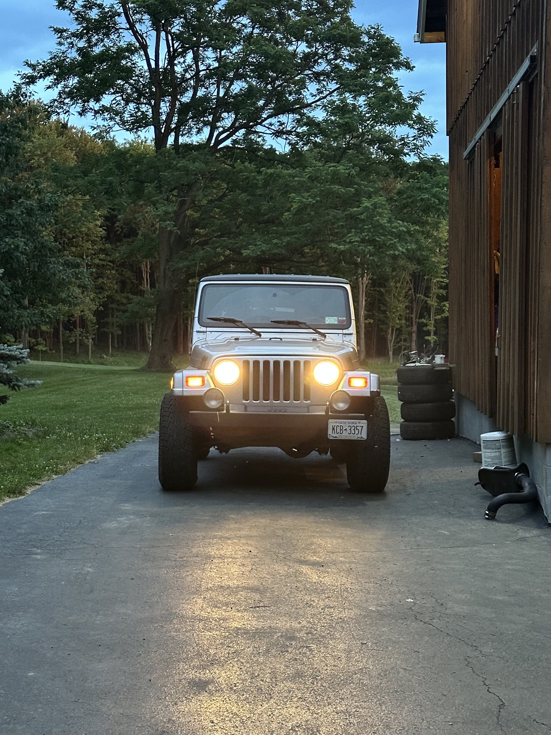

Also swapped back to the stock air intake and got around to putting in the hella 100/80W bulbs for the Toyota headlight conversion kit I installed last month.
How do you like the Hellas? I did the Toyota conversion, but am still using the bulbs that came with the kit. Is there enough of a difference to justify the Hella bulbs?

From what I could tell they look way brighter in my driveway, but I haven’t had a chance to drive at night with them yet. The wattage is almost doubled from the stock ones and the bulbs aren’t expensive.
Hella H4 100/80W
